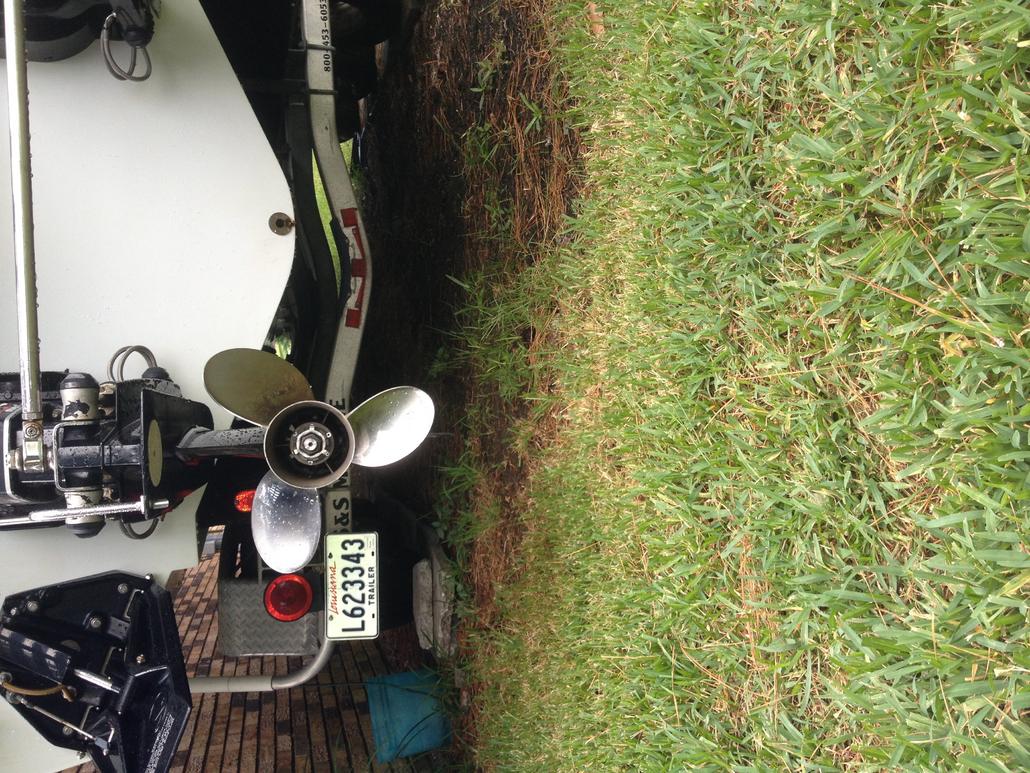

[ATTACH=CONFIG]506434[/ATTACH][ATTACH=CONFIG]506435[/ATTACH]So I took a pic of the hull as it relates to prop spinning IN.
Looks like its getting a changing direction of water flow as you gain speed.
Makes sense! Expecting 70% chance tmrrw b/c of that crap in gulf.. So test maybe delayed!
Crap! Damn iOS sideways again.. :-(
