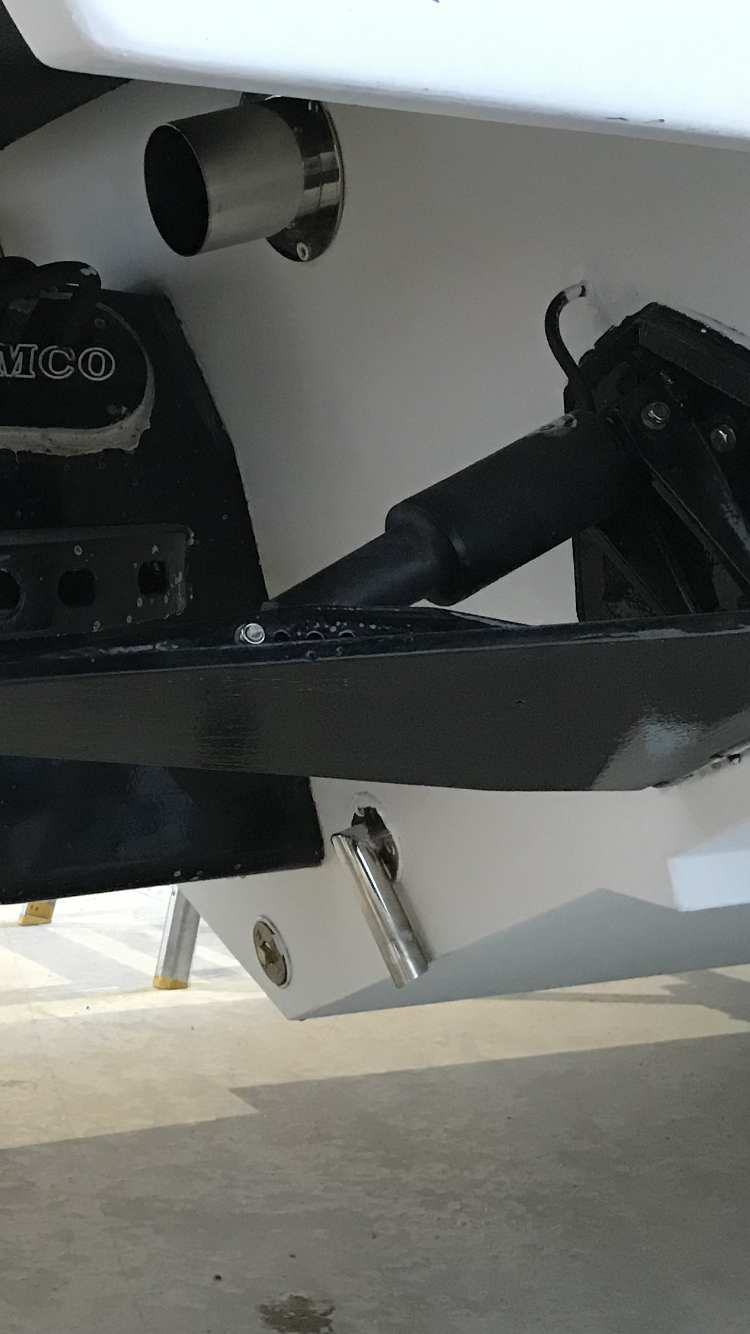

Water pickup breaks the water surface and lets air to the prop causing propeller to slip. Hard to tell from the picture, but it looks that the location aint the best one. Listen to Griff.
Yes, if I look at the water pickup location at the picture, it feels like it can be the cause of the prop slip.
But there is some people that say it has no effect at all.
One guy running his boat in 80mph with the water pickup on the ”wrong” side like mine.
But he has no problem with the prop slip, as far as he know..
maybe mine is standing out more than it should.. One guy told me it should point down just 0,5-1cm from the bottom
maybe I can cut it off a little bit..? If it points down more than 0,5-1 cm

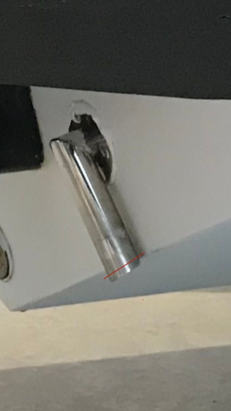

I dont know if the water pickup should point down nothing at all at the ”inner” section.
Or if it should go even with the bottom of the transom and then a little angle..
If you know what I mean. Cut it off like this:
This guy told me to put it on the left side instead.
And his pickup is higher mounted than mine:

It looks like its carrying the bow not bad, I think Griff is right on, the six blade will lift the stern and not be a true test, and try removing the water pickup. As far as trimming the pickup, Teague Marine web page has installation instructions, it shows the leading edge flush with the bottom and the trailing edge 1/2" (127mm) down

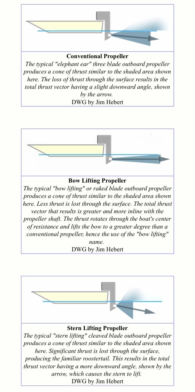

I read that a propp with high ”rake” is the best way for a boat with a high x-dimension..
What type of propp is a one with high rake?
sorry again for my questions..

Why not just use the water pickup in the outdrive to test??? I certainly would not be drilling another hole in the transom for testing.

You should not plug the drive. You want water to go through it and dump out somewhere. The water flow helps the drive run cooler.
No way you can temp move the water pick up. But you should trim it down slightly with the leading edge even with the hull bottom.
First thing I'd do is trim down the water pickup. Second would be to install the spacer.
I mean it is plugged in the transom assembly, not in the drive sorry...
I will do that before I install the spacer.
