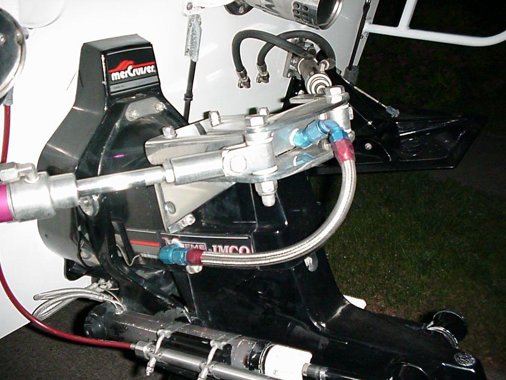

Another option to allow water to flow through the drive is tap the water jacket and use it to feed your drive shower.

But if I unplug it in the transom assembly it will flow water into the boat?
I mean the original water inlet to the engine, that one is plugged and replaced with the water pickup.
I dont mean that youre not right, its just me that dont understand I think

The water that flows though the transom assembly gets connected to another hose and then connected to a thru hull fitting that dumps the water outside the boat.
