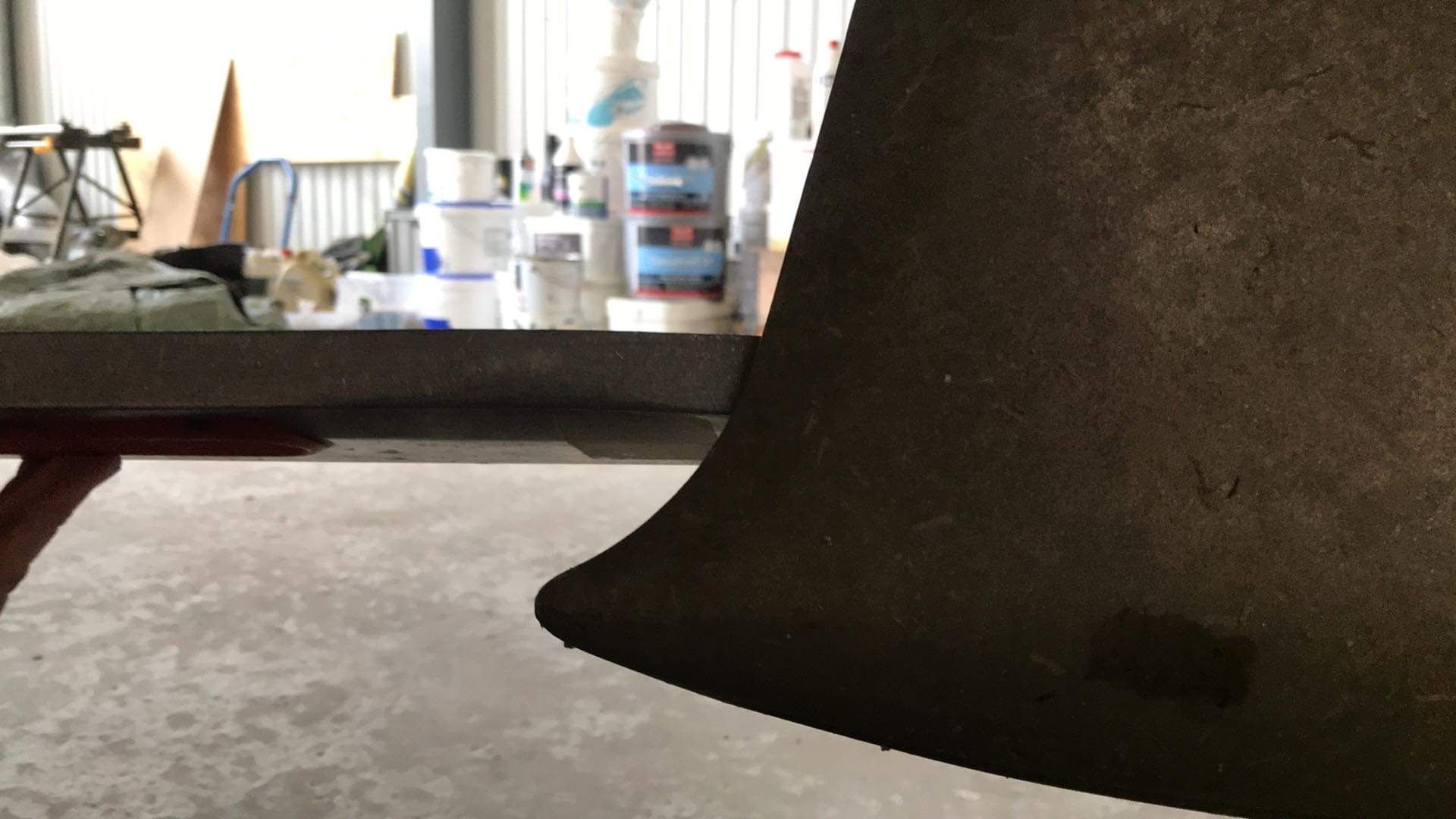

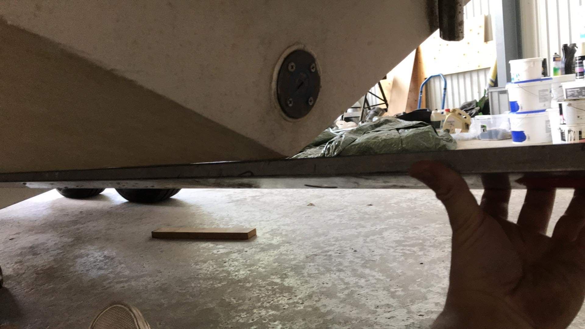

I towed the boat up yesterday.
Today I messured the prop shaft height and it is about 1,77 ” below the V-bottom...
pretty high I think.. I only have a 0,5 ” spacer to put on and test with....
What your thoughts?

Yes, it is high for a non stepped hull. You should see improvements with the .5” spacer, but you probably need to go further.

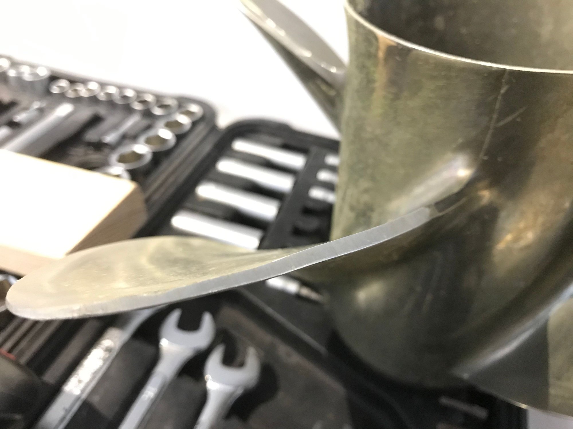

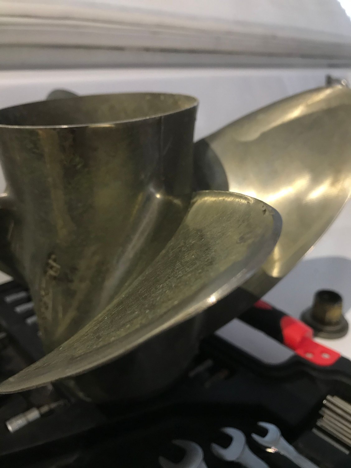

it looks like the propp have been labbed
looks like the cupping is reduced from tip of the blade, it also looks that diameter of the prop is cut down, hard to say. stock untouched bravo would be worth to try. My stock bravo 22" is hair over 15" diameter and stock 24" is hair under 15". Dont know what diameter of the 26" should be. Try measure the diameter.

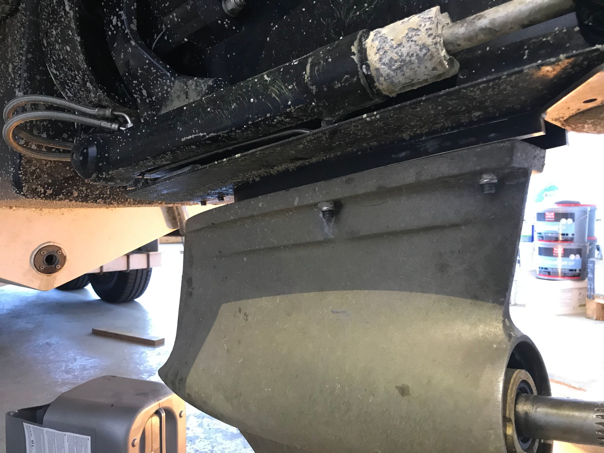

here is a picture of the water pickup. Measure in european millimeter

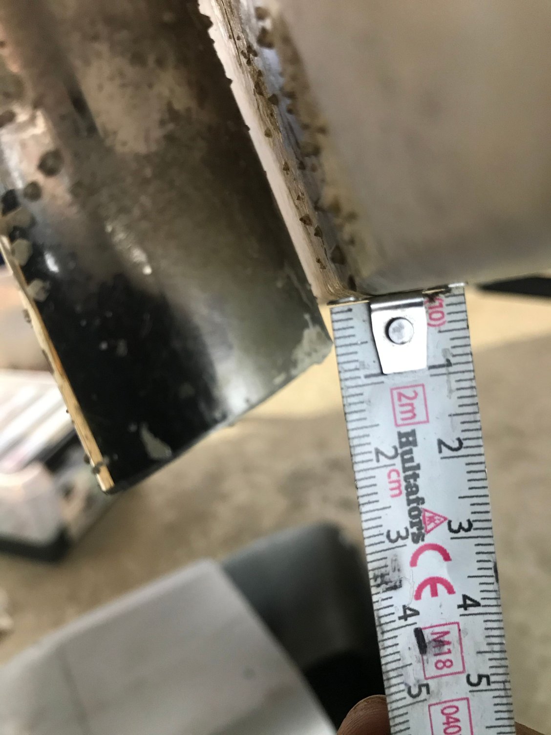

I got the spacer installed today.
So now it is 2,3” heigh
before it was 1,7”
