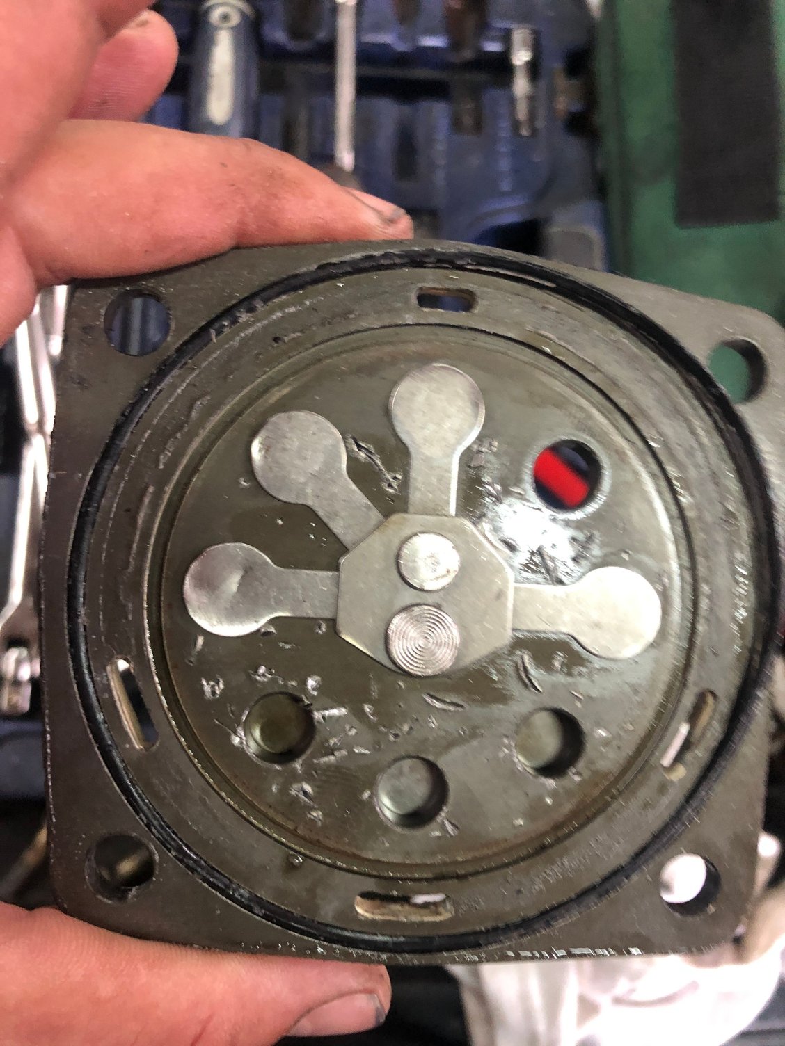

Cruise was 47mph at 4K rpms. Didn’t get to run long because the mpr blew. Put a new relay and now it won’t stay running. Starts just for 1sec. then shuts off. Fuel pump does turn on

UPDATE: Just got it back from the shop. The no start was due to broken reed in the air compressor.
