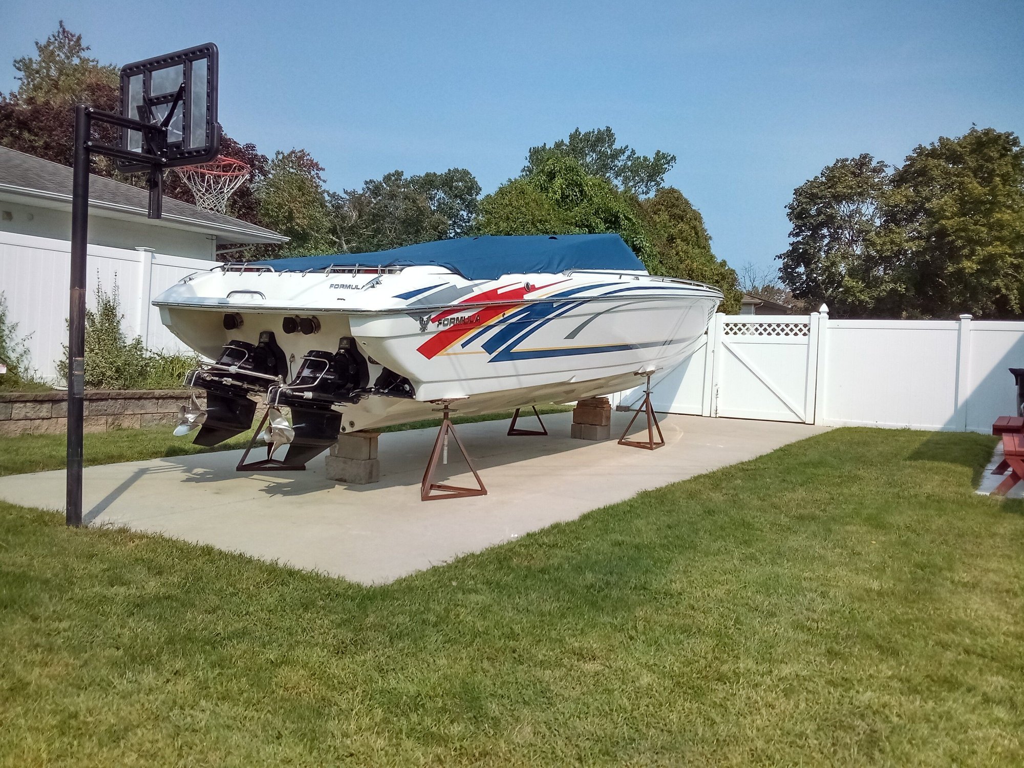

Anybody with 35' formula 353 fast tech what size props work well
2x496/425? Only getting 4000 RPM? Thanks

what props are on it

I think you should probably be running 28 Bravos. Had a friend with a 353 with 500's and he ran 30 Bravo's.

That is what we have but boat can't go past 4000 RPM even trimmed out??

Borrow a set of 26's.
How high are you trimming?
....and how long did it take you to get it on the boat stands and off your trailer? #interesting

Good luck with the prop situation.
But I must ask, how'd you get it on the stands in your driveway?
