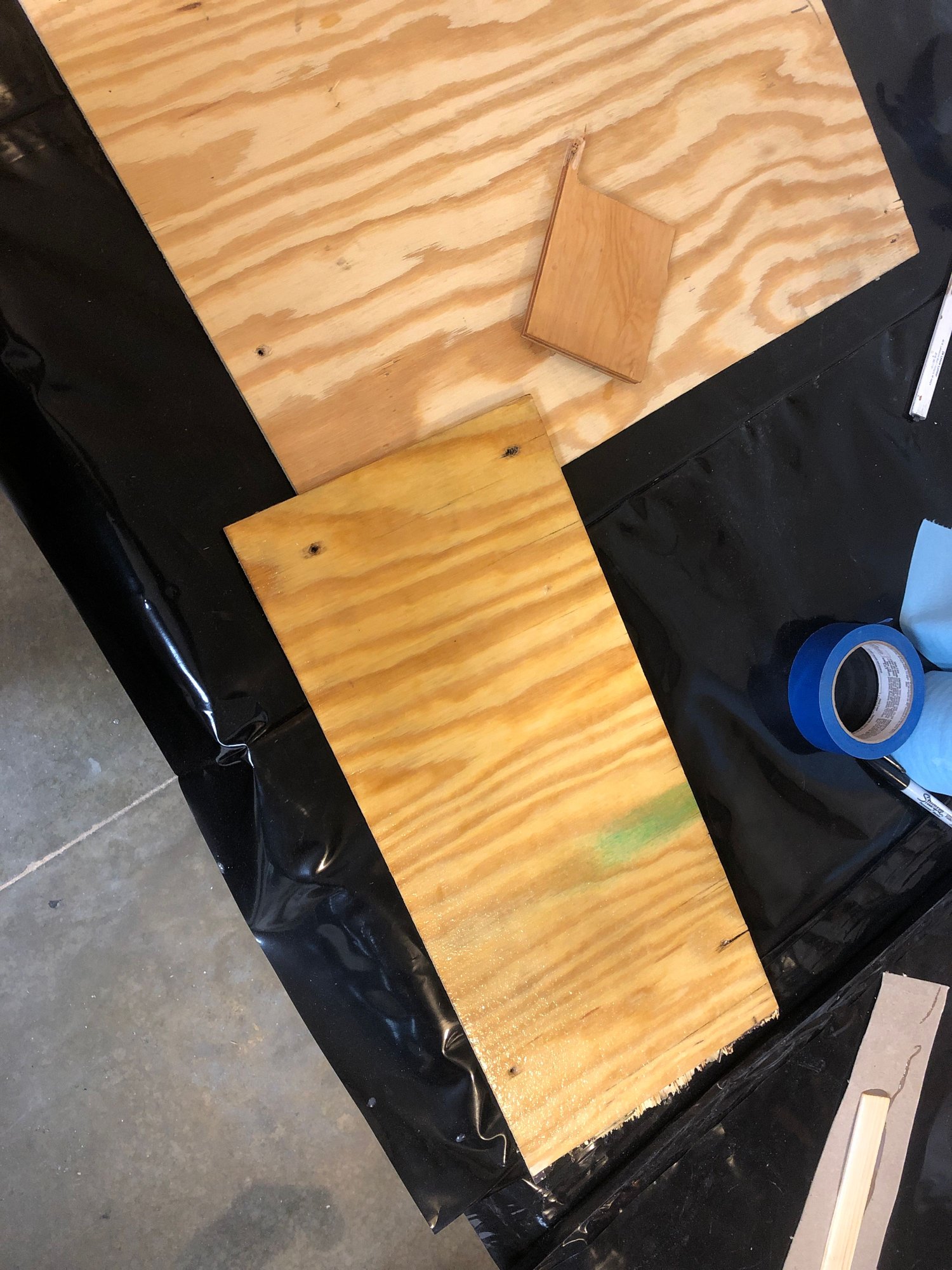

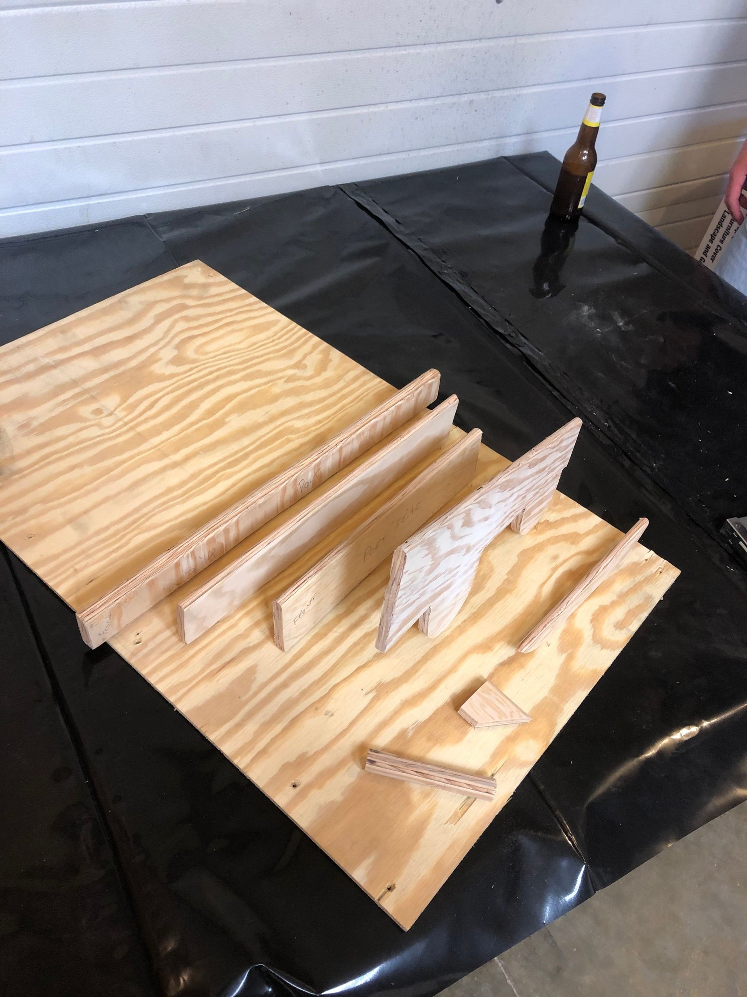

Well. I stayed up late Saturday night after I got all my stringer pieces cut and fit. I was so excited to get my buckets of epoxy resin and hardener out and throw a coat on all the pieces. Long story short I think my resin is shot. I had it in the bathroom in the barn all winter right next to the heater and I’m not sure if it got moisture in it or if the bucket wasn’t completely sealed and got grinding dust in it or what. It’s a very white thick pancake batter kind of thickness. Wasn’t like that when I got it. So instead of coating all the pieces I figured I would do a couple test pieces and I’m sure glad I did. First mixture I made up was just what I was told to do. 2 to 1 by weight resin to hardener. From Saturday night at 2am to Sunday night at 10pm it never got hard. I fed the batch a blue pill and threw some more hardener at it just to see what it would do. It didn’t lay on nice, still had brush marks, and did eventually get hard. I’m not going to use it. Not worth it. So this coming weekend hopefully I can get a new pal or epoxy and seal the pieces.
