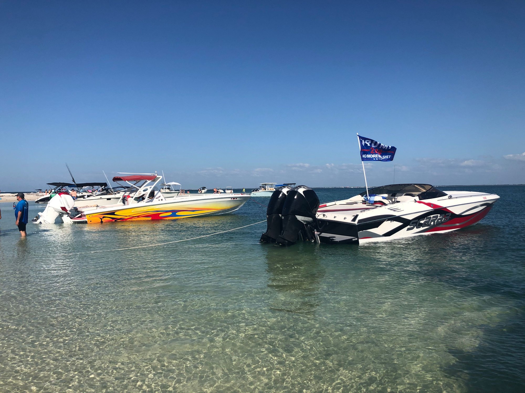

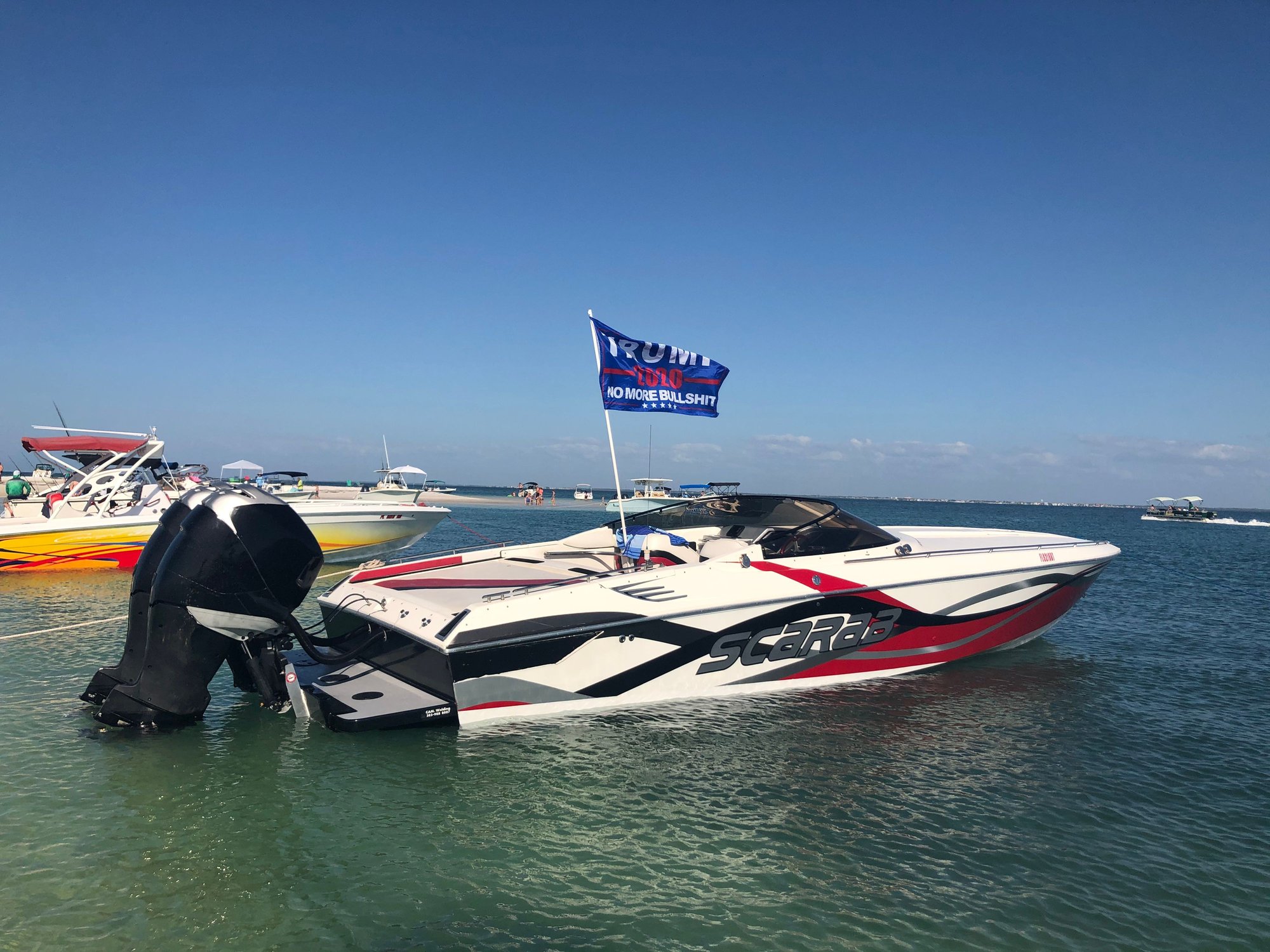

Love the Trump flag.
Have mine in front yard.
The boat looks GREAT w/the O/Bs!

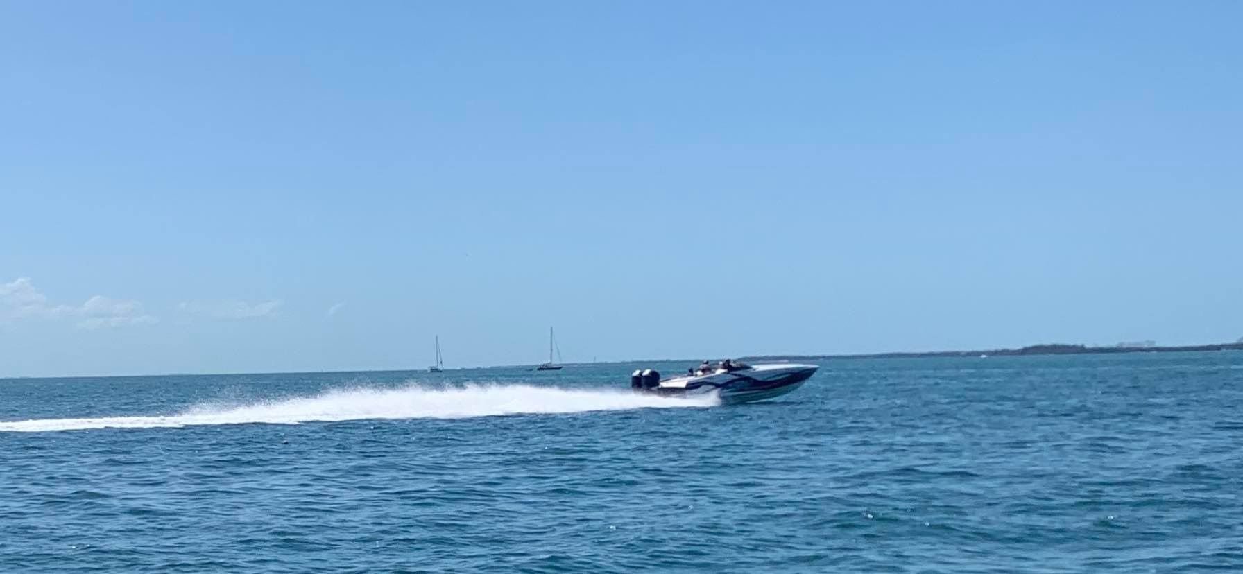

I agree pretty sure 70 is possible with the second tune. For RPMs I was at 6200 on the port motor (non tuned) and 6350 on the starboard engine. Even when I had the one computer bad my RPMs where still very close even though only one engine was going beyond 80% but the fuel flow split was massive. 28gph on port to 17 on starboard with the bad computer. It was too rough and could not get good numbers this past weekend so will bring up the fuel flow next run and see if its split. If it is split then I know the non tuned engine is dragging them both down.
I also need to find the leak in the transom bracket because its holding about 40 gallons of water and that's not helping.
Was fun flying past all the fishing boats.. I mean high performance center counsels as they call them all weekend. A new thing she will do is when I have her trimmed out for topend and go down to cruise it will porpoise some until I feed in a touch of down trim. Its no big deal just something new I would assume since its so much lighter and the CG shifted back some. Felt like a heavy tank before now she is like a sports car.

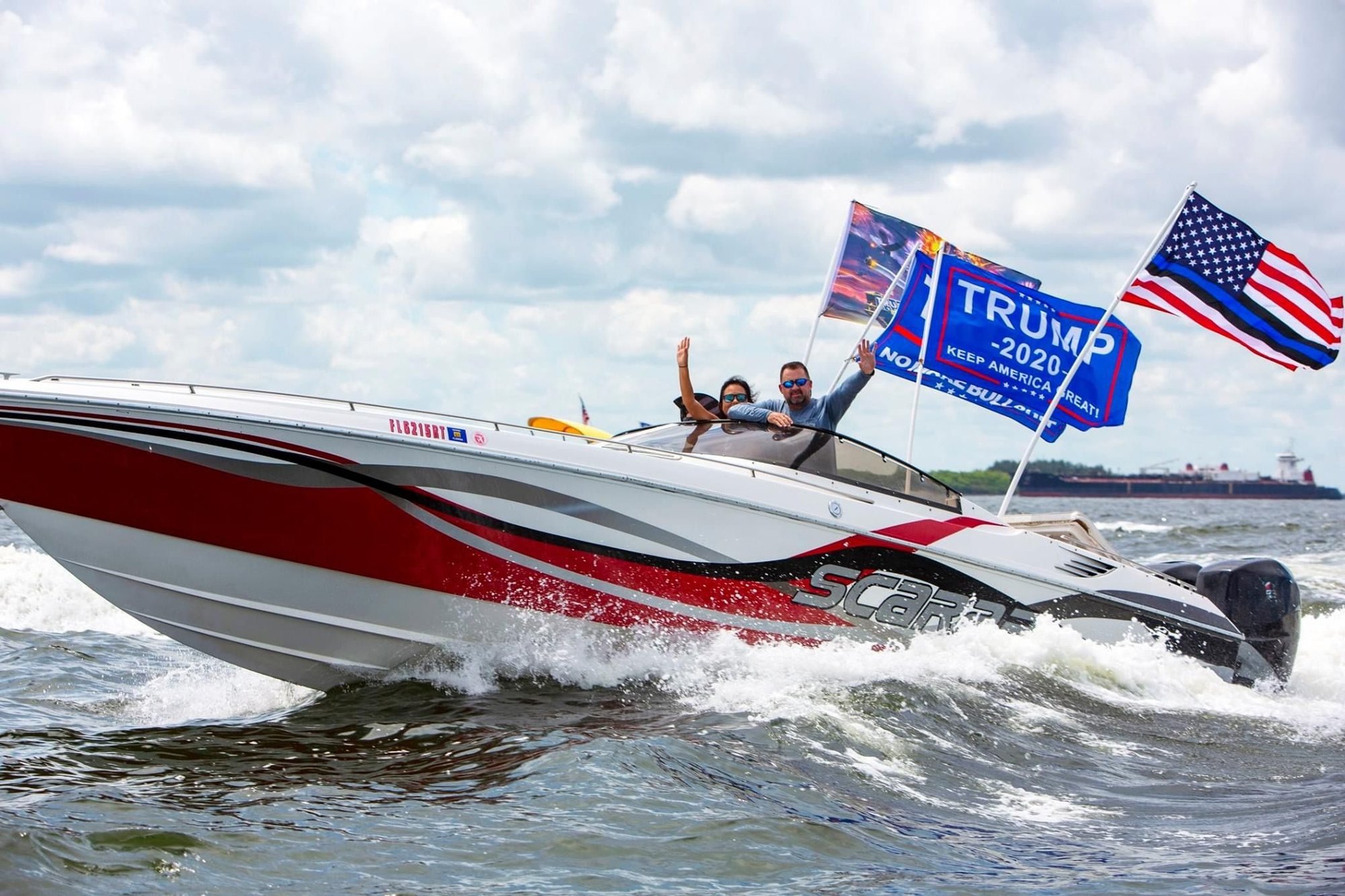

Almost have 100 hours on her since the retrofit now. Loving it. Use it every weekend and sometimes take her to dinner during the week.
got the other engine tuned now and she is right in the upper 60s about 68 or so now. I just serviced all the 100 hour items but might order new impellers and while I have lowers off swap them from left to right.
had a buddy with a scarab 302 get about 3mph gain by spinning them in. So that would get me past the 70mph mark.
