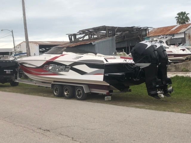

Just a little observation....If you are mounting those engines there they are going to be too low. The bracket should have been mounted at least 5 inches higher. You want to have the propshaft a minimum of 1" over the v with that amount of setback. If you run at low speeds, you won't see a difference. If you swing a big prop, at higher speeds when you trim the boat, you might have a violent chine walk. Ask me how I know.
There is still time to pull that bracket, plug the holes and re-drill new ones before you get much further.
thanks for the info.. on thought it was to low also but the guy said this is the only place it will work for the twins and trips. He said this the the recommended spot.
I will try it and if it sucks then back to the drawing board.

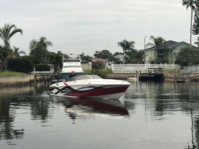

Shes wet! Will text it out on plane soon.

Are those XXL shafts? It looks like you have extended shafts so if they are too deep in the water, it may be easier to convert back to XL shafts rather than re-mounting the bracket.
Just a thought.
Good luck with the first test run.
RR
yes they are xxls but I hear converting them to 25s is a pain in the ass. We will see how she does I guess

It is not to hard to convert to 25" shafts. That will be the ticket there!!! Anxious to see how she runs.
