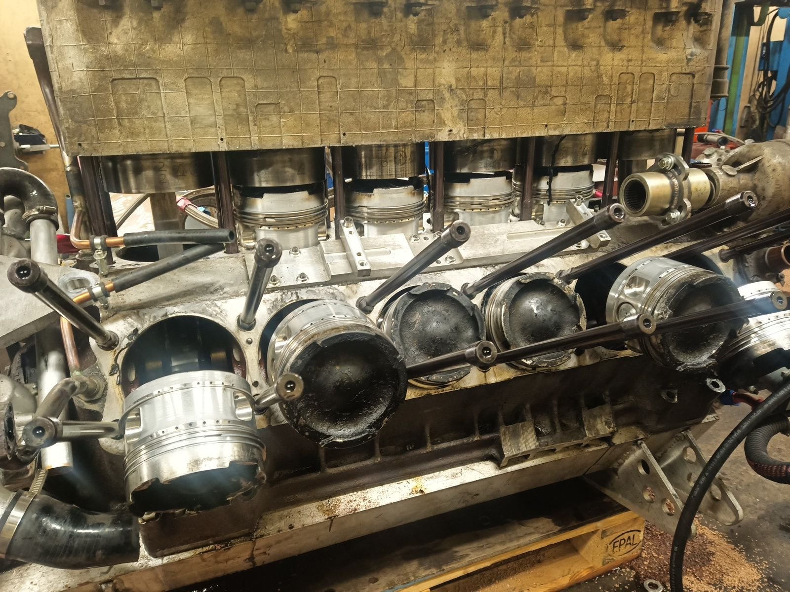

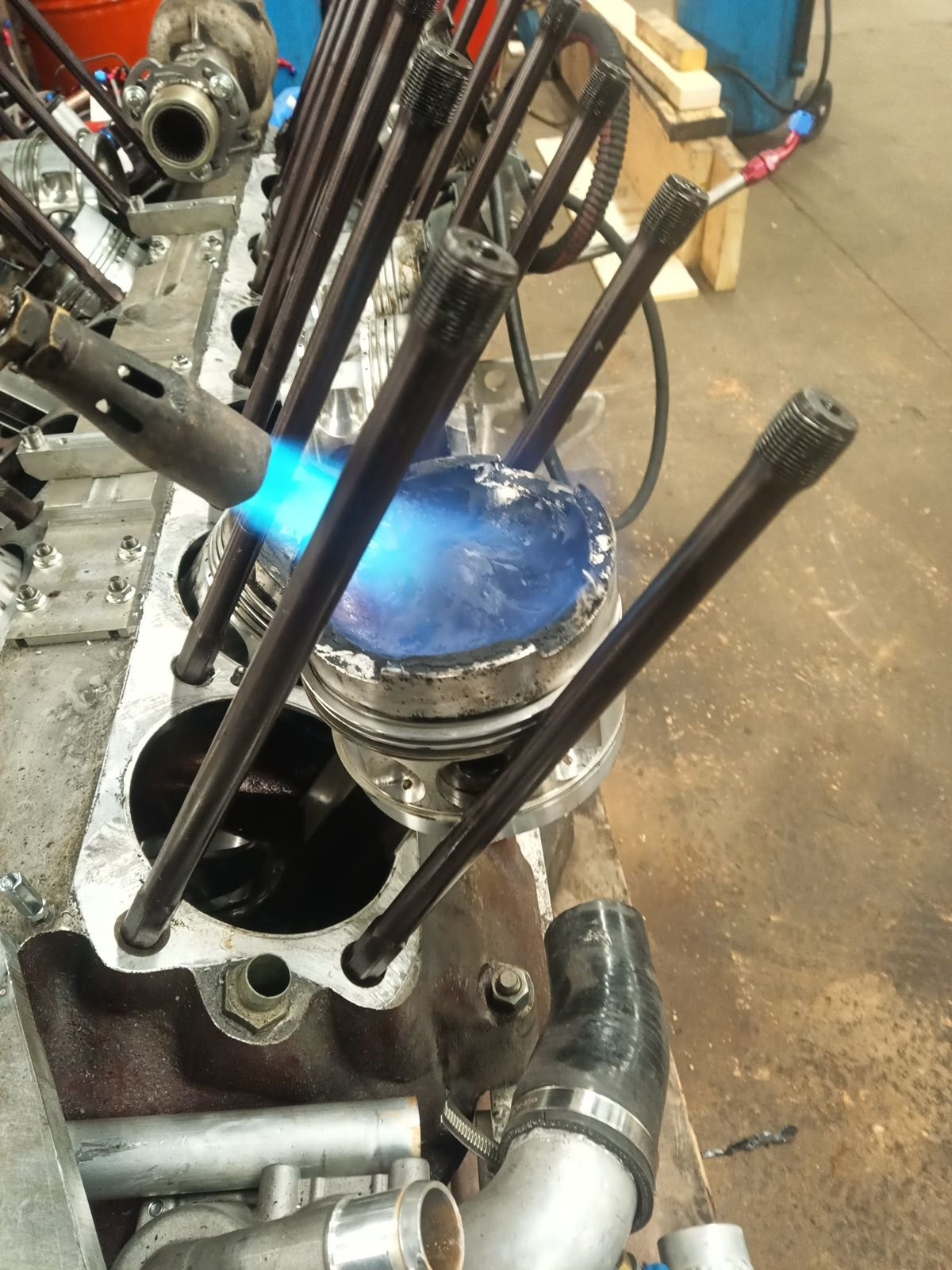

Transmash original pistons was pretty easy to remove though it have press fit pins, heat helps.
Master connecting rods are over feet long!
Connecting rod is too wide to fit Nissan piston, need some milling. I take too much off from this modeling piston, only half milling is enough. Ball end milling bit have to buy so there will be nice round above rod.
Nissan pistons have steel reinforcement plates casted in skirts, may be good thing, who knows?
Nissan UD truck pistons will fit but some things have to change. Nissan 50mm piston pin can not be used, Transmash pin is 42mm so aluminium bronze bushings do the job and Transmash pins have to shorten. It's good thing because weight saving.

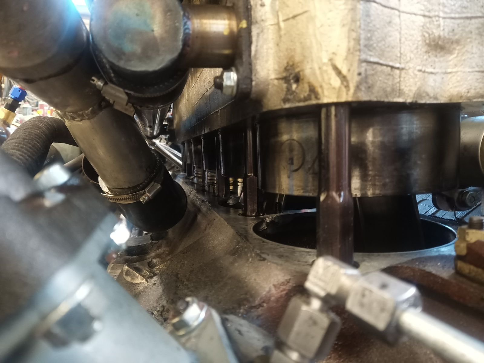

Compression ring is 10mm more up than original, it stay barely in cylinder sleeve, this is not good but ring upper face stay 1mm below cylinder sleeve top. I like it to be more down but it's too big job to raise cylinde blocs or sleeves. Picture fool, it's not a piston ring in picture, only steel ring groove reinforcement can be seen.

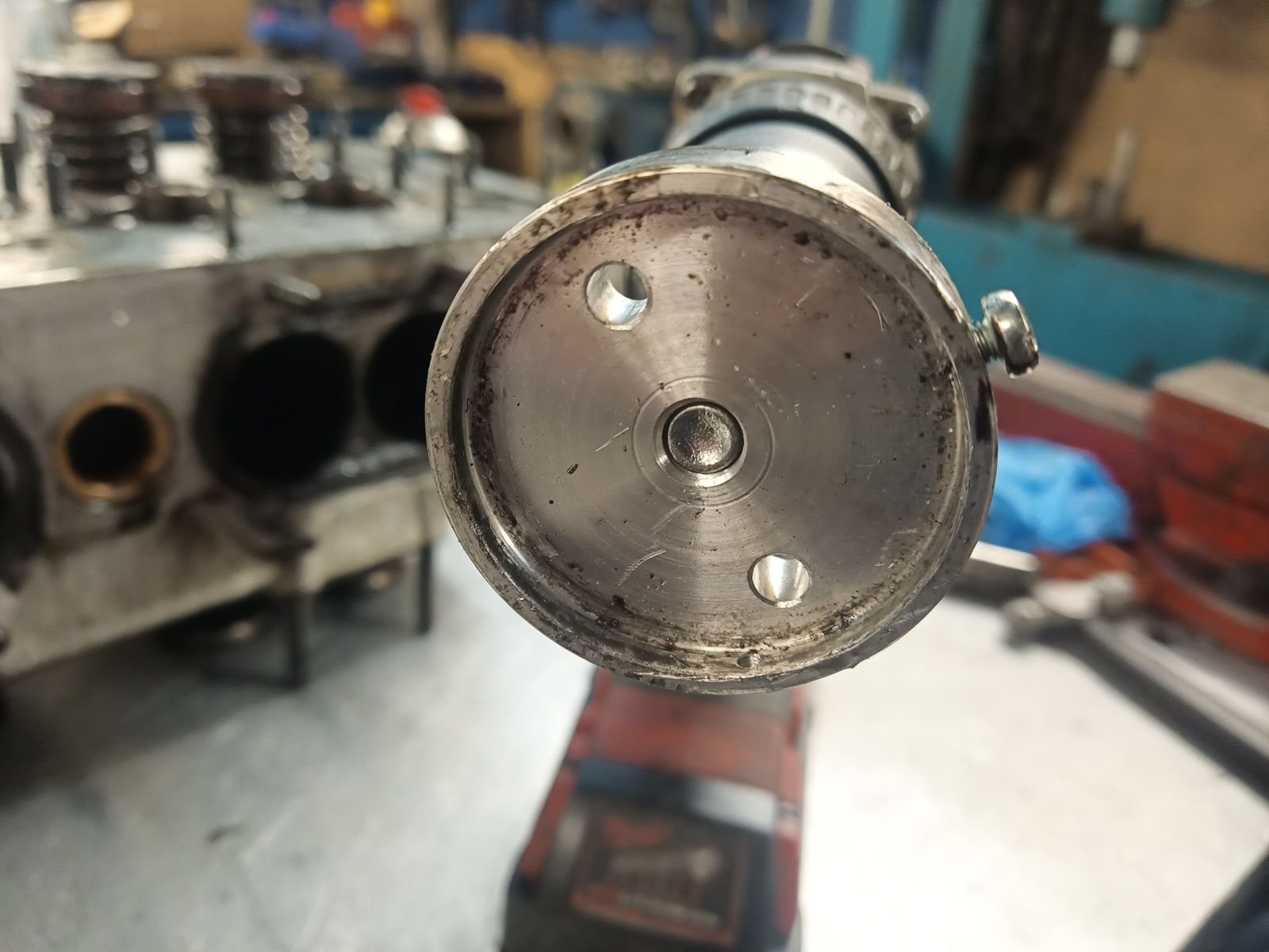

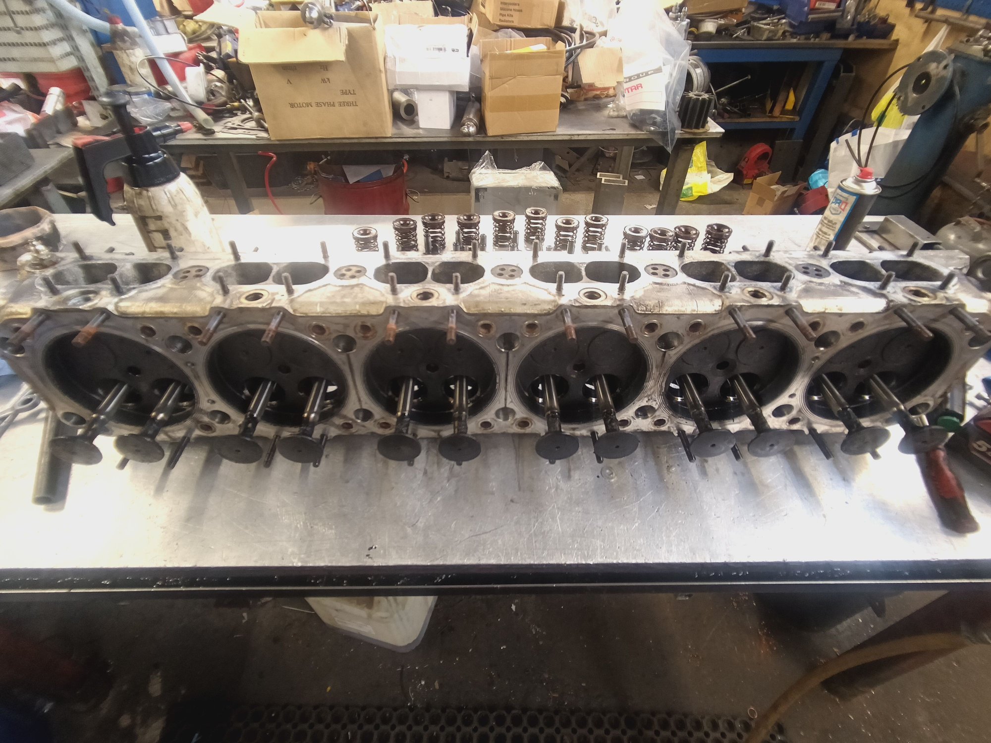

Heads are disassembled now, special tools have to be made so job goes easier. Cam follower is fitted by thread to valve stem, valve clearance adjustment is very easy. Valve stems are 18mm diameter, 54mm intake and 50mm exhaust valves.
Head is almost 4 feet long, barely fit to my washing machine. 80C temp help valve guide removal.
I made special tool from old Scania DC12 engine head bolt to air hammer.
All 48 guides are out. My friend machine new ones from aluminium bronze by CNC lathe, I'm afraid original iron guides will seize especially on exhaust side. Aluminium bronze have bigger thermal expansion rate so it grows away when valve stems grow by heat. It make less wear to stems also. Guide outer diameter is almost one inch
Bad picture but new guides will be much shorter, original guides kill already poor flow logs in half of port. I was wondering if the head should be ported a little simultaneously.
