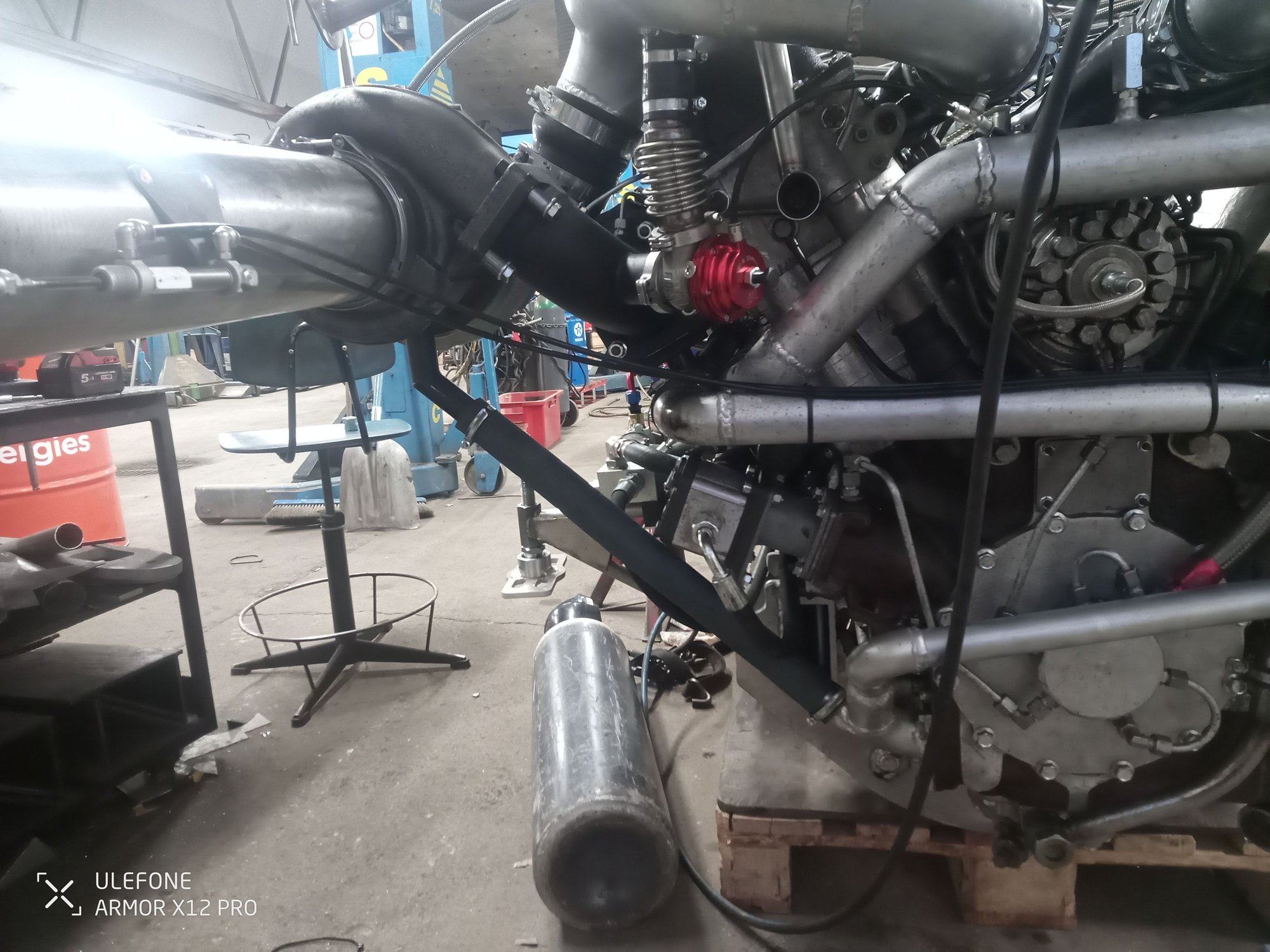

Engine run now pretty smooth, maybe all problems are solved for now. Oil leak to exhaust pipes was hardest, oil come from turbochargers, I did 32mm return lines and restrict oil pressure from 10bars to 4bar. Now new oil doesn't leak but previous oil is everywhere, I have to get EGT up to clean engine but it's not possible without load.
Engine have good efficiensy, I can't get it warm. It takes forever to warm 80C at idle, exhaust open EGT is 40C, you can lean to turbine housing when engine coolant is 80C! Exhaust flaps have two 8mm holes and EGR valves all full open, intakes warm to 50C and engine warm much sooner, all cold haze are gone when flaps shut.

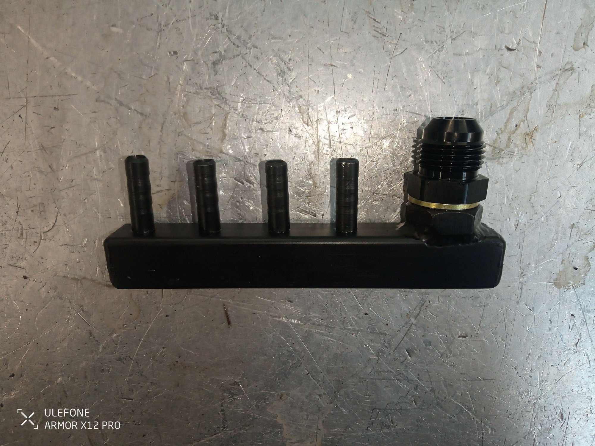

I have to build fuel supply manifold for four fuel pumps, all pumps have non return valves so I can normally run only two 12v pumps connected series so 24v voltage can be used.

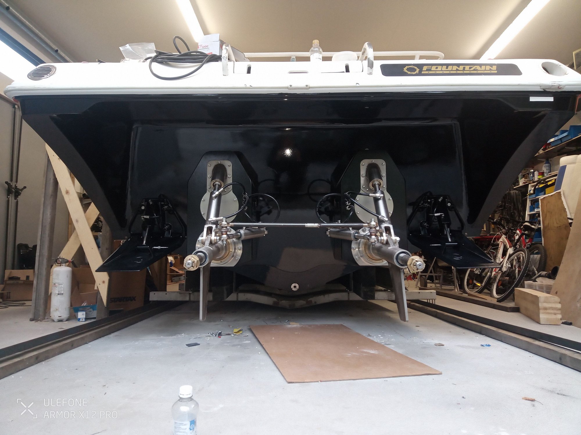

All new hydraulics, I cut hoses to right lenght and them take them to hydraulic shop to press ends on. 1/4" thread inserts are weld to extension boxes, inner parts can be zink plated and outer parts are 316 stainless. Trim hoses are kevlar braided special hose. steering is 3/8" regular 225bar hydraulic hose.
Yesterday we drop boat back to trailer from stands and make U-steel rails under so boat can be pulled just enough outside that engine package can be lifted in.
This boat is going to run in this summer.
