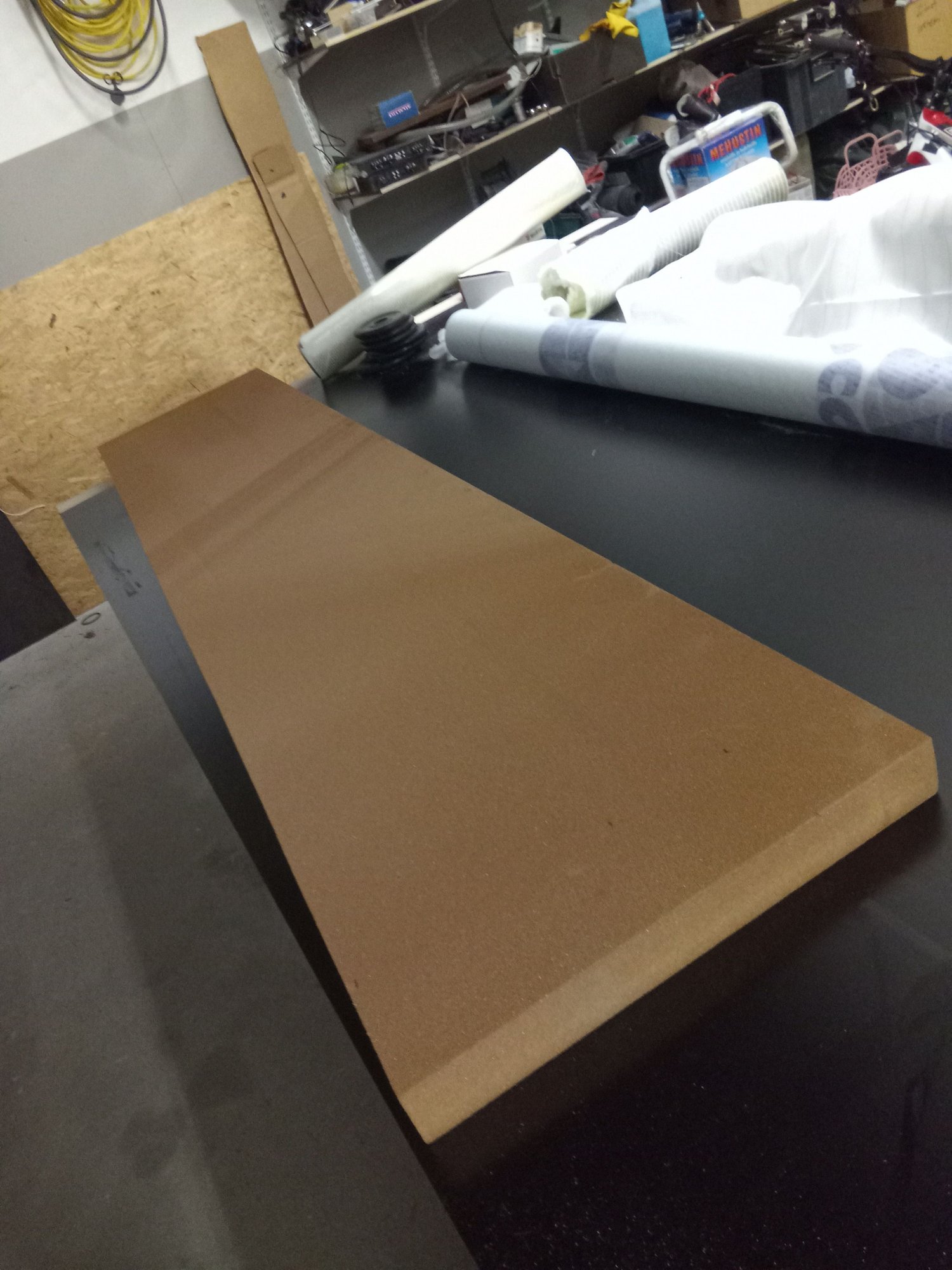

50mm 80kg/m3 Divinycell pvc foam for new stringer core.
Cut as close as possible to hull shape. Upper cornes is radiused after this picture so fibers turn nicely over edges.
Front bulkhead tabbed and smaller stringer angle test, it will fit nicely in place. Next thing to do is bond stringers to hull with thickened epoxy, make radius between hull and stringer and glass those over with carbon UD reinforcement.
