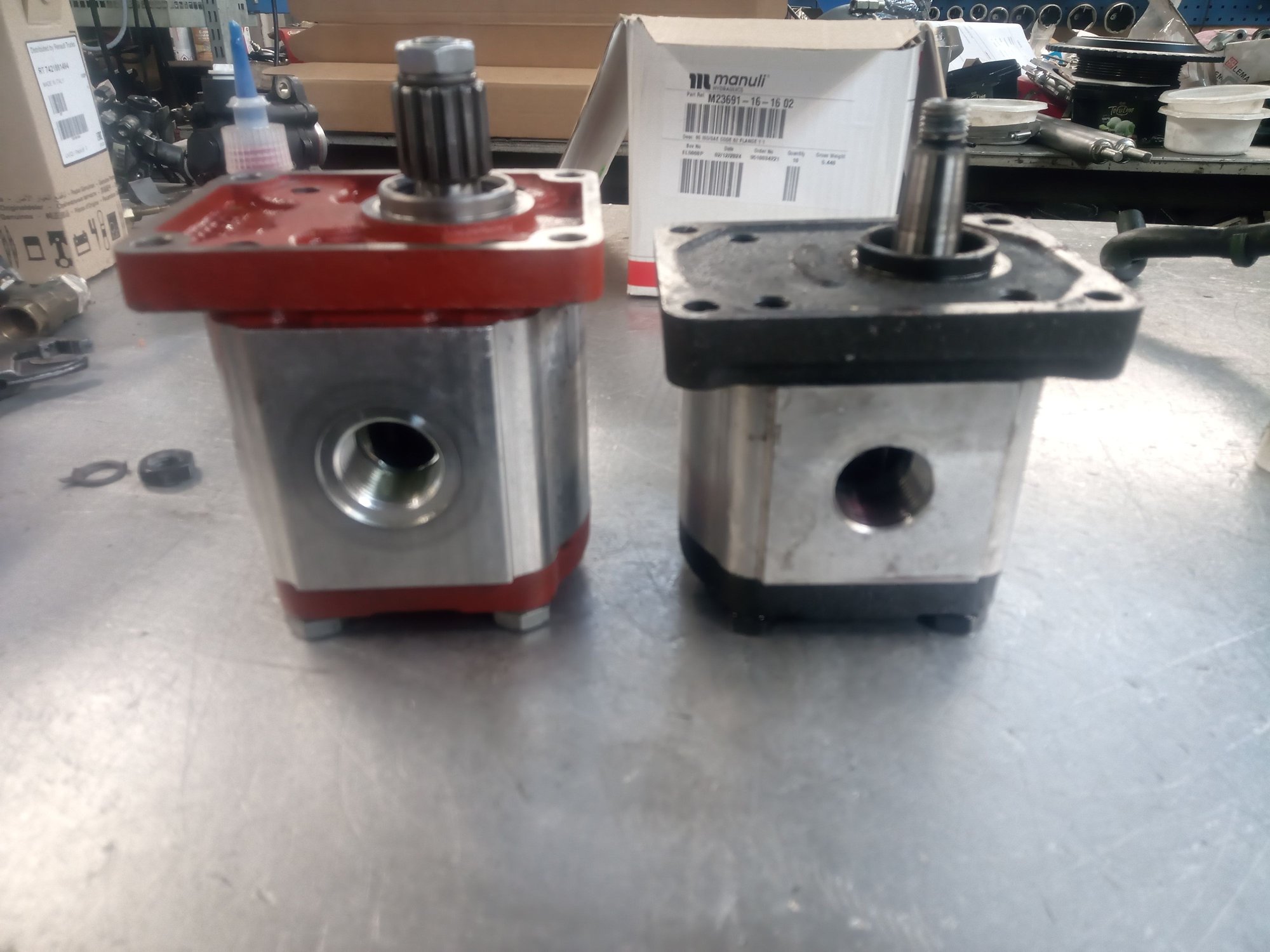

Long time no update. I have had too much too hard repair project in work that I didn't have energy to work on Fountain. All free time is used on water or some happenings.
We made sea (lake) trial few weeks ago but boat had some problems. Hydraulics work now somehow when oil was cold, little warm up and pump didn't have enough flow. Transmission have internal leaks that are normal in automatic transmissions valvebodies. Low engine rpm either raw water pump or accessory drive stops when flow go down, this was an aware problem because before hydraulic motors was in series and now in parallel. I bought bigger pump and today try assembly it but no success yet, nut is too tall and bottom to drive shaft, need to shorten tomorrow.
Pump is in very tight place but can change without major disassembly.
New pump is little taller but luckily fit in place.
Another problem in test drive was engine oil pressure loss when oil warm to 75C, it should be 10-12bar in Transmash at high rpm but it drops to 4bar. I think piston oil coolers open too soon or some modified valve in Volvo D13 filter housing are not working right. I will put ball valves between hoses so next test drive I can shut piston cooling and filter housing return line to test where all flow goes. Idle pressure is still 1.5bar so I don't think engine have big internal leak, then there will be zero pressure at idle, could be some control valve problem.
Transmission, splitbox, drives and steering work pretty good. Boat handle pretty good at low speeds, we can't try it on plane because lack of oil pressure.

hydraulic problems are solved now with bigger pump. oil pressure problem is still there but too hot in Finland now to do anything than boating with my old boat. Oil is broke down to very low viscosity some reason that I don't understand. I have to change oil and filters first.
