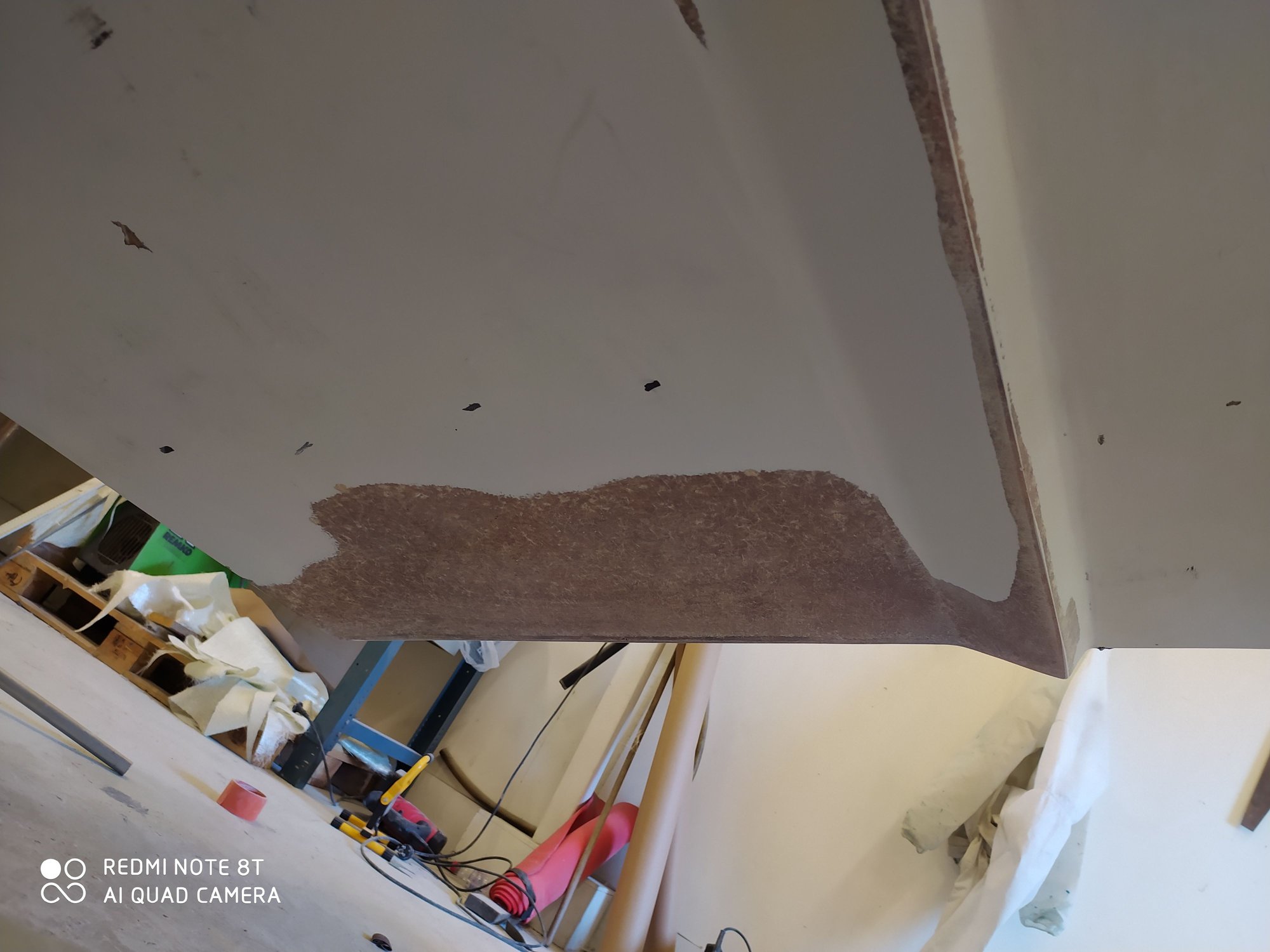

Ready for tapping
trying to sand the hook away, added 6 layers 450g inside the Hull, plus 4 layers in the corner below the plywood of the transom, should be enough material to sand the hook away.

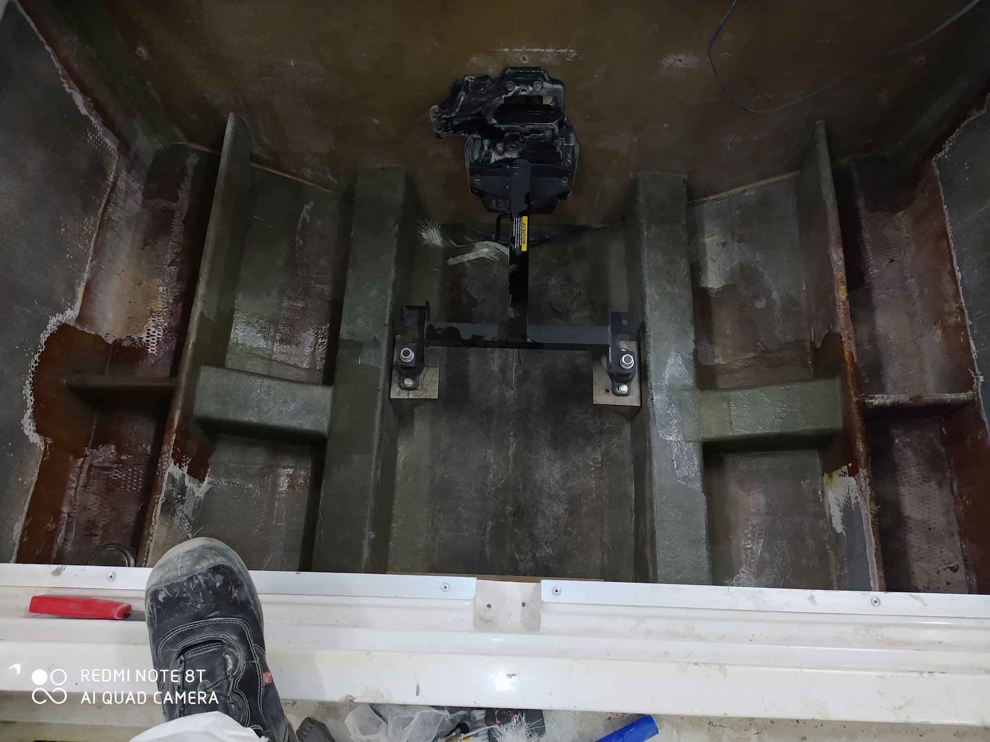

Not so nice job to do, getting there slowly.

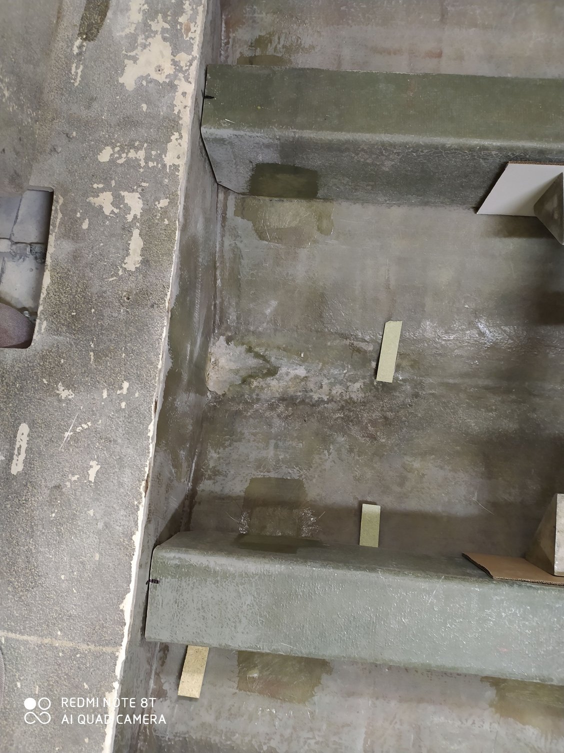

Side floors ready for glassing.

Side floors glassed. Next step is clean everything carefully and paint with epoxy primer.
