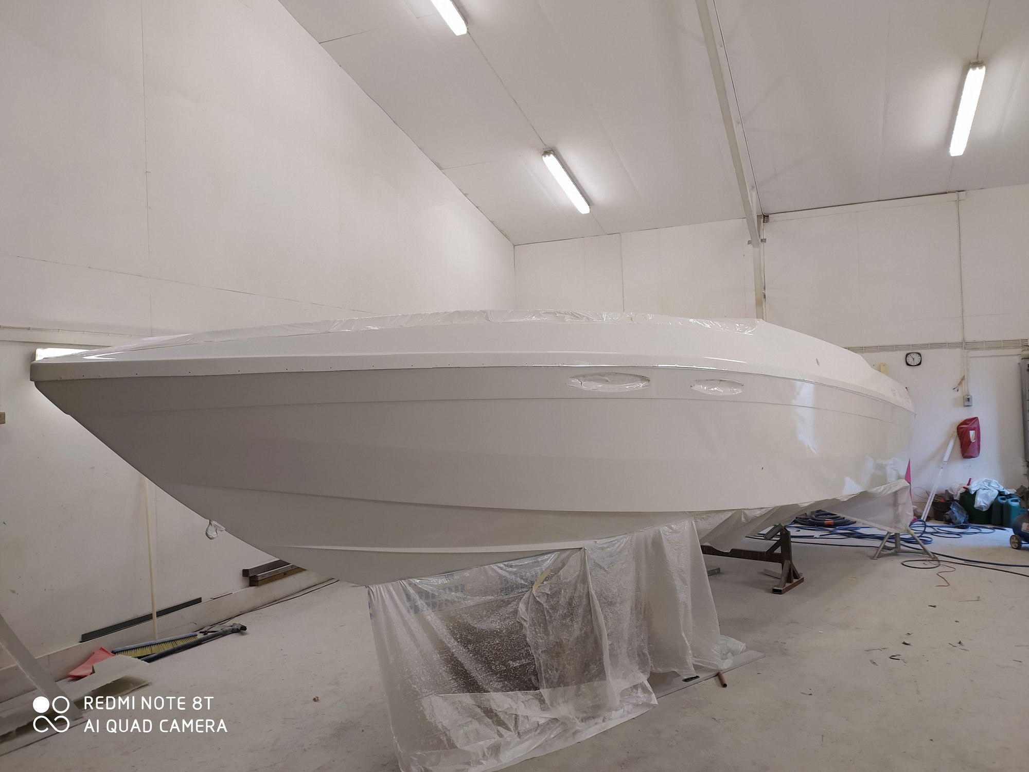

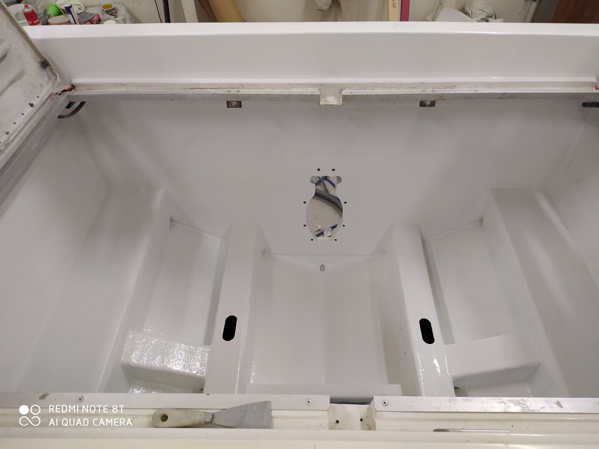

1 layer of percotop 9700, one more layer tomorrow and 👌

Bad ass dude!
Keep it up.
Cant wait to see finished product.

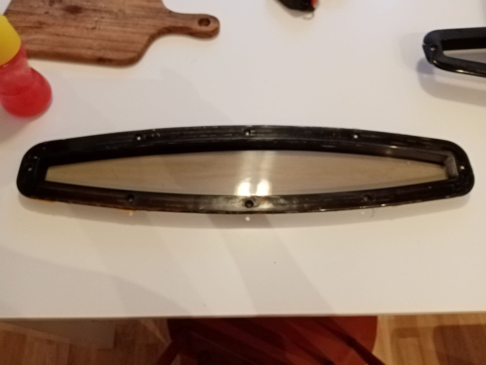

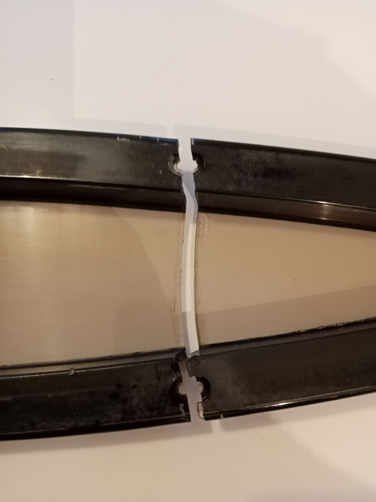

2 of the ports are cracked, Dont know if these could be fixed to last?

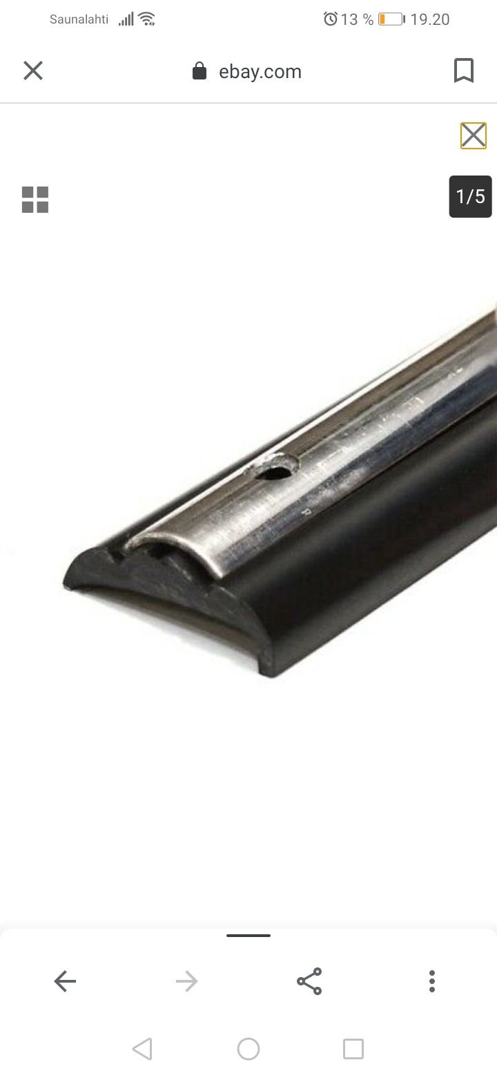

Original solid aluminum Rub Rail is In bad shape and have to be replaced, looking for options. Really liked the Look of this taco metals rail that was In my old chris craft limited but it is not cheap.

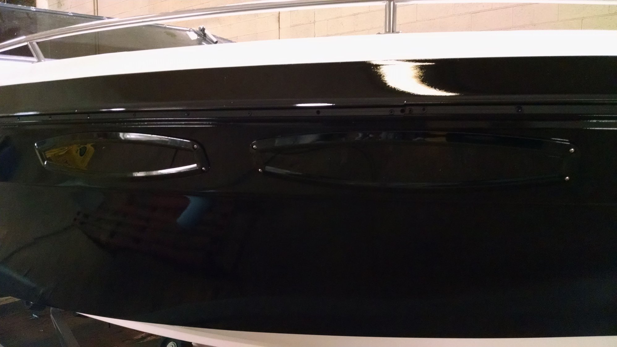

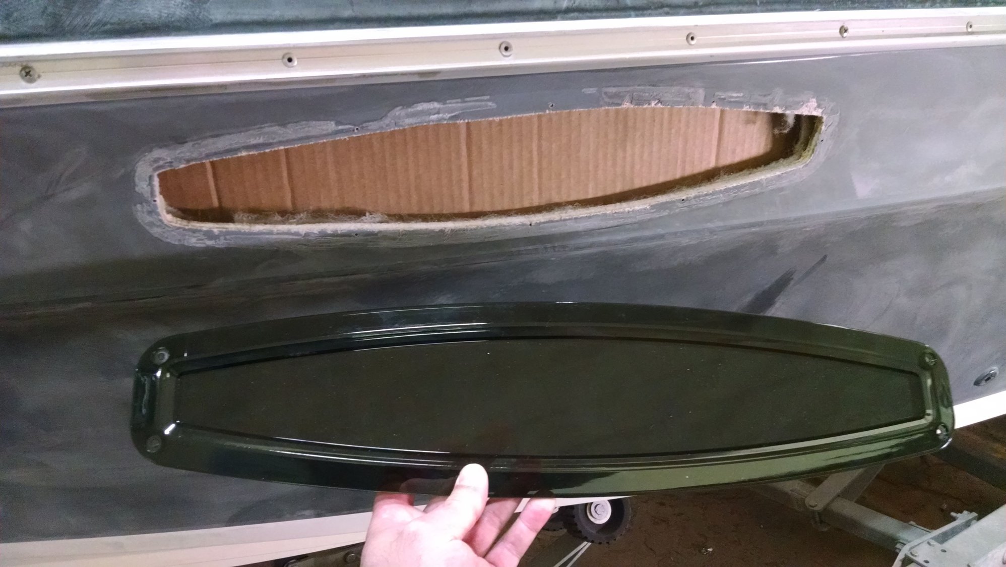

I had side windows that cracked just like that on a 87 Mirage I restored a few years ago. I found the Beckson Marine PF100SB windows were a direct replacement for the hole size. They look a little more modern though than the originals.

Barbour Plastics is another option for rub rails.
