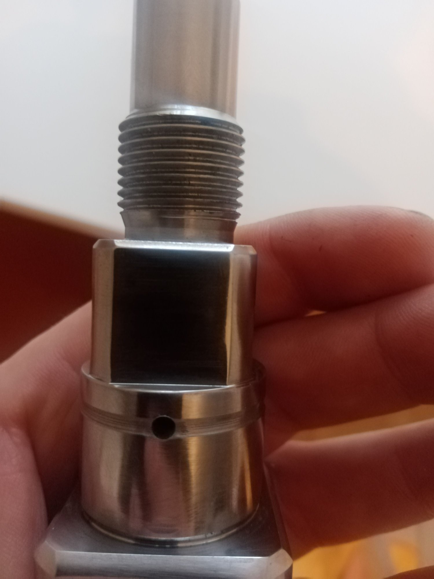

Could not help myself to thrill grease lines for the upper swivel. there may be a good reason for merc stopped doing this, but i sleep better now.
