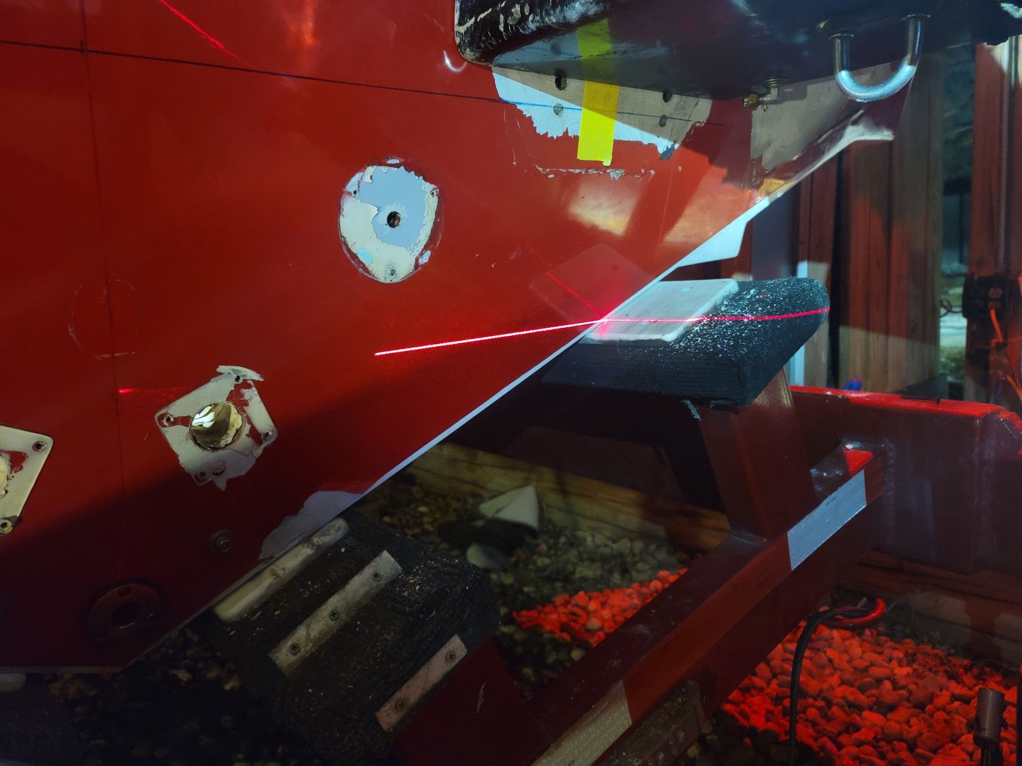

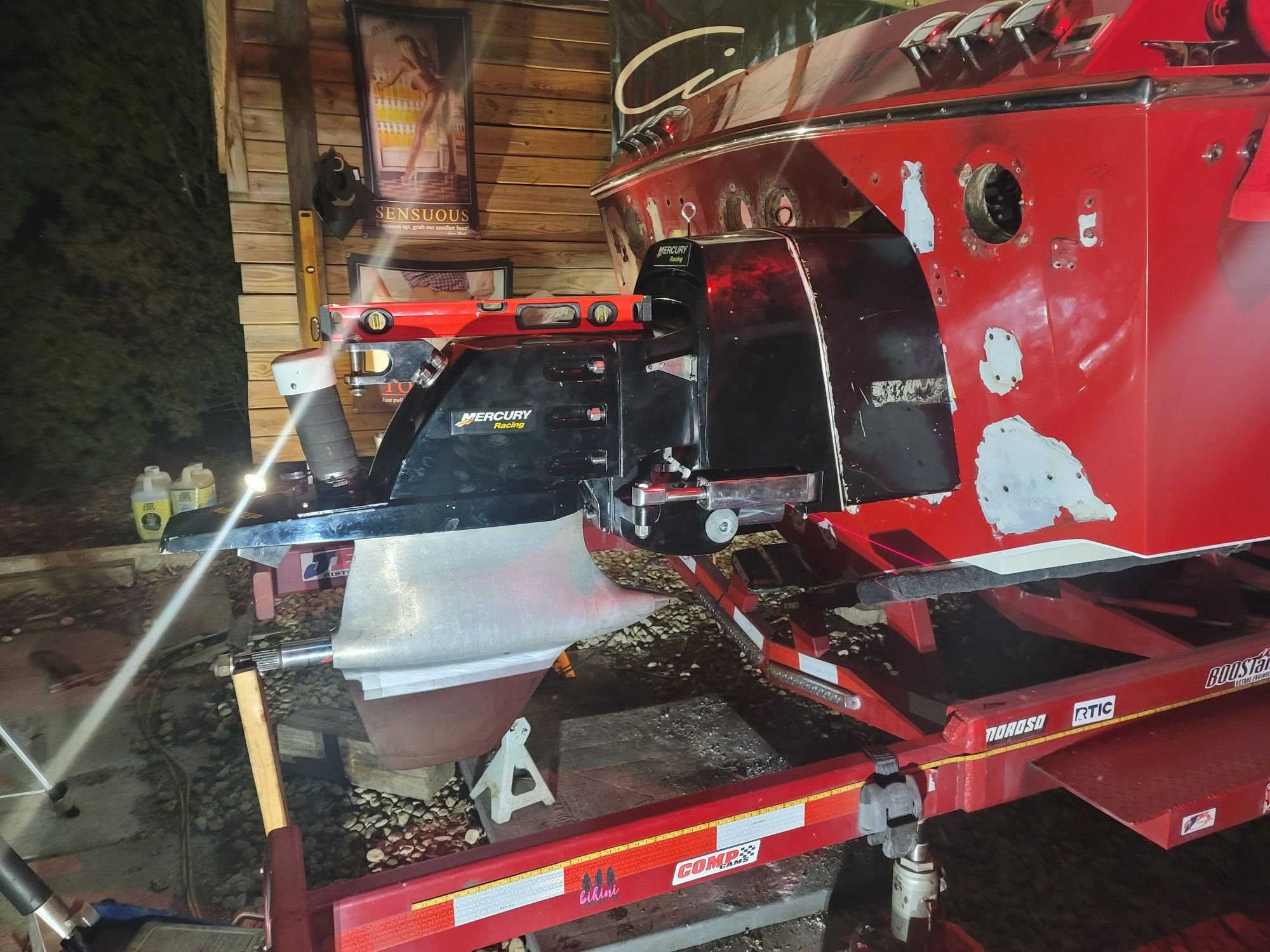

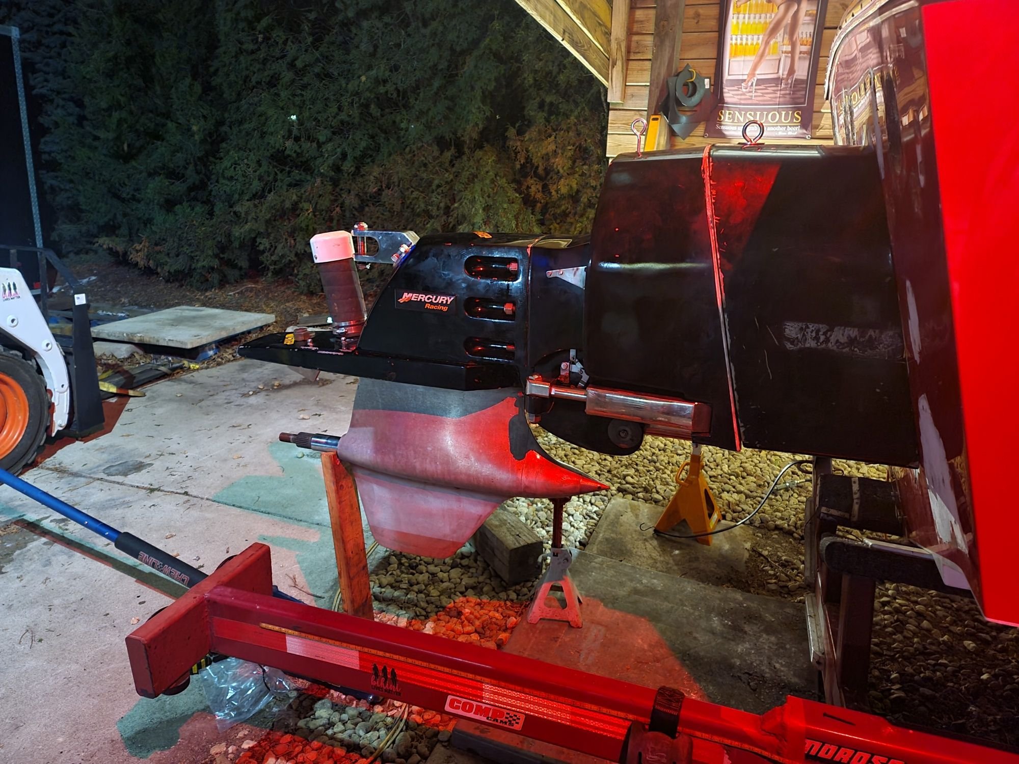

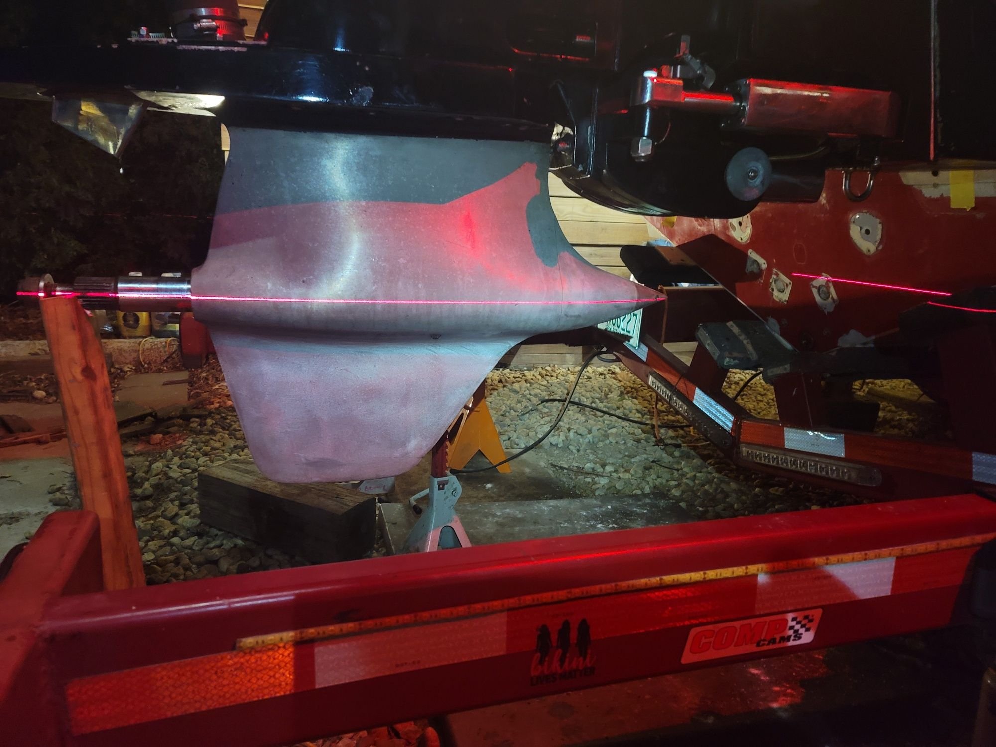

I think I got it figured out , I got some laser high tech $hit going on over here that helped lol
23* fun times .

Had to think about those pictures for a minute, it looks like the whole assembly was leaning up against the transom and supported by the floorjack on the propshaft, raised up/down tapped around and marked, then i realized you had that custom template to find plumb, center and X, the floorjack was just holding nuetral trim for the laser double check and pics.
nice job, hell of an update !
you take a picture with the template ?

No trim hooked up so yes you have it right.
The templates are pretty sweet , I`ll snap a picture of the set up later .
