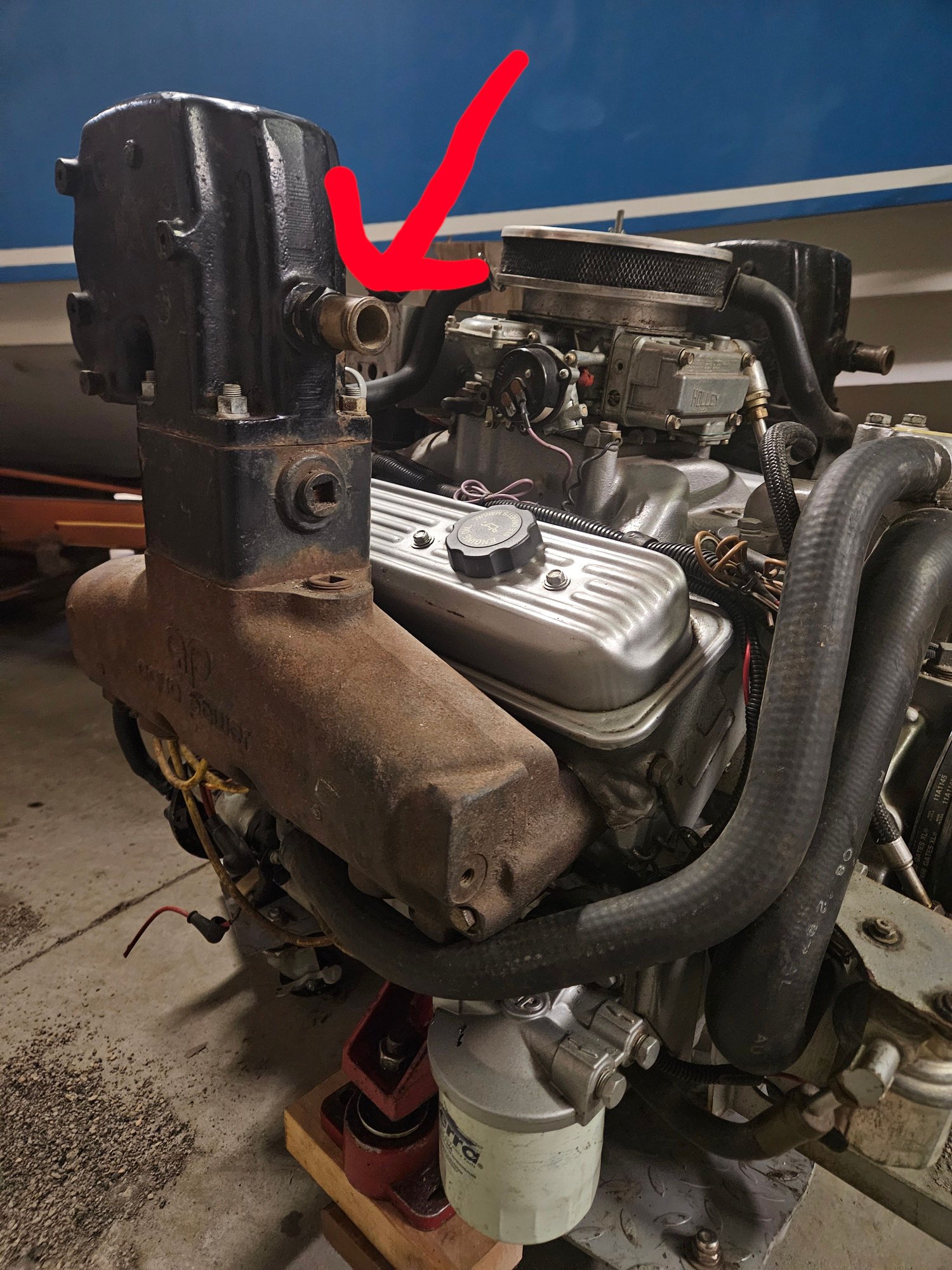

So the boat came with the riser spacers, and the holes in the transom for the exhaust tips line up good using the riser spacers. Am I ok to plug the port in the top of the riser, and only feed water to the manifold from the bottom?
