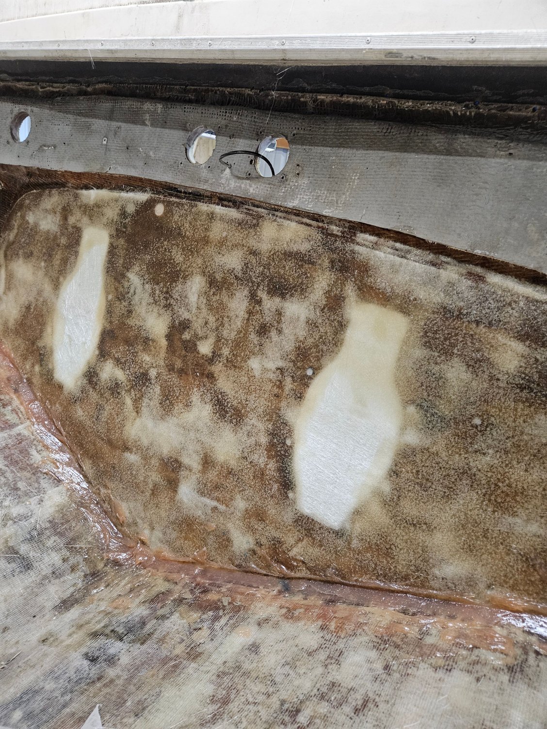

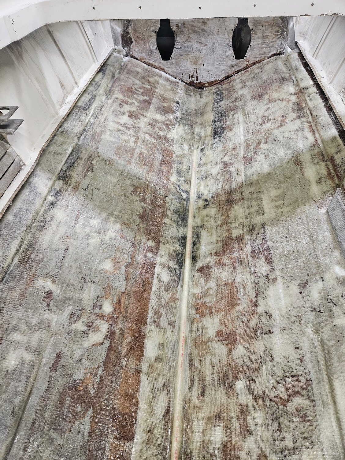

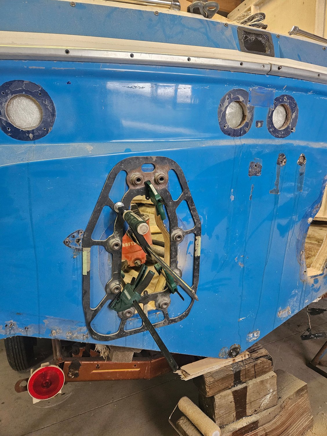

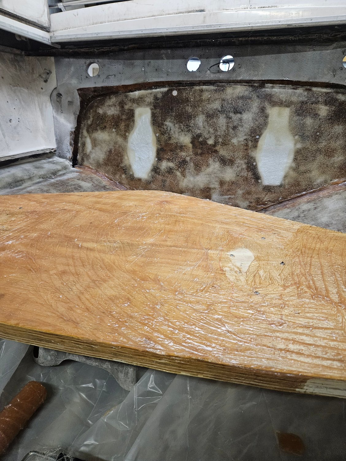

Got 2 layers of glass down on the other half of the bottom and got the transom wood in. For that I first laid up 4 layers of glass on the boat, then mixed up some resin with cabosil to thicken it up and applied that to the wood. Then squished/clamped/screwed it together everywhere I could.

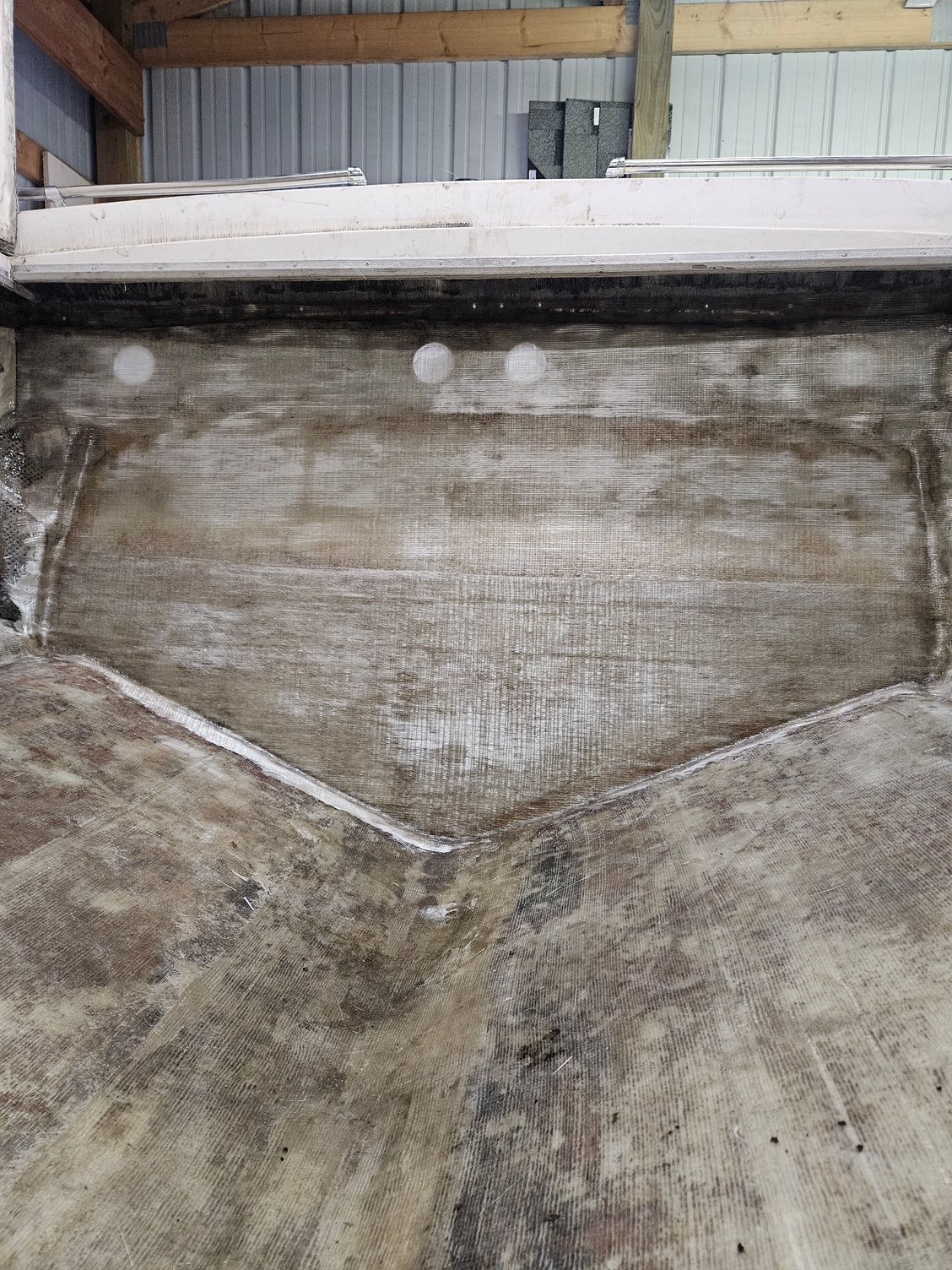

Transom is glassed in! Also glassed the hull to deck joint together in the back.

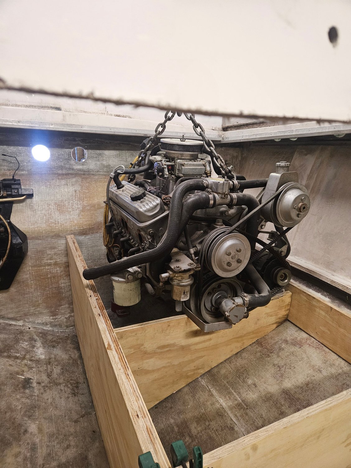

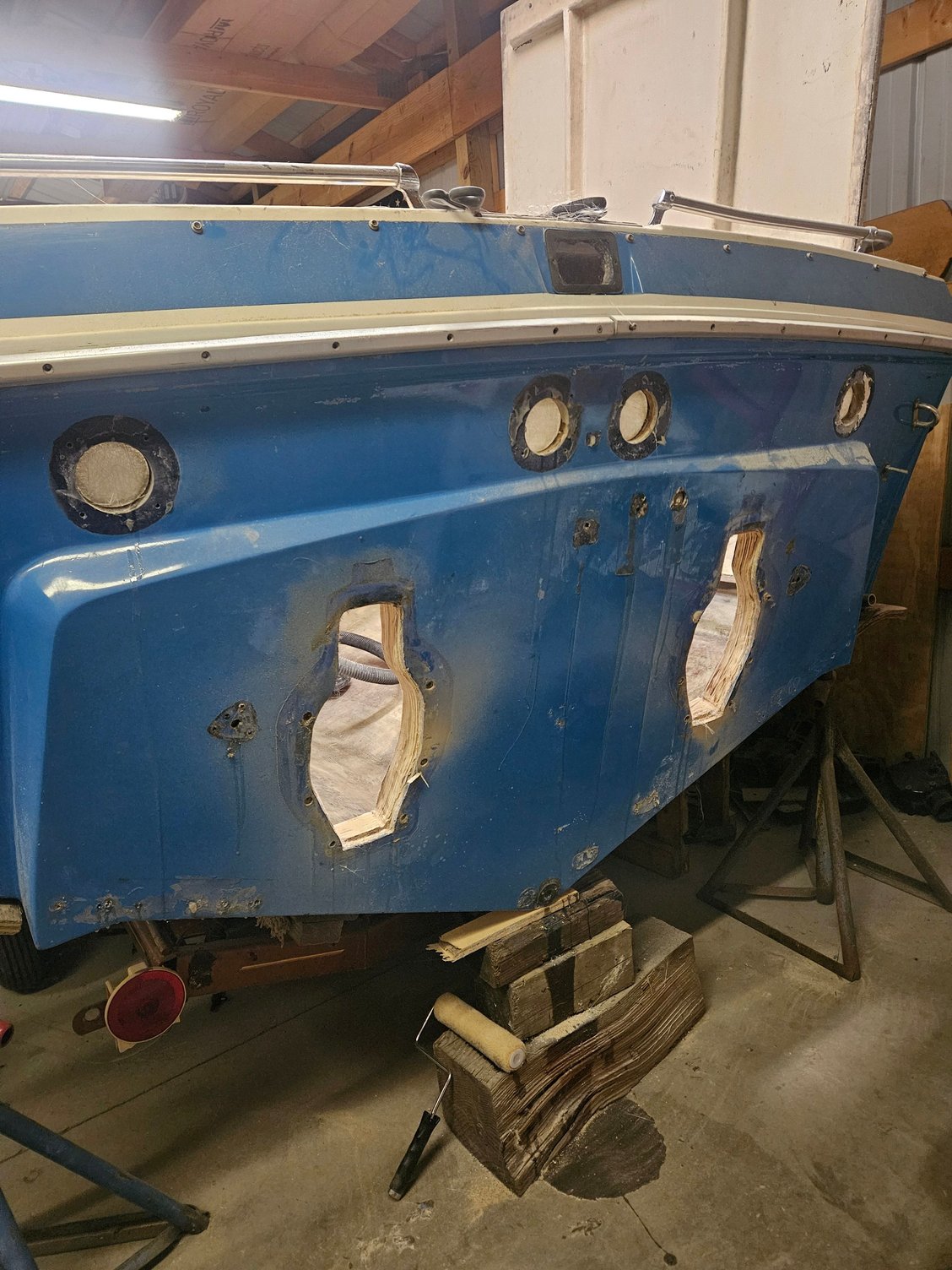

Drive holes cut and drilled, engine stinger grid made up, and engines set down!

These were originally volvo penta engines and I have been having a bit if a hard time getting them set up for the pre alpha mercruiser drives. I had 1 pre alpha and 1 gen 1 alpha 1 bellhousing that I thought were the same so I installed both, turns out the mounting holes to the transom assembly are different. Got another pre alpha bellhousing to fix that issue. Then I ordered an alpha 1 gen 1 coupler because the pre alpha couplers that I had bolt directly to the crankshaft bolt pattern did not line up. Turns out volvo Penta used the smaller 12 3/4" flywheel vs. The 14" mercruiser uses. Out of frustration i cut and redrilled the gen 1 coupler to fit the volvo penta flywheel only to find the bellhousing has 2 dimples in it that hit the coupler. Angle grinder fixed that issue, will probably weld some patch plates in when i pull the motors to glass the stringers in. I have now found that mercruiser used the 12 3/4" flywheel on some 4 cylinder engines so plan on ordering a coupler made for that.

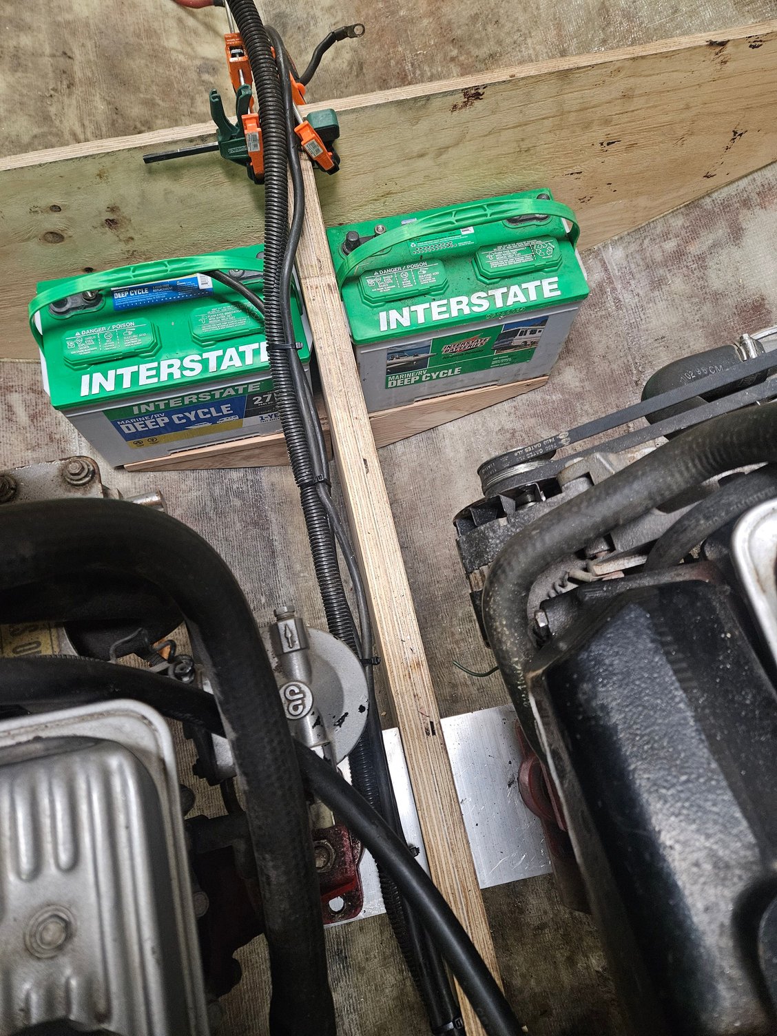

Made some battery trays and got most of the wiring done on the port motor. It turns over with the key and guages are functioning.

I am not a Merc guy but I noticed you have the Volvo crank mounted water pump are you going to use them ? Don’t the Merc legs have water pump impellers in them, normally vp legs don’t have those, probably ok to use both?

I actually plan on using the volvo crank mounted pumps and removing the impellers from the alpha drives. Not exactly sure how that is going to work, but as of now that is my plan. I figure I'll save some strain on the drives and make impeller change much easier.
