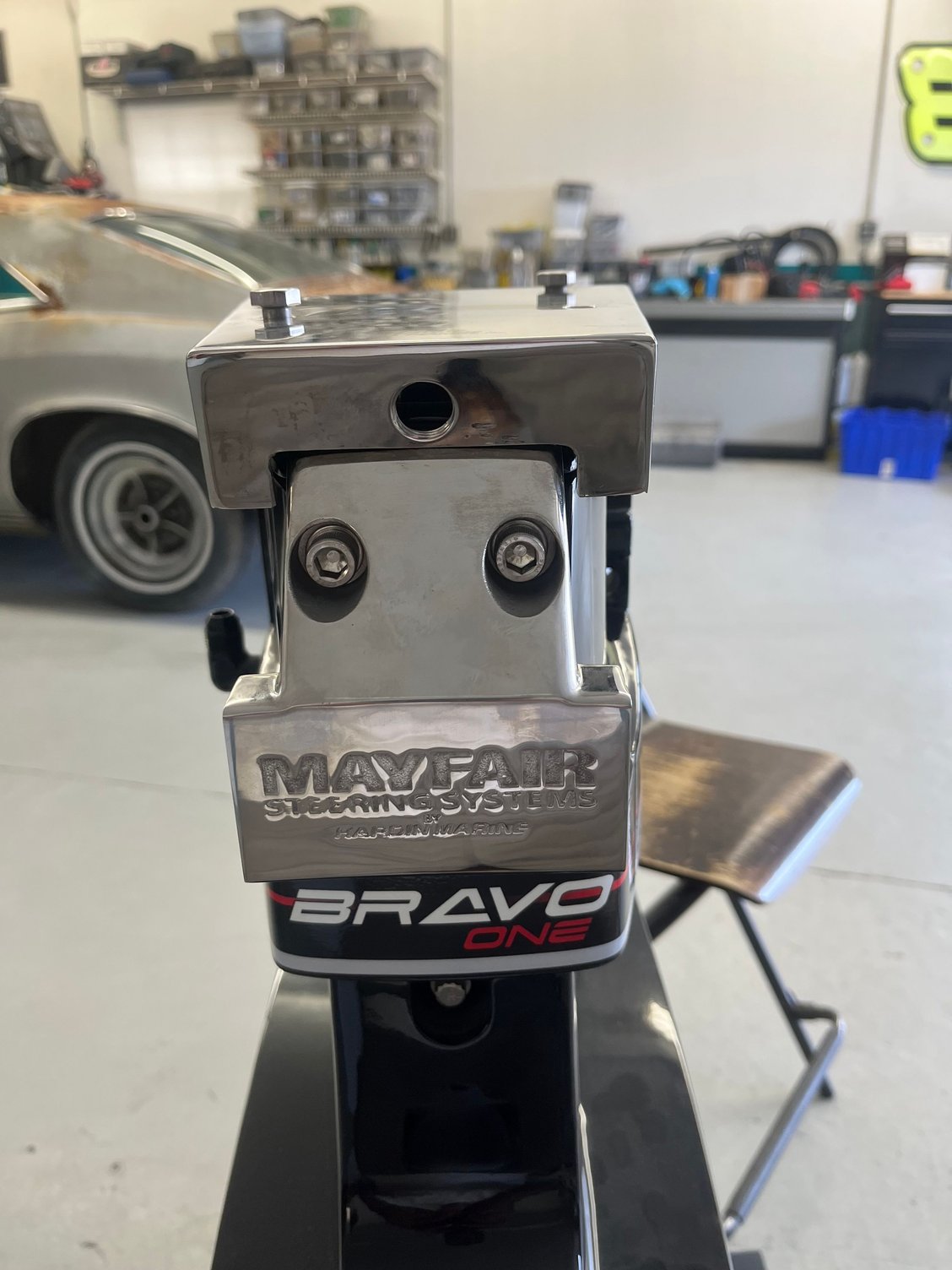

Old 11-16-2025 | 09:10 PM
Joined: Aug 2007
Posts: 29
Likes: 17
I got the eddie marine caps and cut a relief around the steering mount and it worked out great.
sunset bar is offline
Old 11-16-2025 | 09:13 PM
Joined: Jun 2021
Posts: 3,549
Likes: 2,146
From: SW Ohio
Sunset,
Have any pics from the other side?
Thanks. Brad.
Brad Christy is offline
Old 11-17-2025 | 10:50 AM
Joined: Aug 2007
Posts: 29
Likes: 17
Sorry for the teaser, that was the only picture I had last night till I downloaded these today.
