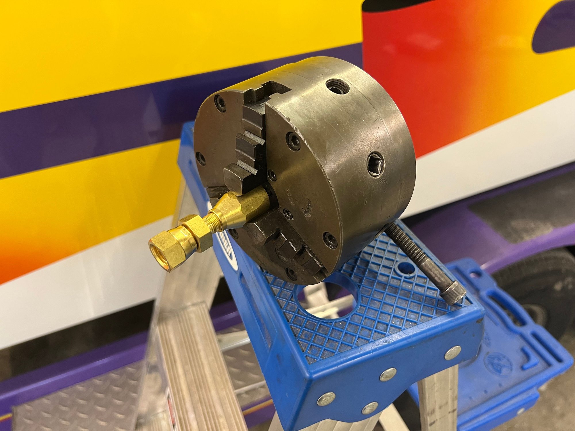

Originally Posted by Ryanw10
Personally I would not be installing fittings in the boat, I would be doing it in a vice. I have never used these fittings though so I do not know how easy they assemble.
Ryan,
Not gonna lie, it IS a PITA. I ended up taking a 4” lathe chuck up in the boat and using it to clamp on the ferrule. This was a LOT easier than the two-wrench method the guy makes look so easy in the video.
Thanks. Brad.
