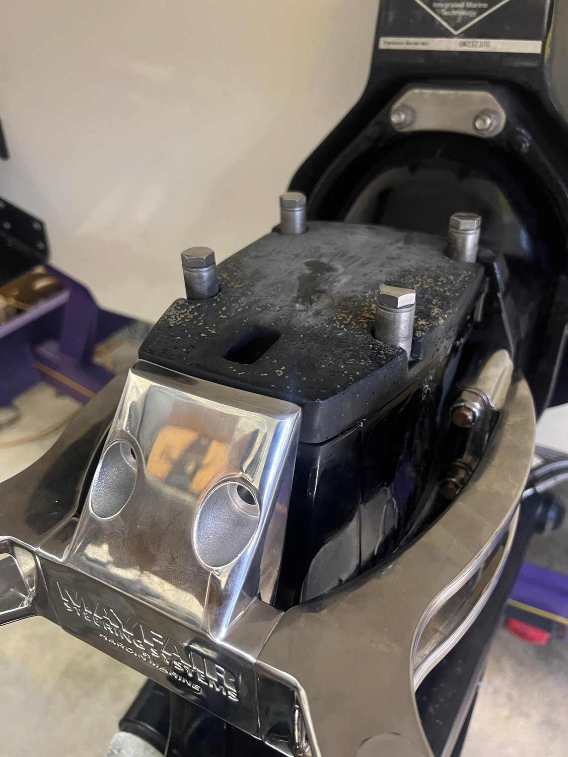

I already had to deal with the grounding washer that the Mayfair kit doesn’t take into account with the drive bracket mounting bosses. I machined 1/16” off the pertinent boss, to account for the thickness of this washer, and the bracket lines up perfectly.

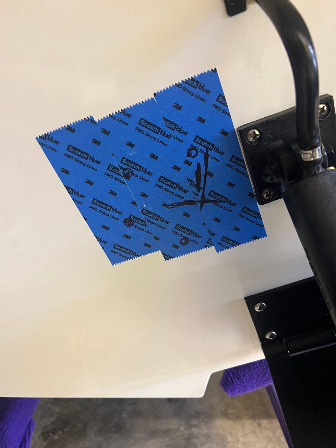

And the transom bracket bolt holes are marked. Pretty sure I’m going to have to cut away some of the floor panel that is attached to the top of the stringer on the side of the engine well, because, as best I can measure, that appears to be right where the thru-transom bolt holes are going to break through, and I’ll need some space for the washer plate on the inside. We’ll find out soon enough.
Any advice for a layman on drilling these holes without chipping the gelcoat? Specific type of drill bit? Learned techniques?

Also, I suspect that the reason the Mayfair bracket does not take into account the grounding washer, is that the bracket is bare aluminum and thus will be grounded to the outdrive when assembled, without the need for the grounding washer.

I believe the bracket is stainless; certainly feels considerably heavier than aluminum.
Apparently, the stud isn’t a reliable conductor into the helmet. If it were, Merc wouldn’t have incorporated the grounding washer. With that said, the bracket isn’t going to change that.
Machining an equivalent of the washer from the mounting boss of the bracket allowed me to keep the washer as Merc intended, and didn’t affect the fit and alignment of the bracket segments.

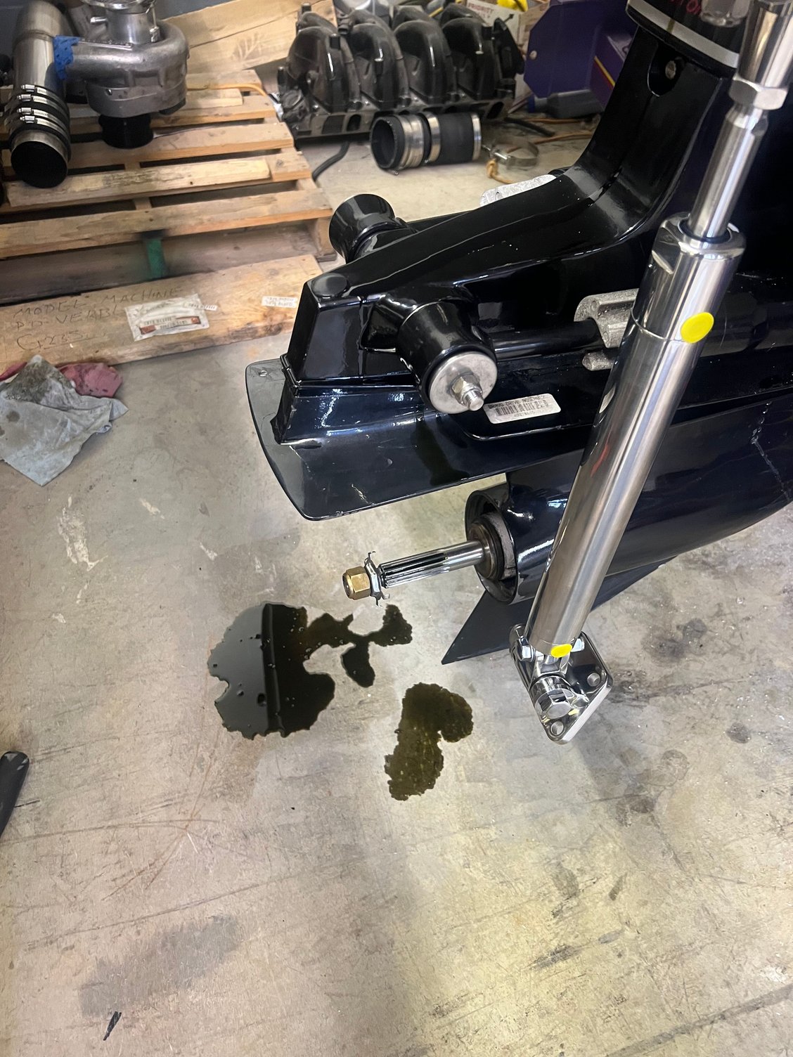

I had to remove the drive shower, as it’s in conflict with the rear plate of the drive steering bracket. And, I guess the lack of tension on the bolts lead to this:
Oops….
I guess my drive oil reservoir lines are flowing freely enough.
I obviously snugged the bolts down and wiped up the mess.

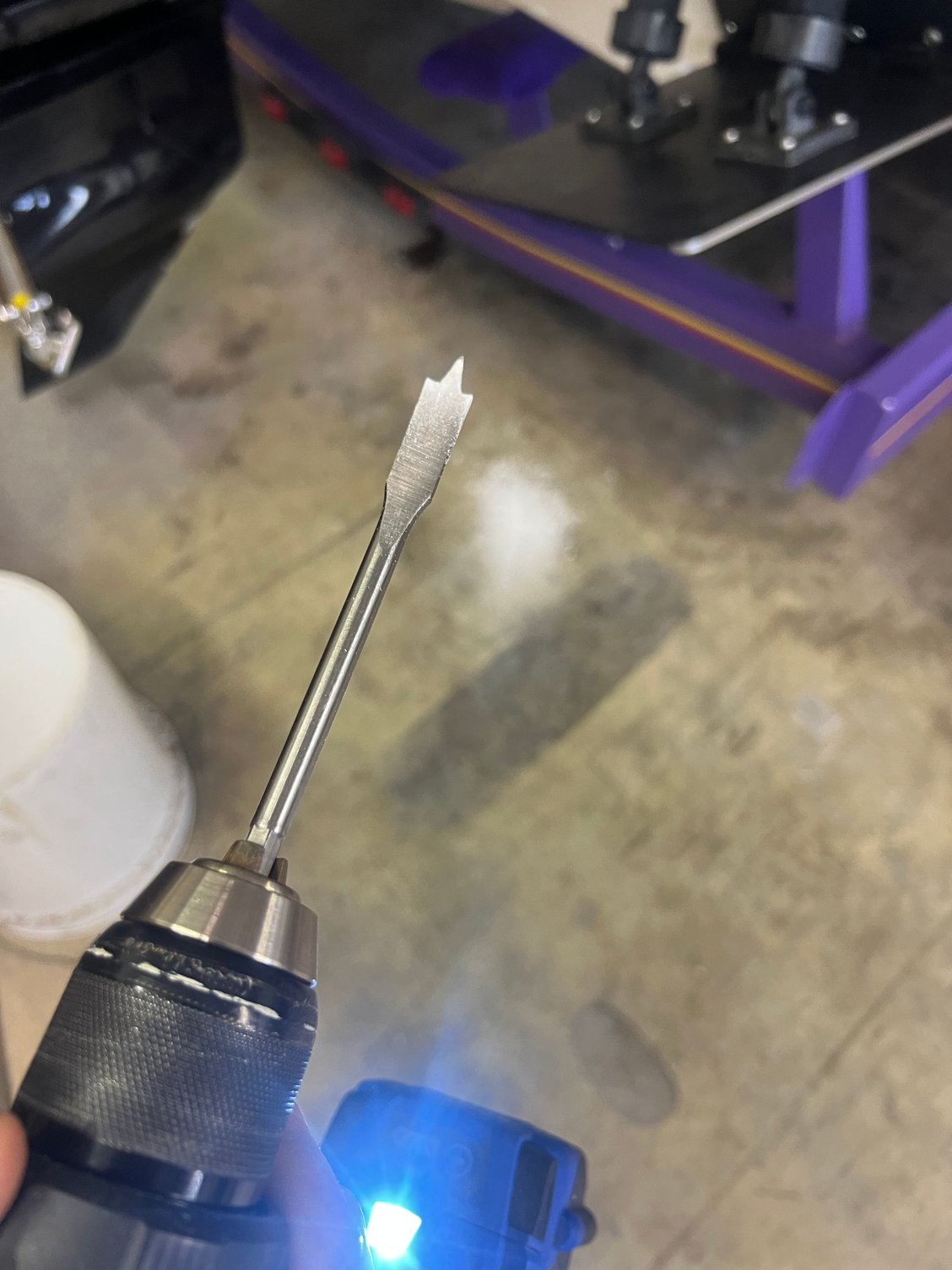

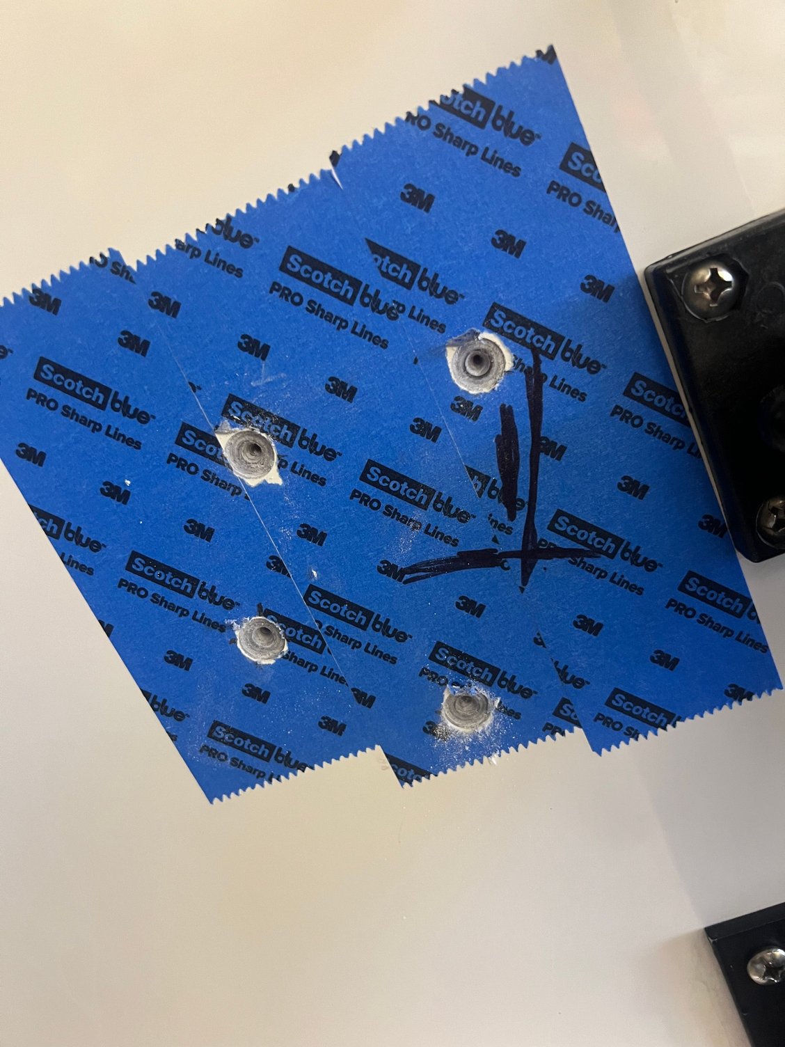

I used a 7/16” speed bore to spot face through the gelcoat without chipping.
Worked great. Next, I’ll use a drill guide to drill through nice and square with a 13/32” drill bit.
