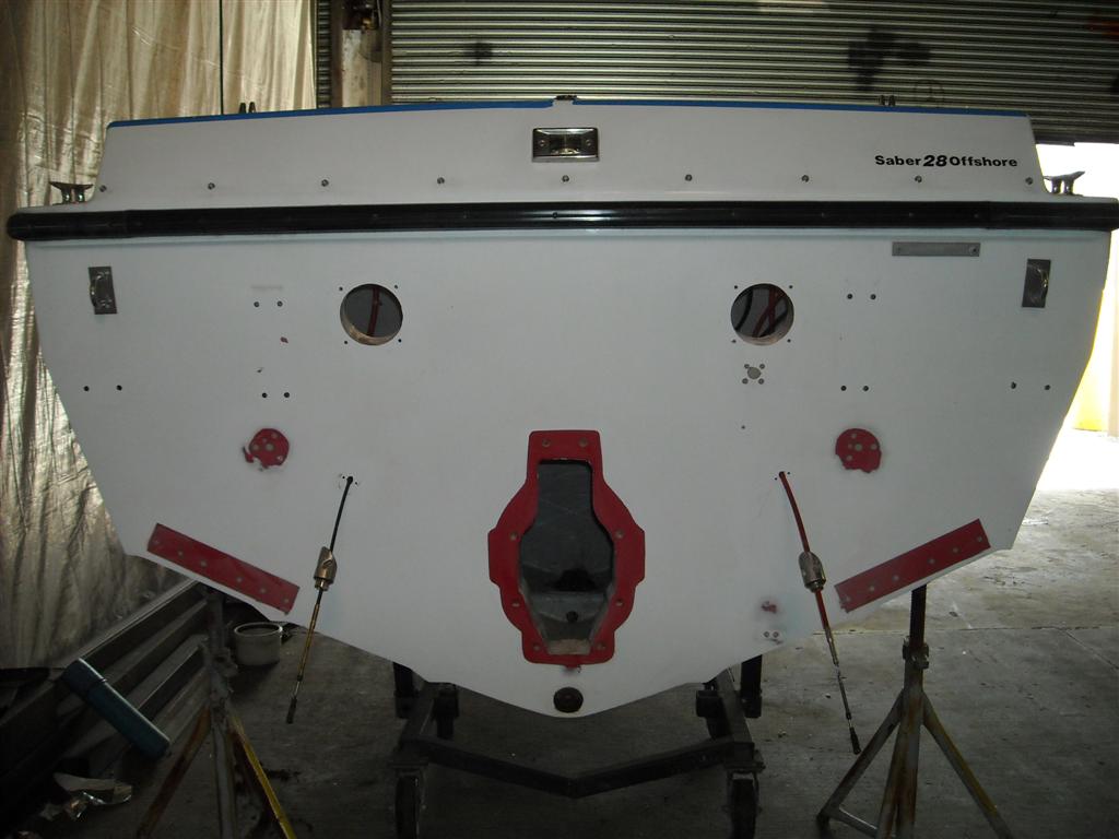

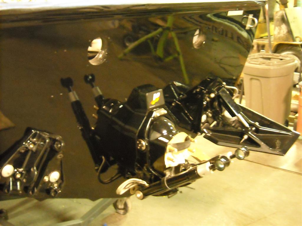

SABER 101 I stole Gerrys 101 haha. well I should of taken pics last oct but forgot ,it would of been nice to show old trans cut out and new. so tomorrow I will show pics of transom with gimbal and box on. and will show parts going in to this a lot I figure 6 weeks from friday I should be in the water. we are picking up new motor friday from Gellners if the dyno does not break it
. so I should have picks of it on the dyno no later than tuesday to post. what will take the longest time will be header tails was told about 2 weeks praying for that. 1st we need to set block in with heads blower might be off for ride home it will be in a van. once we get it lined up I will send pipe print out. all holes where filled in transom. but since motor is raised 3'' I don't know if straight tails would hit hull deck joint
thats why we have to wait. once thats done we have coolers to find a home pulleys to check and see if gas tank is in the way that all falls in my 5 to 6 week plan. IF NEEDED GAS TANK WOULD BE remade with a L shape so part would be under back seat and part would be back in bilge. I would go from a 90 gal to a 120 I think it comes out to. or but to 60 or 70 gal saddle tanks on both sides of motor. in the fall after getting run time I plan on selling the bolsters a long with my new red ones from my baja if its too much money for PPI TO MAKE EITHER PAIR a little taller mine, wider on saber seats and taller on them with the in out look which I have on my red ones which I paid almost 3grand for. ppi said if I buy theres like I want 4 grand
, so I would have to get 2grand for my red ones and 1500 for the silver ones, or see if he can do mods on one set seat only for a grand they need pics. I am doing this cause I have had a bad knee replaced, getting shoulders done and have 5 disks that can't be done or no boating or rough housing at all. also will mod the dash area to cut out and box in place to put your feet so you can lock yourself into the seats. also until I get the motor in I will not know if a race scoop will work or if I need to build a box scoop for the hatch which I did in the past thanks to MRV8OUTBOARD jeb

Artie, with all that power why raise the engine? Is it for the X dimension? If that is the case leave it lower in the boat and use a stand off box. The center of gravity with all that torque will be critical for handling. Also put it as far forward as you can. Then 380's mounted flat and it should run like it was on rails.
well just made plans for ohio will be there friday afternoon, motor was broken in today with low boost made about 950hp, tomorrow will run again on pump gas 1st them a mix so it should make about 1100 plus on mix and 1000 plus on 93 and might run straight race to see what it has. so for playing around I will have a low boost pulley and a pokerrun/ race set up and then a kilo set up

, with the new x jeb it will have gone from 14'' which was deeper than my baja to 17'' or 17 1/2'' which is what most of the hp single boats are running on average 17 to 18 1/2'' now that 4 and 5 blades are out and around. it will be at what konrad wants the prop shaft at 3''. it has a konrad box two. if its off and it seems to high I can lower the motor over the winter move box down a 1''. but I think lt will be fine . I should have pics tomorrow. I will start a lil thread tomorrow road trip adventures with party arty on GD
