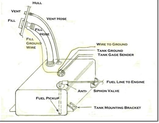

Question on grounding the fuel neck hose, fuel vent hose and tank. Do I ground everything back to the battery? Does the tank need to be grounded for the sender to work?

I've never heard of grounding the filler neck and vents - my sending unit has its own ground but you should also be grounding the tank itself. It depends if your fuel level sensor uses the screws to transfer ground or not, I always feel its best to ground it out directly though. Just one less thing to fail

You ground the fill to the tank for static electricity purposes.

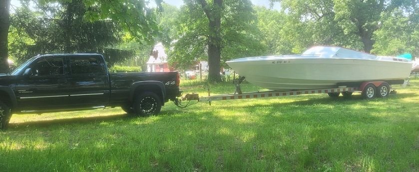

Well, after almost 2 years without seeing sunlight, the Panther is out.
Now on to the gas station to put ~35 gallons in her and see if she holds.
Just realized, this is the first time I have had it hooked up to my Duramax. Usually towed it with my 1/2 ton GMC or my 2500 Avalanche.
No leaks, no smell of fuel and she fired right up. All trim switches, and everything works as should, besides the fuel guage. smh...
