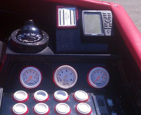

Last weekend I finished up adding a little Garming GPS, drive and trim indicators. I ran out of dash room so I bent up some Acrylic and mounted them under the fairing. I will redo this over the winter and I will probably end up removing the compass.
Love it man!
My compass went this summer when I needed a place to mount my custom heads up indicators! I like them but already working on small LCD that will display the indicators instead!
You got to love all the little projects we can do to these boats to improve fit, form and function!!
