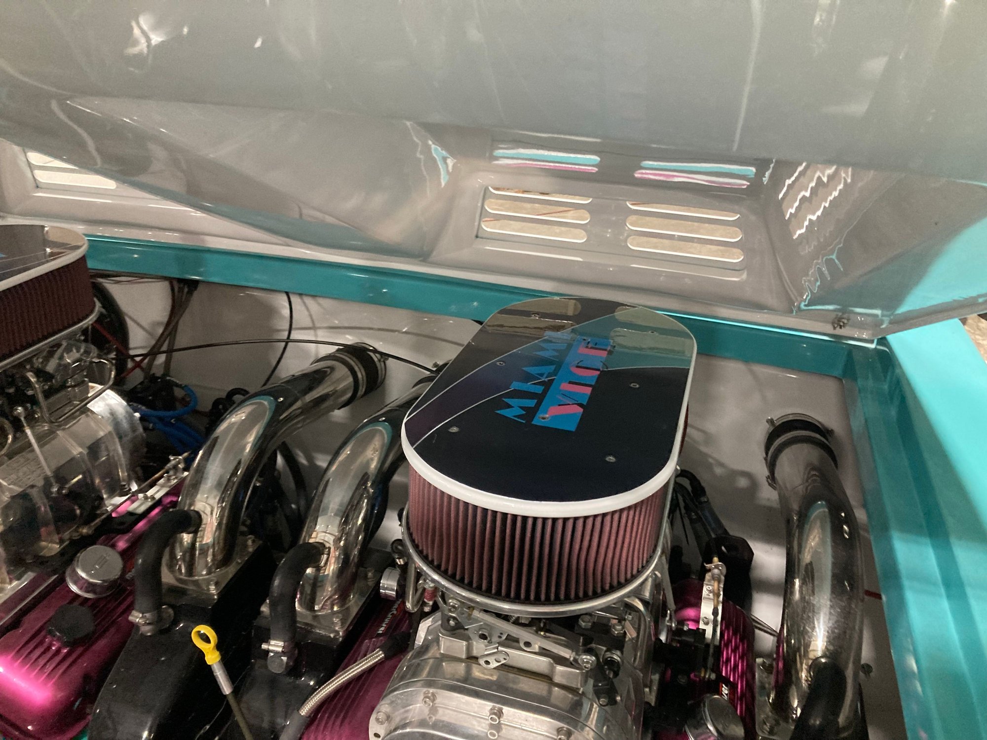

I’ve been doing some wiring the last few weeks, got the instrument lights wired in. During the spied run a few weeks ago, we experienced more vibration than with the 5 blade props, I noticed a few engine vent screws had backed out. Also noticed that the locknut on the port steering linkage had backed off 2/3 of the way. I put that back together with the help of red loctite. I’m sending these 4 blade props off to try to get a little cup or pitch added and get them balanced and polished. Also letting the port motor down 1/4” as the spark arrestor has been making contact with the hatch. It clears if the hatch is 1/8” above flush with the deck but that bugs me so I’m letting it down.

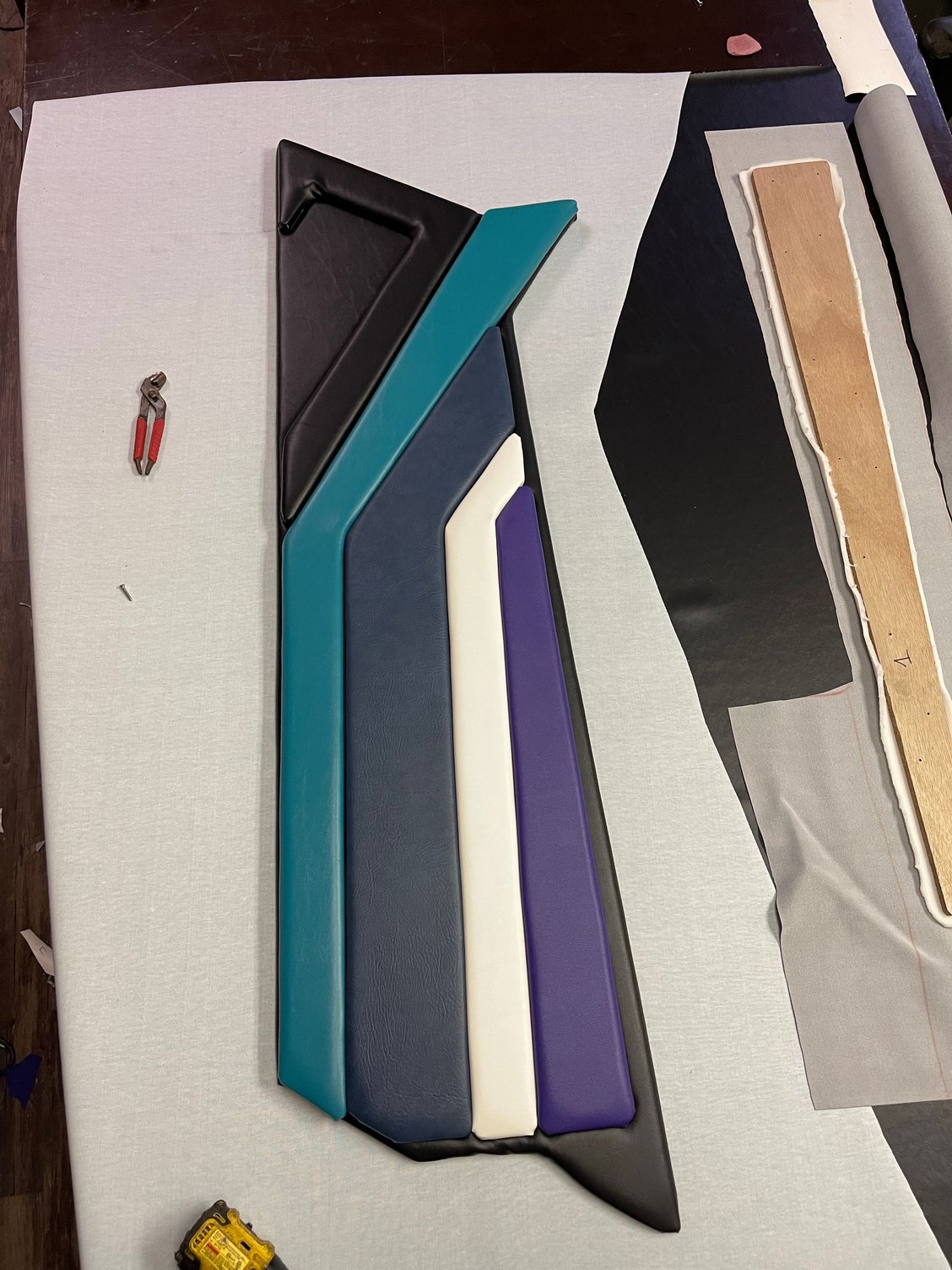

I’ve been busy with other things the last month or so. Winston painted the uhoh on the spark arrestor a while back. I sent the props to cool breeze props at Loto. He balanced them, added a little pitch and polished them. They’re just about done. Upholstery is coming along. Here’s a photo of the starbd cockpit panel…
