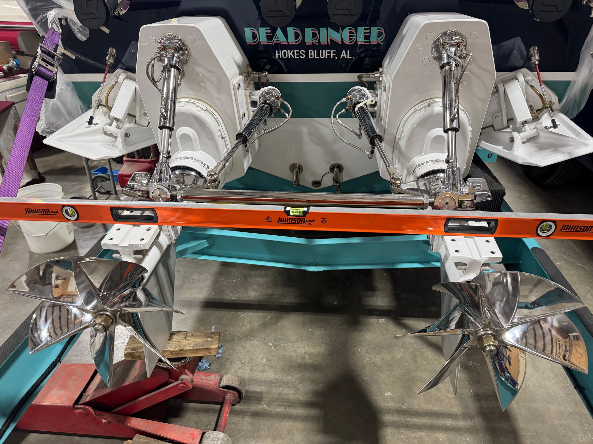

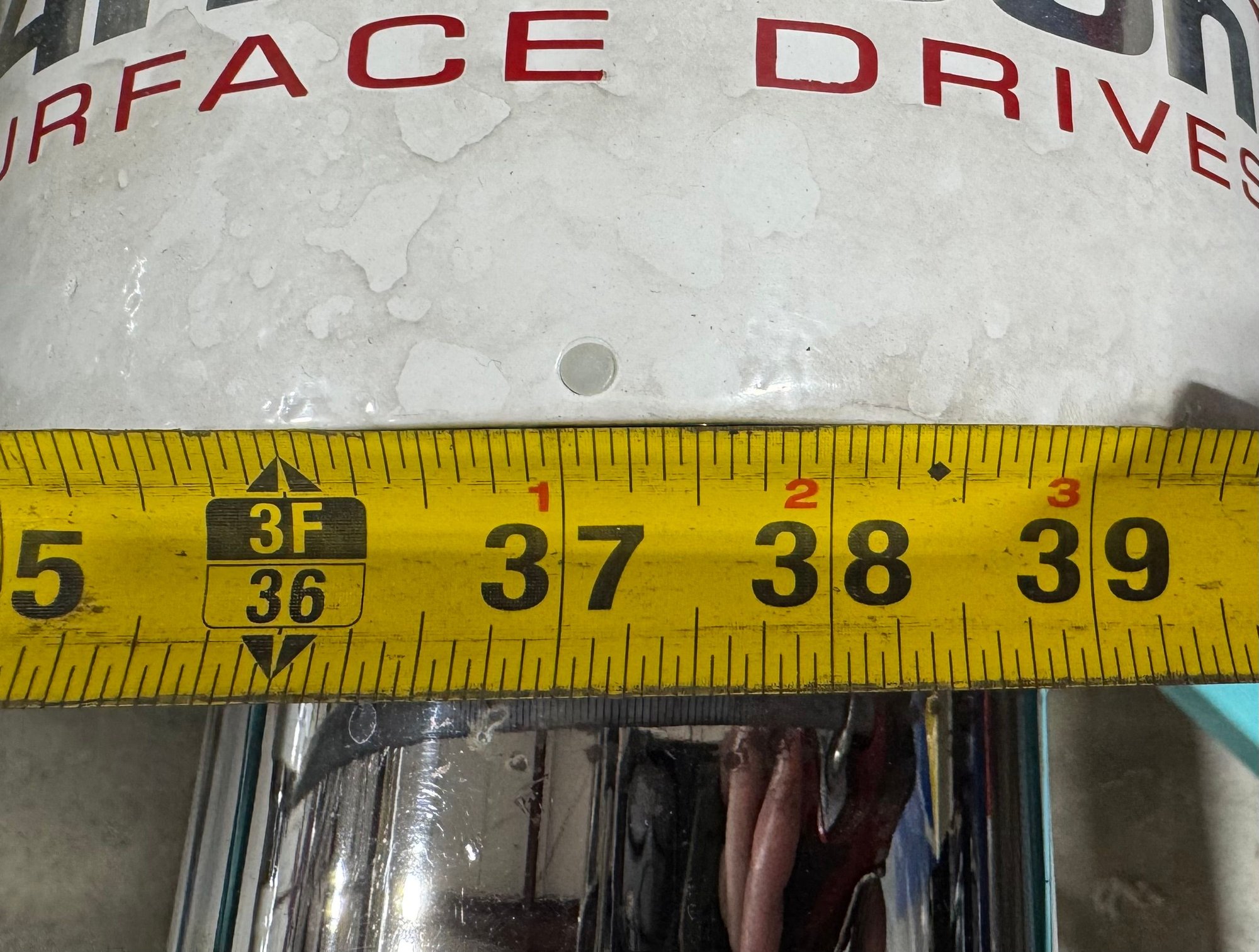

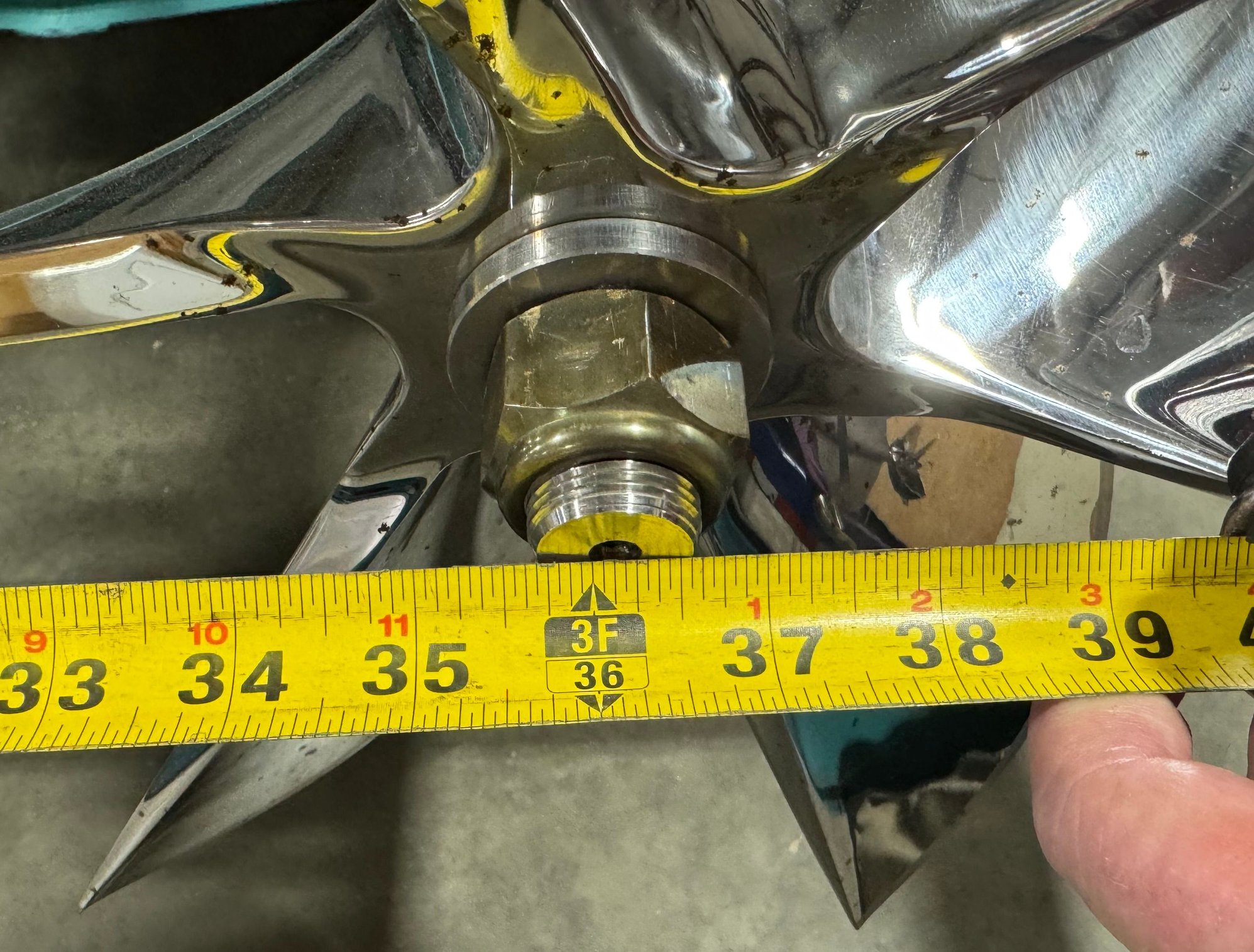

The boats covered up for the winter now in the building next door. Walking by it the other day I figured I’d check the “toe” on the drives just for kicks and giggles even though I’d already checked it. Turns out I had set it exactly 1” too far in. Woops. It’s been like that for two years.
Maybe with that set correctly, left engine ignition timing advanced slightly (I think we may have left it slightly retarded as it was a little low on power when we laid into the throttles back in early October), and a little choppier water conditions, we’ll be able to get 90mph out of it, making it one of the faster slow boats around lol

CheckmateScarab 11-28-2025 05:14 PM
Since they are spinning in it is most likely even more than 1" when loaded, negligible id bet. Great catch, it's always the small things

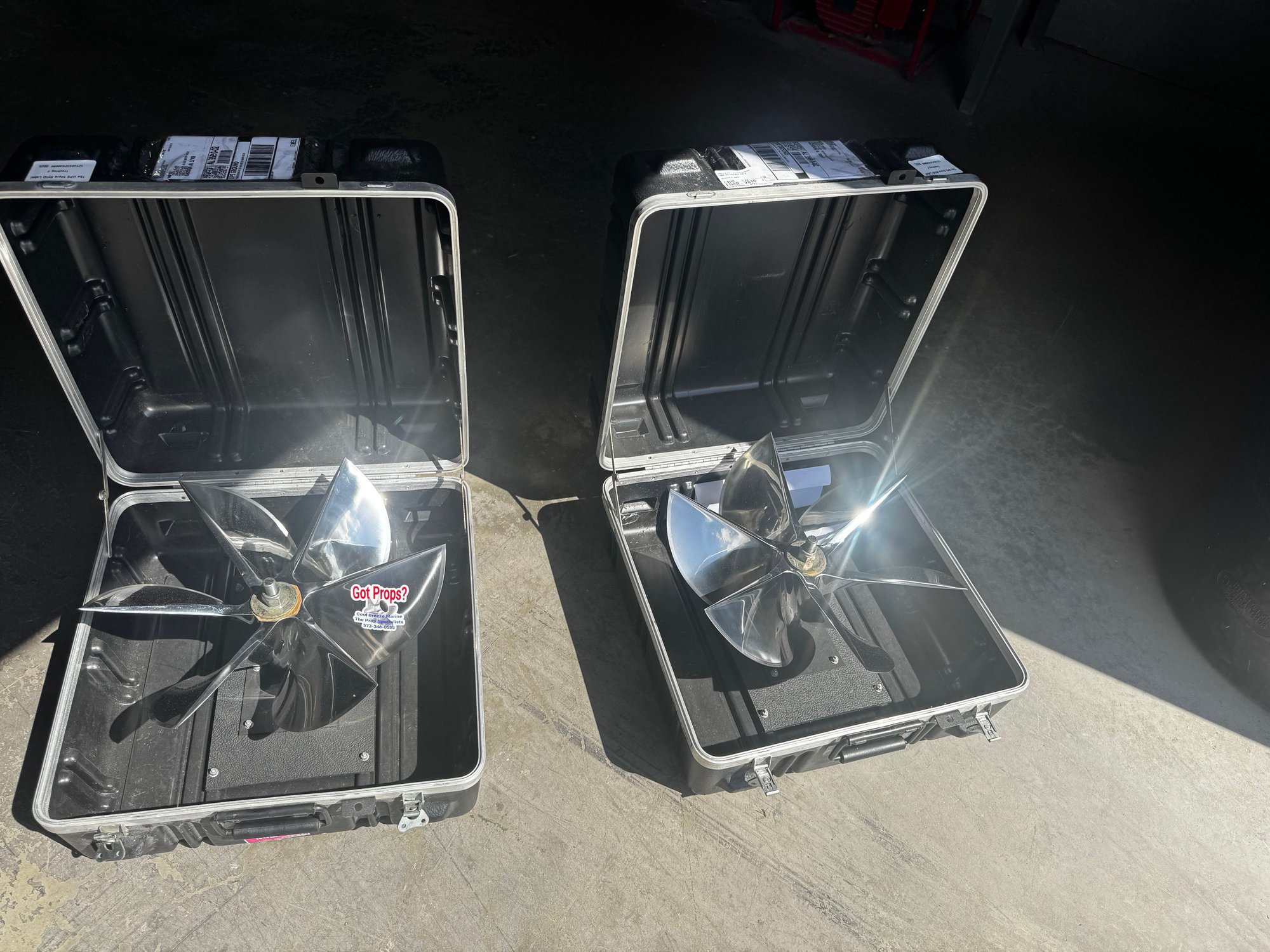

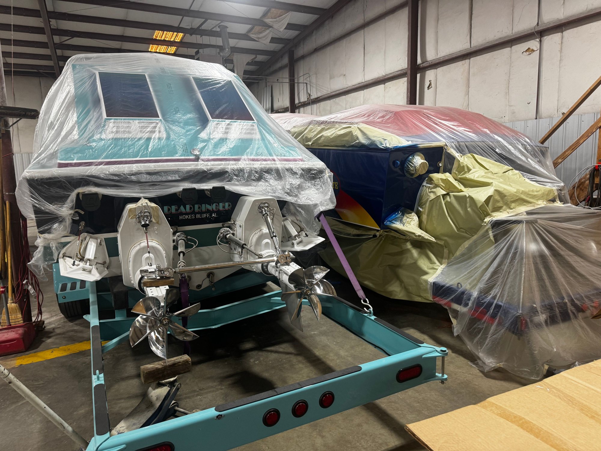

hblair 03-12-2026 09:56 AM
Boats been in hibernation here next to Kelly Cooks Cigarette. Props showed back up yesterday from Cool Breeze at LOTO. Waiting on a trim cylinder from Arneson for the left side. Few things to do and she’ll be water worthy. Looking forward to being on the water this season
