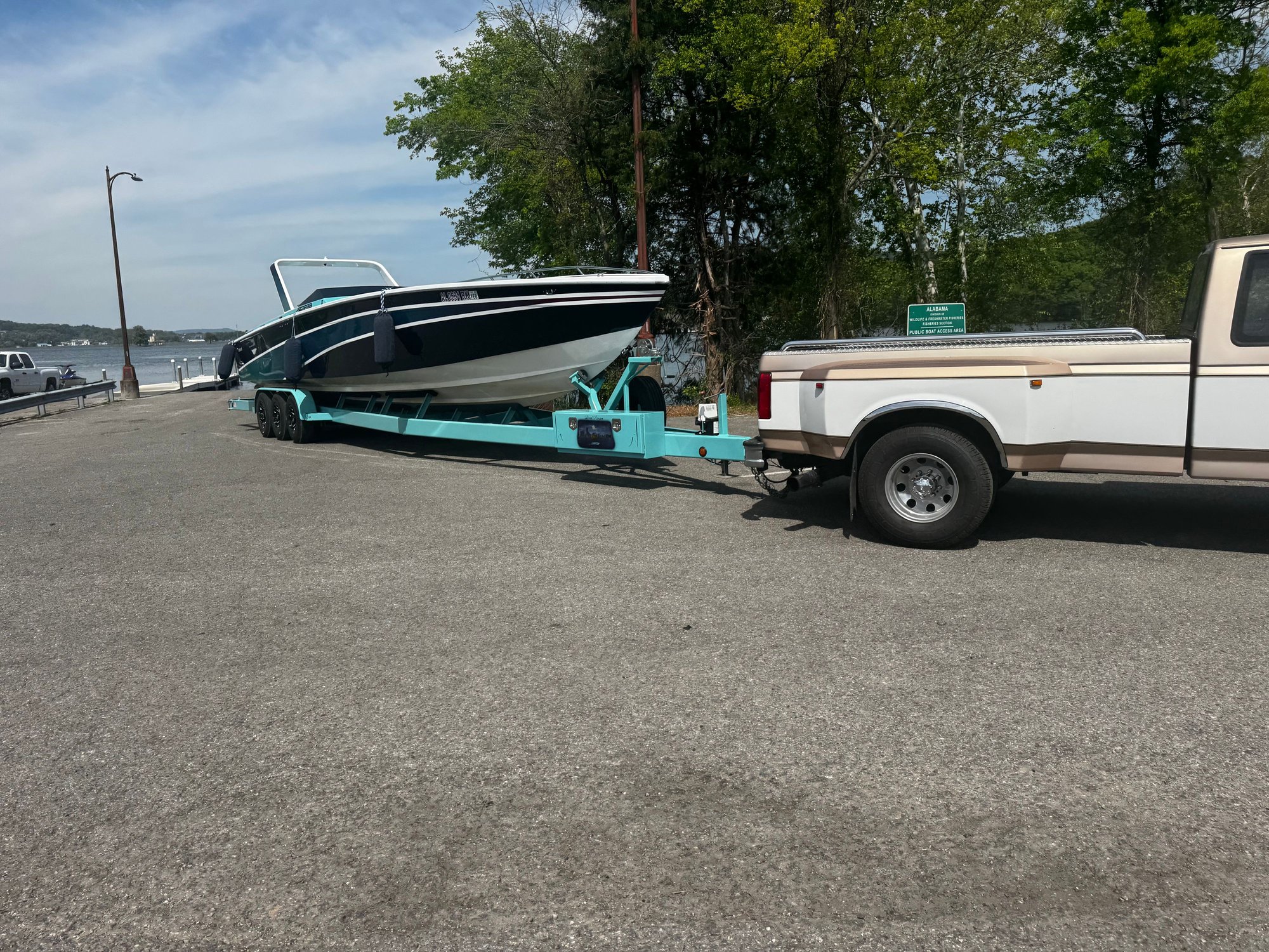

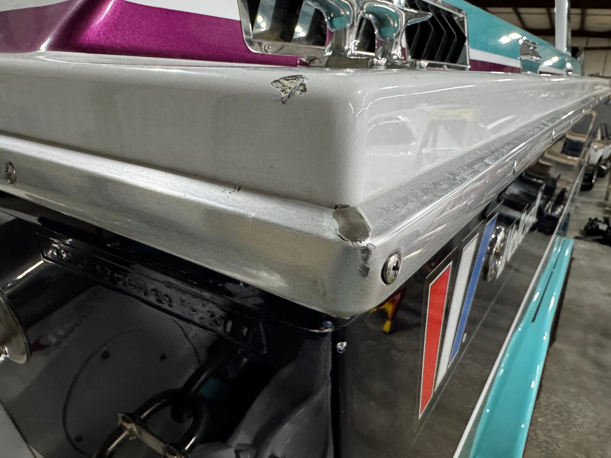

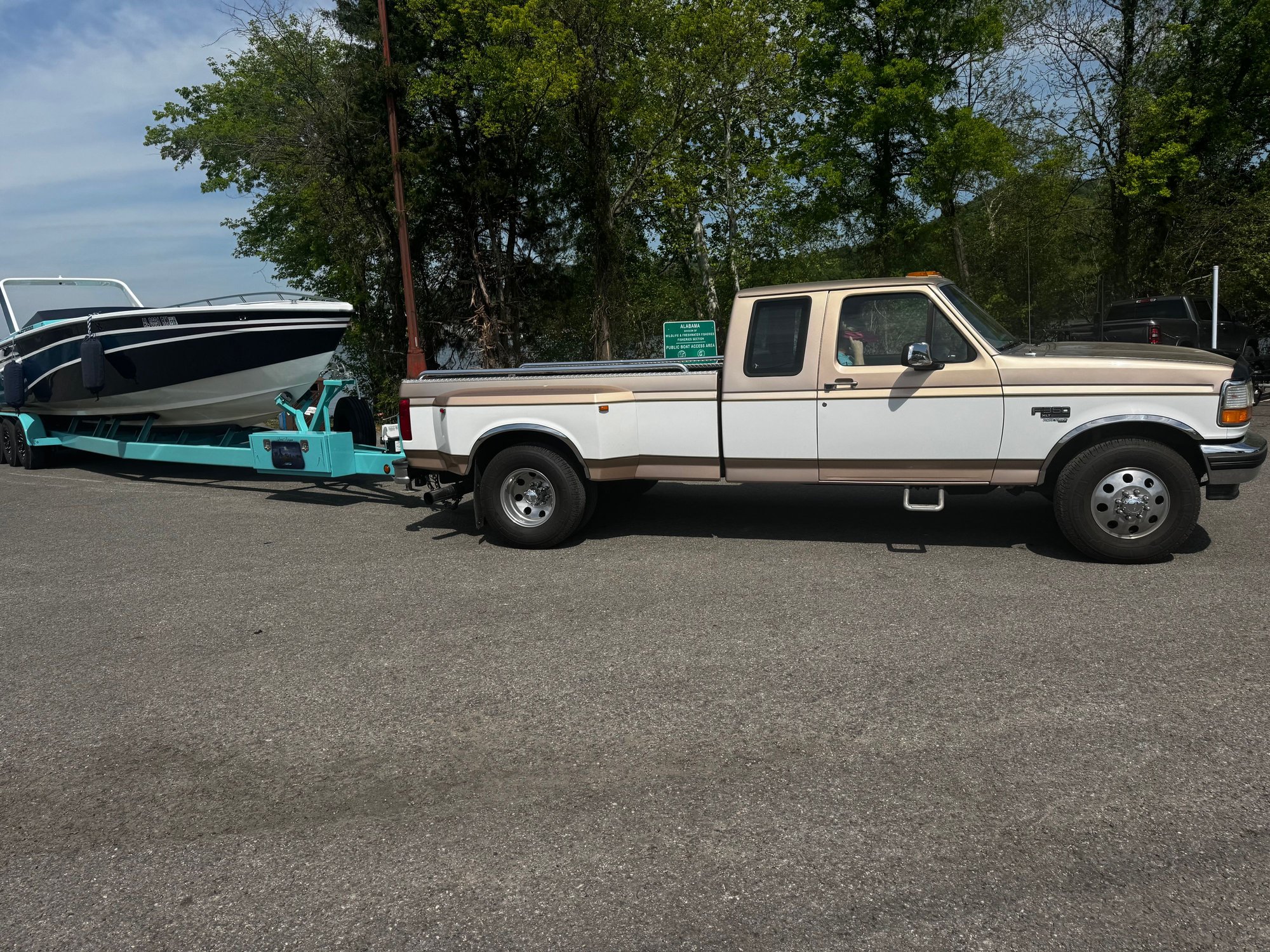

Trim cylinder worked perfectly. I don’t have a photo of the weld on my phone right now. Sarge painted a mural on my trailer toolbox. At first I wasn’t sure about it but I’m all in now. It’s not honkin loud but it’s pretty cool when you look at it closely. It took me a while to figure out these 17.25x37 props require 4400 rpm to get on plane. They’re really a little too small a diameter for this application. Some 6 blade 18x35-37 would prolly be about right.
We ran the boat yesterday and today. Burnt over 100 gallons of gas. We went to Guntersville today. It was very windy and I had an uhoh against the dock at city harbor. First real paint damage to speak of. After my initial reaction I wasn’t too upset. Yeah it stinks but I know somebody who can fix it.

jeff32 04-12-2026 08:36 PM
Glad its all running good! Enjoy the ride!
Wildman_grafix 04-13-2026 07:25 AM
I like that you use a OBS to pull it!
Helmwurst 04-13-2026 08:38 AM
I hate unprotected docks, not too bad though. Love the tow truck! My dad had one that was all white. When he passed, I sold it to a friend of mine that owned a transmission shop. He drove it until he passed. I Lost track of the truck.
rak rua 04-13-2026 08:55 AM
Love the mural, a nice touch.:)
(lucky you know someone who can fix that little dock incident….haha)

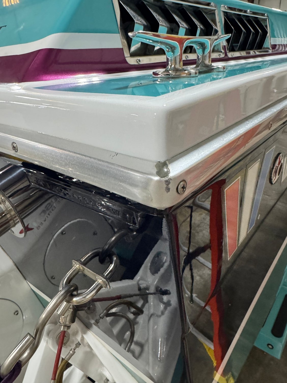

hblair 04-15-2026 07:04 PM
I bought this truck in 2017 for 8000, had about 175,000 on it. About 250,000 now. I have zero desire for a new truck. My upholstery guy is recovering some leather King Ranch leather seats. The old trucks like an old baseball glove, now it’ll smell like one. 😀
hblair 04-15-2026 07:09 PM
Winston repaired the white and sprayed it. We just stayed in the white. Broke the clear on the stripe edge. On the blue I mixed some clear with hardener with the blue base and brush touched it
