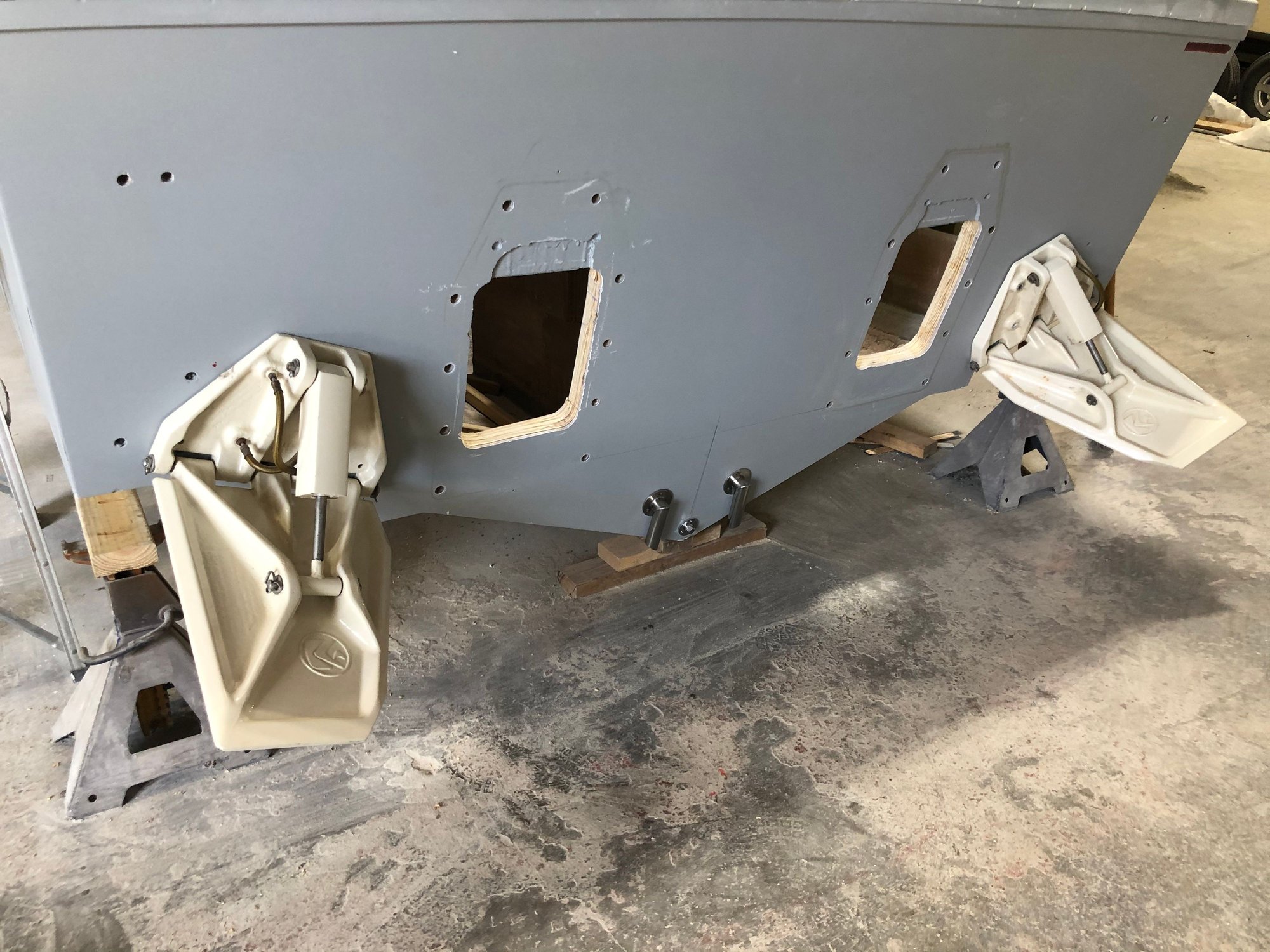

Thanks a lot guys. Yeah I’ll be sticking with the ol Miami Vice theme. I’ve had this boat 4 years this month. It’s been a long time coming. Jeff I have a Hutchins hustler air file that sands fast and does a good job but you just can’t beat a 30” long block for getting something this big straight. Only problem is it kills you lol.

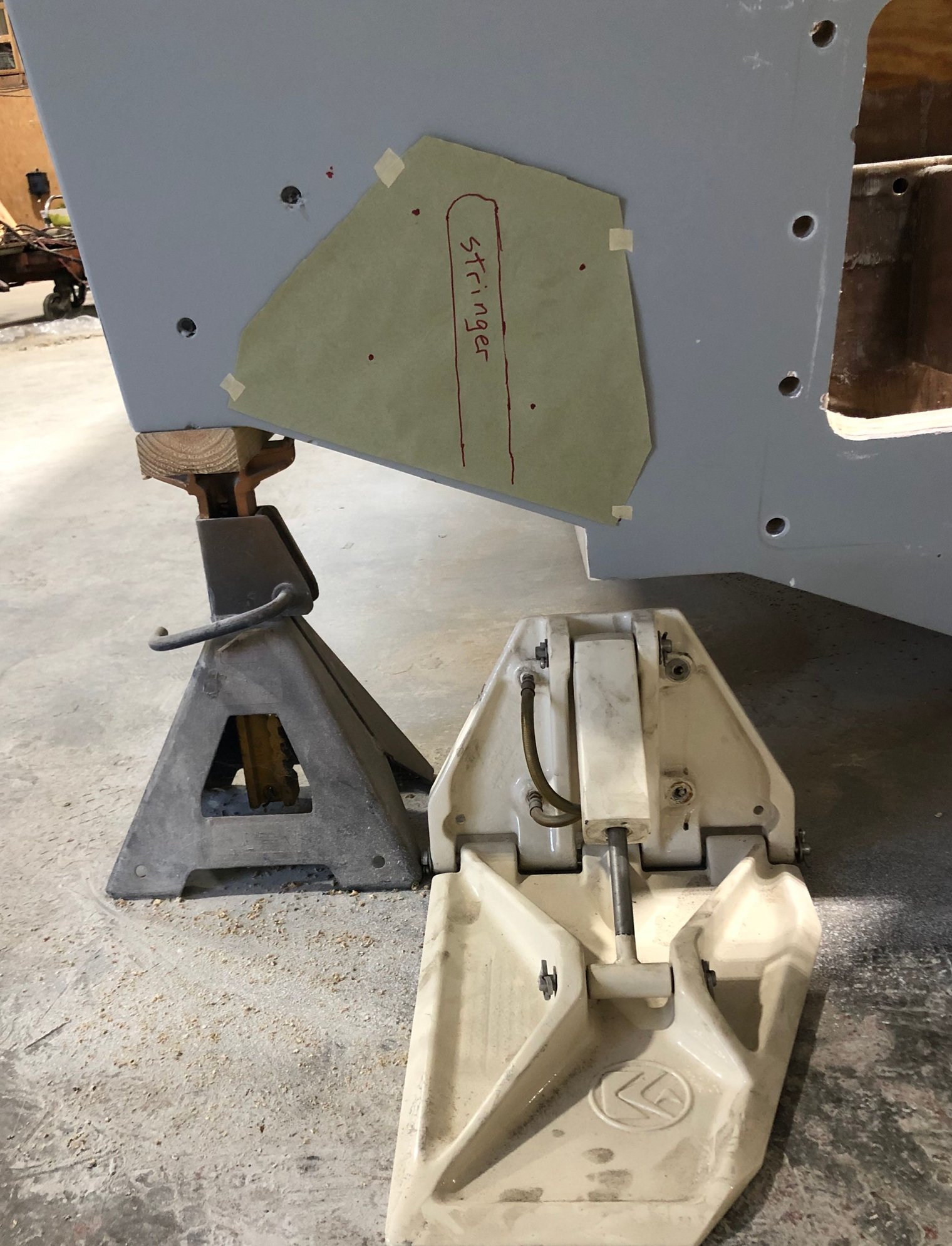

Billy’s got the instrument panel masked for polyester tomorrow. I’ll be using the k planes off my 30 footer. The original ones to this boat have the external hoses that go thru the transom and look like they could be a source for transom rot later on. I’m gonna be super careful and miss the stringer when I drill the holes. I’ll have to glass up the old outer holes from the previous k planes.

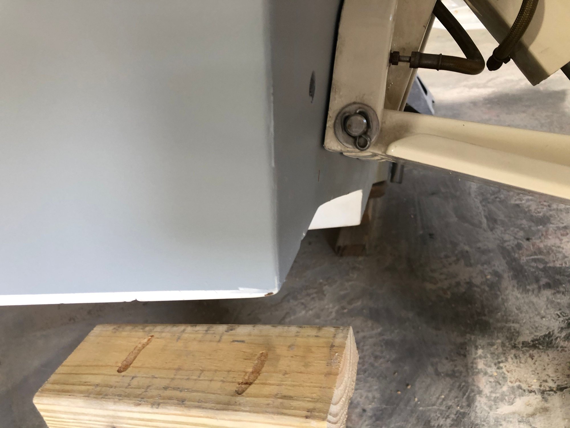

If I remember correctly, the k planes installation manual recommends a space of 3/4 to 1 inch spacing between the bottom of the hull and the plane but I must check if I have a copy lying around

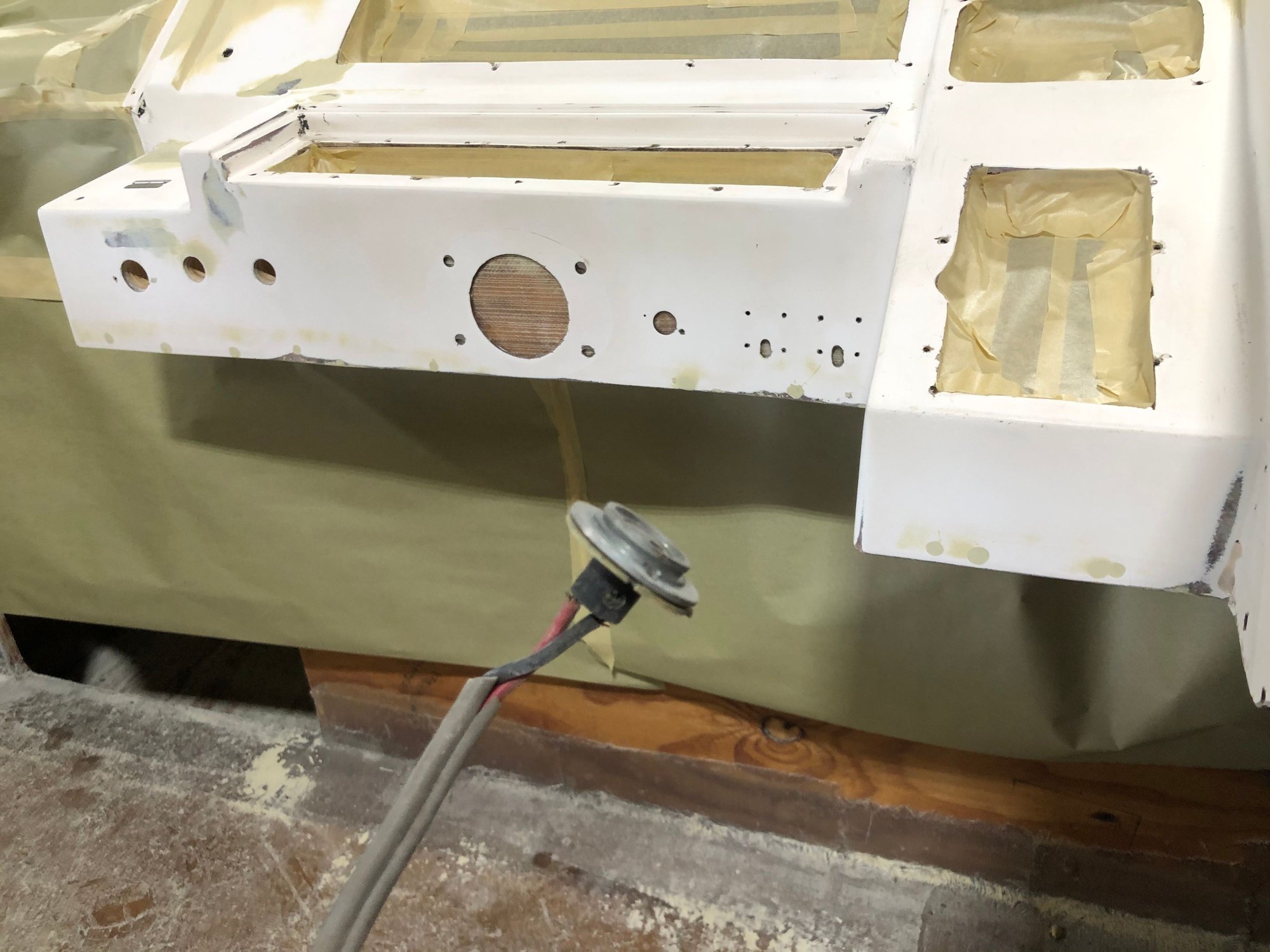

Looking at your helm, the face the steering mounts, I see the holes for the ignition switches, the holes for the kill switches, maybe a cigarette lighter hole but what's the other one for?

Good eye Andy, that’s apparently a 12 volt accessory port for something (don’t know) I’ve been meaning to fill in for 2 years. I’ll do that later. I can’t find my cigarette lighter port to save my life (after I hole sawed the dash for it)

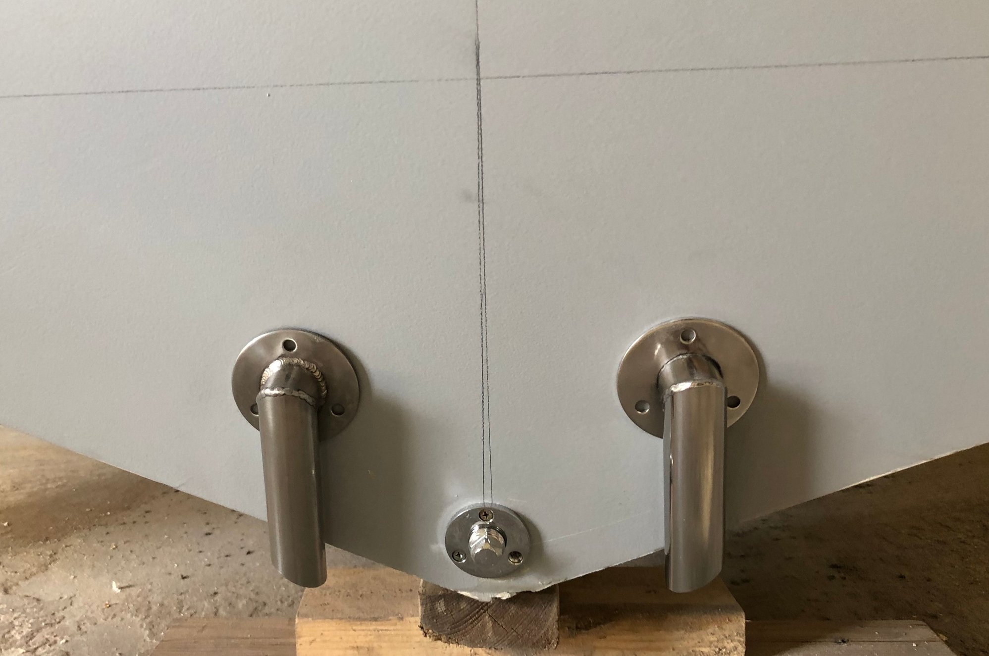

I drilled for and fitted the k planes, little over an inch from the bottom. Also drilled and fitted the water pickups Dan Mcnamara of team archer gave me a while back. Thanks Dan. Also fitted my pretty pimpin bilge drain. I’ve still gotta purchase a few pieces of hardware for the exterior like the bilge dump and 6 of the stainless vents.

Polyester on the instrument panel.
