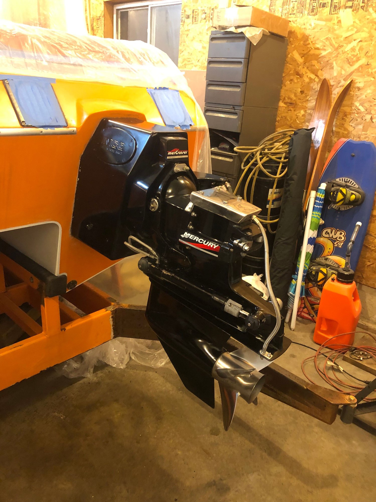

From: Zeeland, MI
Got the drives off this weekend. Still waiting on the arrival of the Arnesons to start mocking things up. Have to get the trannies down off the shelf and see if they have been upgraded yet or not. I think that the old holes in the transom will need filled as I am assuming the Arnesons will need mounted closer to the bottom of the boat. I continued sanding the bilge down this past weekend and got some good advice from Jim Buddy for filling holes and what not!
