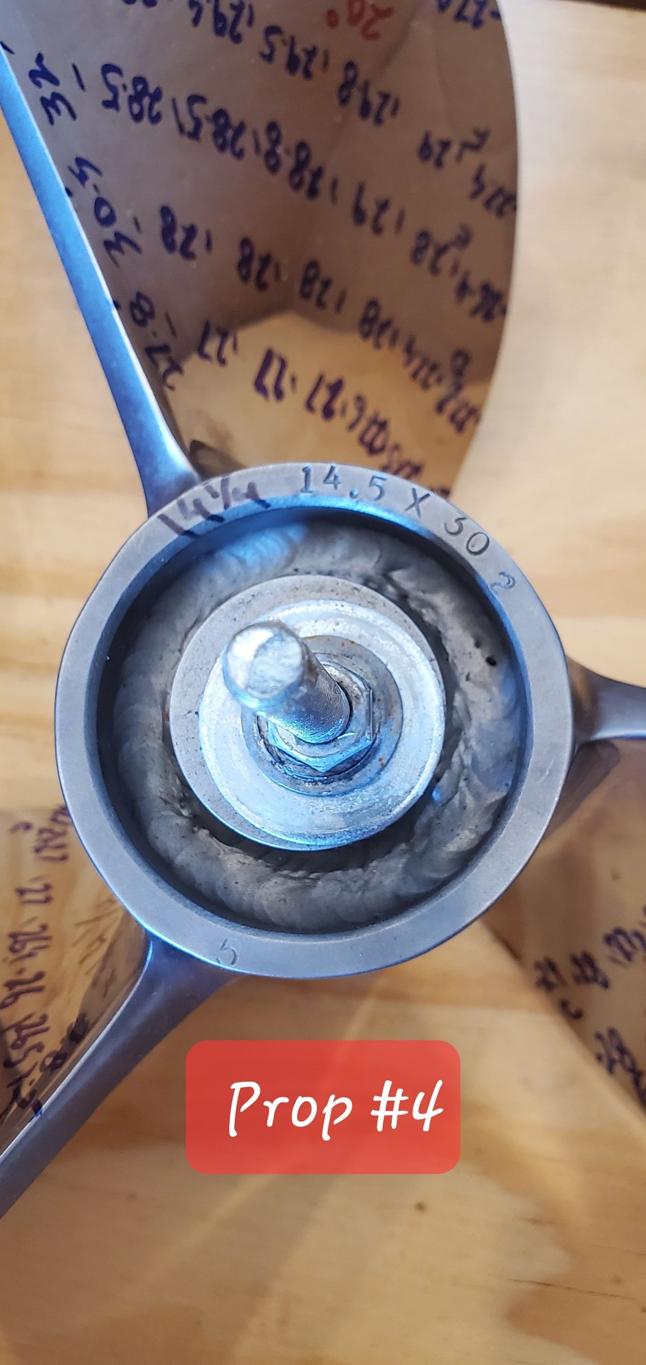

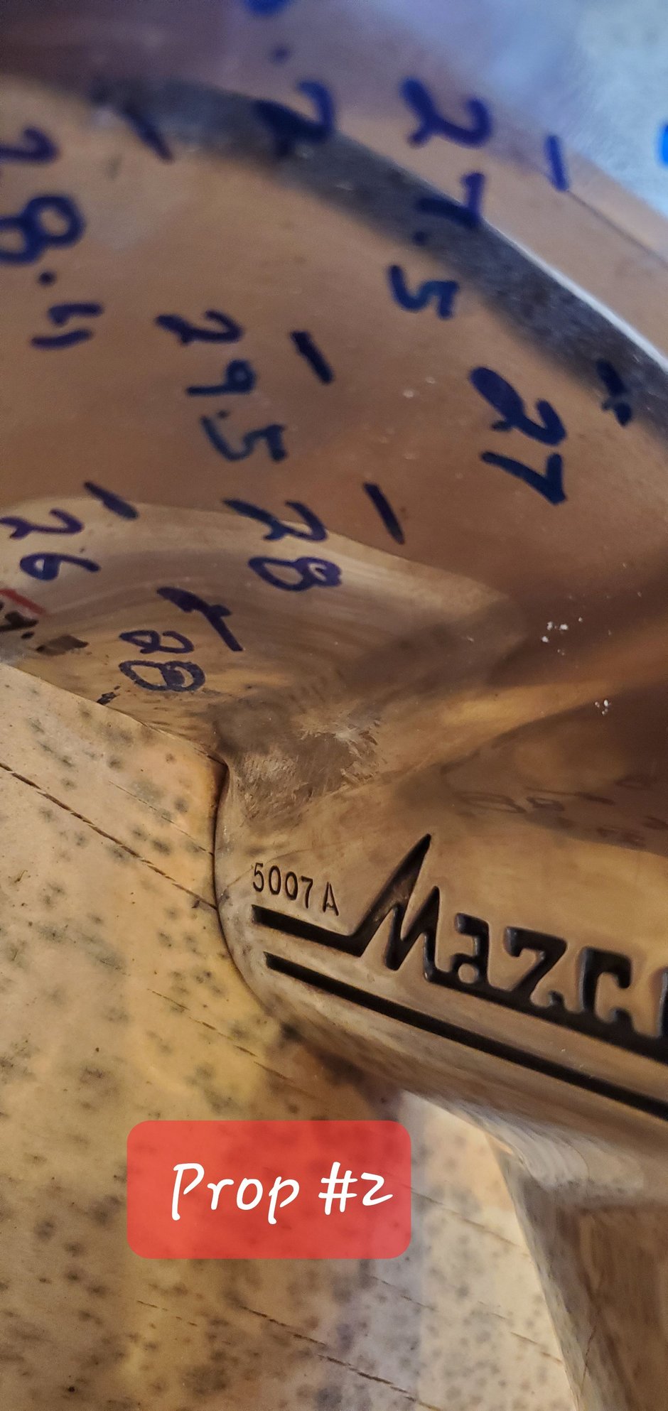

This was just about trim level that seemed to work best.
Props that are on the boat.

the 14.5x30 props u are running look to be mazco 3 blade os cleavers
if that what the props are,,,
the mazco OS props are real high rake cleaver props,,,,
these are full lifting props,,,,
most 21 skaters with singles run a 4 blade promax prop as their all around prop
21s like the round eared props as help settle the transom not to lift so much
might want to try different props first
as was only 9 factory twins made so not a lot of data for twins
