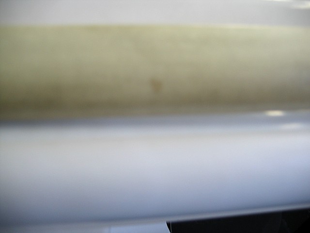

One more project checked off the list. I replaced the rub rail insert. The old one had lots of marks and had yellowed badly from the exhaust. Now, it's time to get ready for Christmas. Merry Christmas, everyone!

I have to due the same thing, I know the insert is easy to change out but what about the holder? Mine has some gouges in it and want to replace it to. Did you get the rub rail from Sonic, was it reasonable in price?

Since the rail itself is aluminum, I would just fill in the gouges and repaint. A 2-part putty like PC Metal would work well. It's easy to sand.
I can't remember the exact cost, but the insert was under $200 from Sonic.

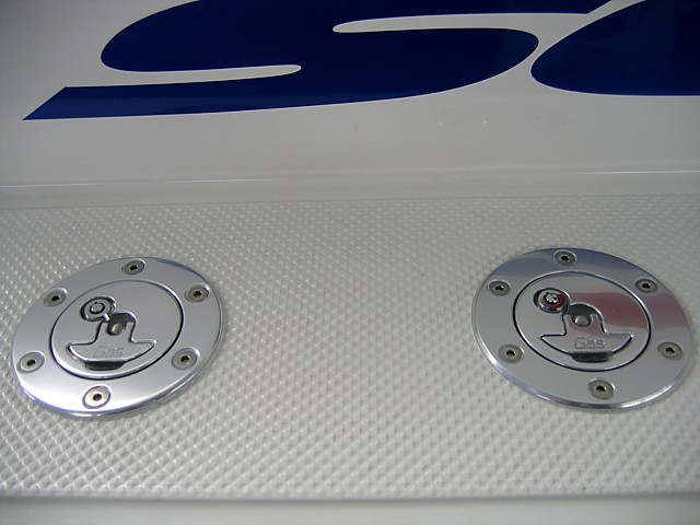

Another project done. I plan to slip the boat next summer, so I wanted locking gas fills. I bought these from Get Real Performance. Installation turned out to be a messy job since I had to enlarge the holes 1/4". The base on this gas fill is bigger, even though it's for the same size hose as the stock unit.

Fuel fills look great. I checked the web site but couldn't find them. Do they make them for the fresh water and waste also??
Thanks.
