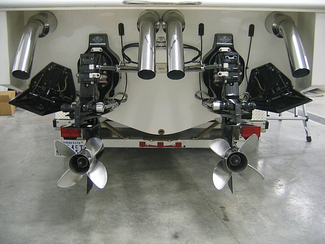

I'm getting there on my exhaust. I had two goals with the turn-downs. I wanted to meet the strict Minnesota 84dB limit and keep the transom clean. So, I had GGB build these custom turn downs that are bolted onto the end of the HPI mufflers. I knew I would have a tie-bar clearance issue in the trailer position, but it was far worse that I originally thought. Imco is building me custom saddle mounts for a lower tie-bar that will move the bar very close to the end of the drive. Then, it will clear on the outside of the pipes.
