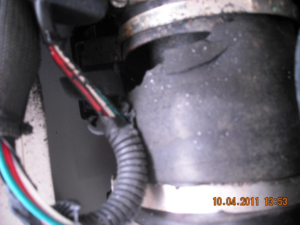

Old 05-29-2012 | 11:58 AM
Joined: Dec 2004
Posts: 484
From: Melbourne Beach, FL
Default Bad hose clamps
Attached are a couple of shots I took of my
riser problem last fall. The problem was
hose clamps that Mercury uses. One of them
corroded and popped of while I was running.
No alarm just a fire and smoke coming from
the engine compartment. All cooling water to
the riser went into the bilge so the riser quickly
over heated! I shut the engine down and the
fire stopped. What a mess. It took me four
hours to idle home on one engine. One thing
to Mercury's credit is that the closed cooling
system protected the engine from any damage.
Attached Thumbnails 496HO riser is blistered - Overheated?-dscn1598.jpg   496HO riser is blistered - Overheated?-dscn1600.jpg
