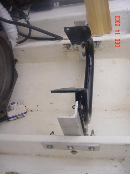

Default Engine Mount
I added this engine mount while doing more repairs the second year I owned my 24' Super.
Attached Thumbnails Winter upgrades: who's doing what?-engine-mount.jpg   Winter upgrades: who's doing what?-engine-mount-2.jpg

Yea, I did/had done gass repairs 4 out of 5 years I owned my 24' Super.
The second year I had repaired a stress crack that ran along the strake from the transome forward about 3ft. They added glass on the inside of the boat above the outer stringer and between the stringers but it didn't help. The crack came back so I would just seal it with gelcoat from time to time when it got bad.
I added the mount so that the stringers would be tied together and add strength. I cracked a stringer on my 20' Donzi Minx in much the same way a few years before and Ocean Performance added a similar engine mount when they fix that boat for me. My Velocity also has the same engine mount and it was rigged from the factory as a F1 race boat.
I asked John Coen about a hard engine mount and he told me the stringers were too close together so he had not done this to a 24 Super. OP figured it out for me though.

I agree the solid mount is the way to go. I lost a coupler due to the merc mounts coming loose.
I didn't have any other hull issues and it had 700+ hrs. when I sold it.
