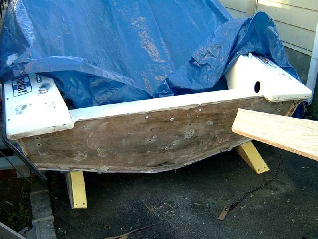

bad shape

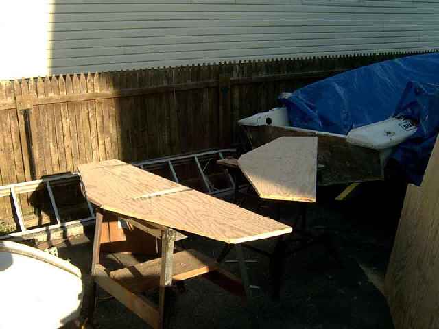

i redid the stringers, floor and transom

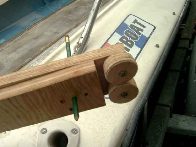

i made a tool to follow the contor of the hull to match the new stringers. i used marine ply 3/4.

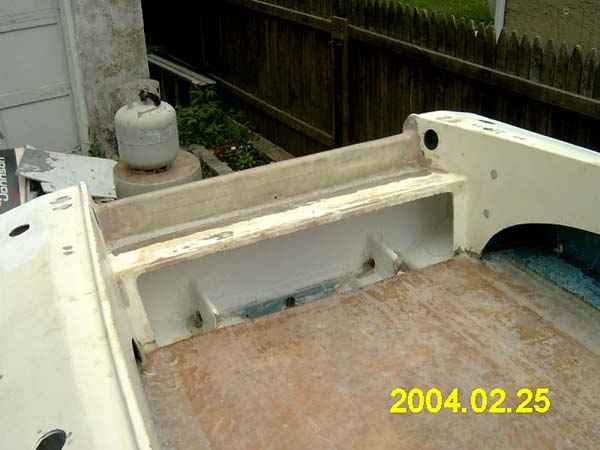

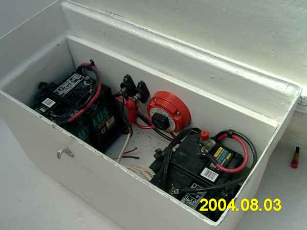

almost done, this was done in the summer of 2004, alot of solo man hourss. used interlux bright side to paint. not the best job but looks good from a distance
note: see studs for tank
also beefed up the stringers to the transom
i am currently have a 110 johnson with a 12" setback
