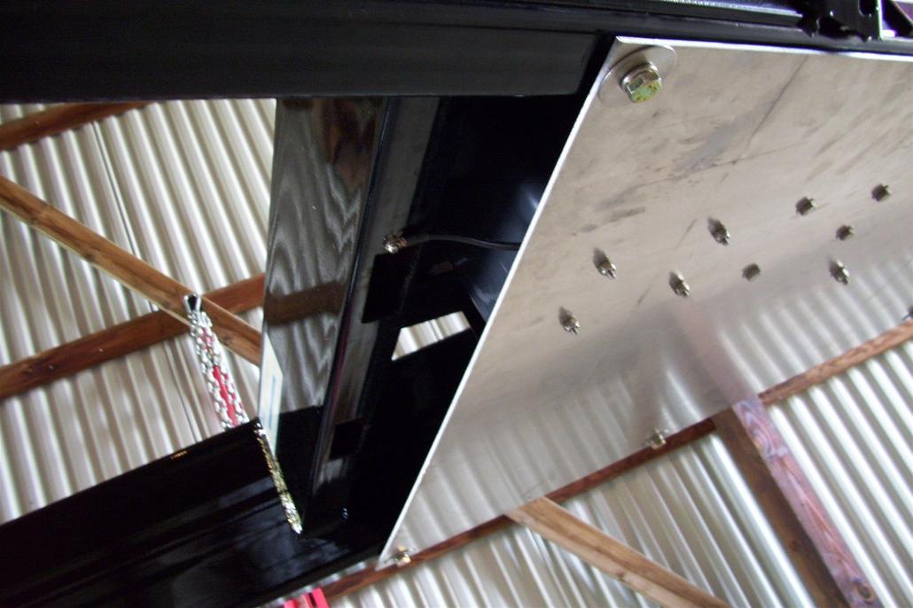

more progress...
after &*#@ing around with sheet metal screws and considering other ideas, none of which I was happy with...
I drilled and tapped 3/8-24 to secure the aluminum sheet to the frame. Also spaced it down with some more chit out of one of the magic boxes...more plastic spacers.
everything is thru-bolted
mounted the aux plug in for the lights...
Attached Thumbnails Eagle trailer redo-100_0170.jpg   Eagle trailer redo-100_0171.jpg   Eagle trailer redo-100_0181.jpg
