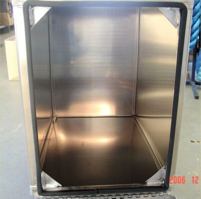

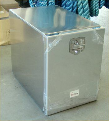

just bought two of these...
Peterbuilt new surplus Mirrex polished alum.
18"W x 23.5"H x 28.5"L
They will be mounted rear opening (lengthwise)
I've come up with a mounting program of Uni-Strut hung with hose covered sq. bend u-bolt over the frame...
the pics will tell the tale when I get them going on
many advantages to this mounting program
super-strong
lots of floor supprt
no holes in the trailer
spaced an inch or so away from the frame
I'll put some 3M clear on the frame from the door opening a foot or so back to protect from accidental paint damage removing stuff from the box
7 cu. ft. per box
14 cu. ft. total storage
I paid $180 per box for them.
+ reasonable shipping.

these boxes were a steal.
14 cu ft. for $430 shipped and they are quality.
lap welded, premium alloy, corner bracing, S/S hardware, neoprene door weatherstrip, spring loaded lock cover.
