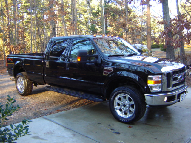

I am also going to put the discs on 1 axle this winter. My trailer is 10k tandem and has drums on 1axle. My boat is 28AT twin weighs about 7k wet including trailer.....what kit do you rec.?I have a great tow vehicle so I'm certain 1 axle will do, especially since I want the Kodiak set....currently I have none so it will be a nice change. My truck is 08' F350....
Attached Thumbnails Trailer Disc Brake Conversion ?-dsc02094.jpg   Trailer Disc Brake Conversion ?-dsc02096.jpg
