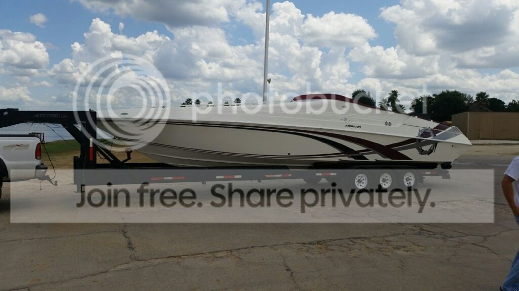

I just bought a 38 fountain Sc on a gooseneck Magnum trailer and it rides seriously worse than my 38 Excalibur on a bumper pull setup....my question is, could my Biggass truck be the problem? Have a 2000 7.3 F350 with a 6" lift on 37's, could it be causing the trailer to not ride correctly, putting too much load on the truck and not spreading if out equally on the axels?

Post a picture of it hooked up, I would think most gooseneck trailers are not meant to be hooked up to lifted trucks.
Does it sit level?

You definitely need to get the trailer level. It looks like you have a fair bit of room to do so without worrying about contact. Worst case, when cresting steep ramps, you might need to drop the tailgate. Going to a notched-gooseneck tailgate might be the ticket as well.
If you are considering wheels/tires for the trailer, you would want to do that before you do any modifying on the trailer. You might be able to get an inch or two of height on the trailer by going to bigger wheels/tires.

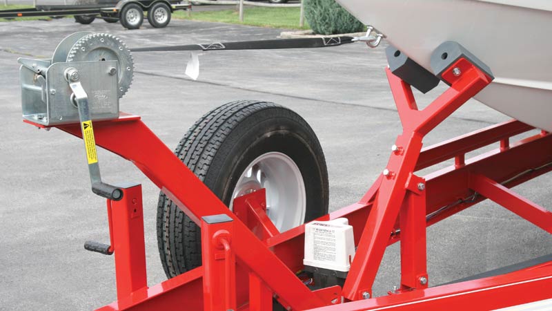

Last, looking at the front of the trailer, I feel as though the boat should be resting on the bow stop. Is the boat bucking on the trailer at all, or is it rock solid? It looks like you have a couple straps going forward, but nothing up and down. I think you would have a much better trailer setup if you had the V-block setup like Myco, Manning, or Loadmaster, and the boat was securely planted on the bow stop. (Ditch that roller.)
http://www.offshoreonly.com/forums/g...p-trailer.html
http://www.loadmastertrailerco.com/options2/#bowstop
