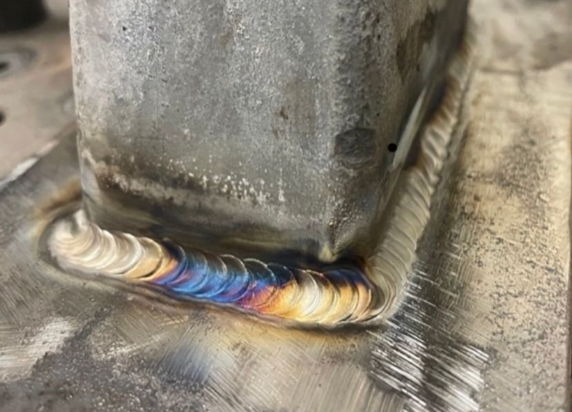

Welding isn’t necessarily destructive lol.
Hoodoo,
Oh, I get that. That’s why the "quotations". I have a REALLY good welder on call if that’s the way I would go. I just don’t want to have to do any painting afterwards if I don’t have to. The paint codes are long lost to history, and I’ll never get it to match. I’d much rather go a more "bolt-on" route, if at all possible, which it seems there is. Although, I'm more inclined to immobilize the coupler I’ve got rather than bolt something over the existing one. I’m chewing on it.
