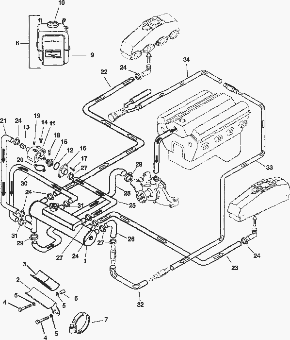

Attached Thumbnails Prop Selection-454-hoses.png   Prop Selection-350-hoses.png
DKerns is offline

This is a pic of the bypass coming up from the recir pump.. although this is not my setup, my engine came with the connector on top of the recir pump, and when i enquired about it, i was told to drill the intake manifold for the bypass hose..
thanks again for the comments.
qaberdeen is offline

Dkerns,
am i going to use #24 in your pics for my applicaion. it's the cooler power/steering oil cooler..
thanks
