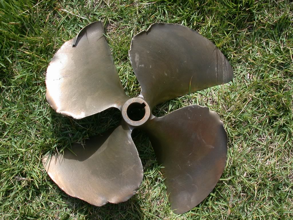

I do all my own labbing, if you want send it to me and I'll fix you up. The photo is some of my work.

VV, thats a nice looking prop, looks abit dull though..lol

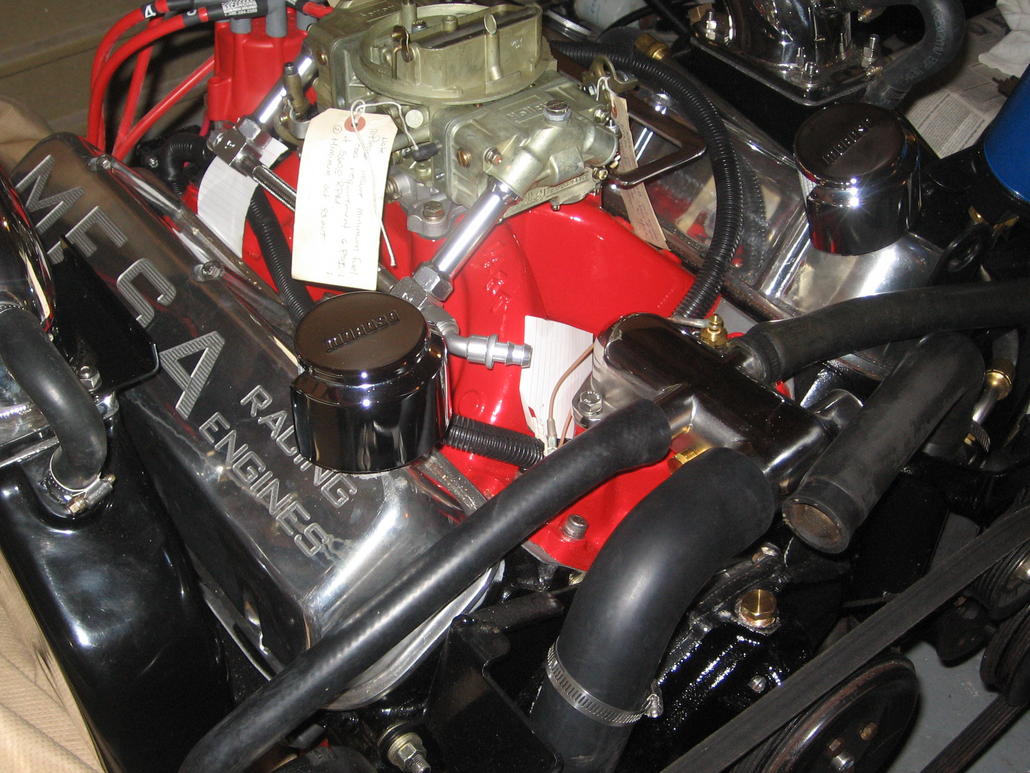

Hey fellas,
which gasket am i using with the thermostat assembly the left or right. also the sender assembly temp is not fitting what should i do. the base of it is to wide.

qaberdeen, I used the flat gasket on the right.
if the therm housing is up side down, insert o-ring/flat gasket, thermostat, plastic spacer, therm housing gasket, in that order. If you are putting a sending unit in the housing, you will need to have the housing gasket with the continuity rivets for it to work properly!
