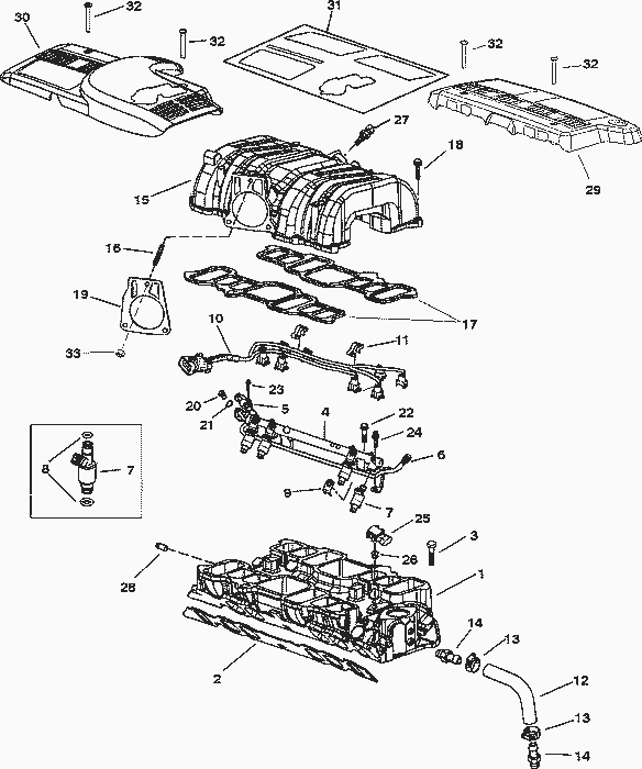

here's another pic of the bypass hose. this is a 7.4 MPI

Originally Posted by DKerns
Revelocity, I am not doubting you, but what "bypass" is required?? I ordered all new hoses for my boat when I put it together and there were no bypass hoses. I also put a motor in a 98 boat recently that had the same therm housing O.E. and didn't have any bypass hoses and didn't have a hole in the thermostat.
Looking at the newer 454's like qaberdeen had in his boat, they don't show any bypass hoses either?? Looking for positive info so I know what I need/should do!! I also don't want to mislead qaberdeen!!
D,
What you're doing is bypassing the closed thermostat which Mercury accomplishes in two manners that I know of. Either a one piece thermostat housing and a by pass hose between the water pump and intake (like the 7.4 MPI diagram) or a 2 piece thermostat housing which does need the extra hose as the t-stat is not mounted flush on the intake but on top of the main t-stat housing therby letting water circulate. This was the arrangement on a 350 Mag/4 barrel 270 HP (Design 1 cooling). I have seen some 2 barrel 5.0L/5.7L arrangements without a bypass but I guess Merc feels this is fine for 200 - 230 HP.

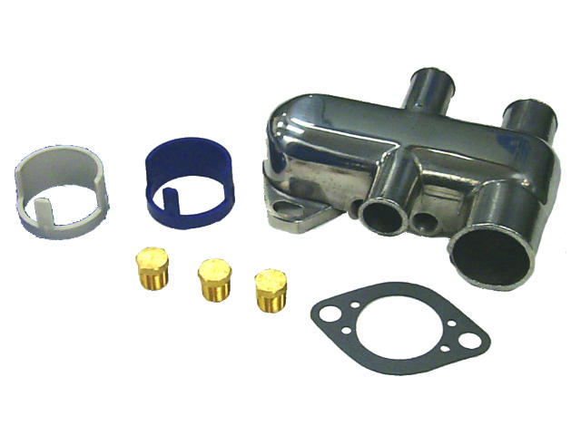

The engine builder just got back to me and stated this.. (" You have constant flowing water to your exhaust system at all times specially when using a thermostat. If your thermostat blocks the flow of water and does not bypass for the exhaust cooling you need to drill the manifold and bring water above the thermostat. If the housing has water to the exhaust with no restriction you need do nothing to the manifold. The bottom line is the cooling system needs water at all times, you cant have the thermostat block water off when the engine is cold")
so in other words it sounds like i don't have to drill using the Stainless Steel T Housing in the picture because it does not block the water..am i on the right track..just wanting to make sure..

qaberdeen, I was under the impression that the plastic inserts were to let the water bypass while the therm. is closed!! The therm. installs up inside the housing with the plastic insert between it and the intake...... Again, don't hold me to that!!
That being said, I have had mine on my motor(s) for 2 seasons now without any overheat issues and I don't have it bypassed!! (325hp on the first motor, 600 hp on the one that's in it now!!)

I agree that you'll be fine since the responsible thing is simply to warm the engine up first before burring the throttle!.
