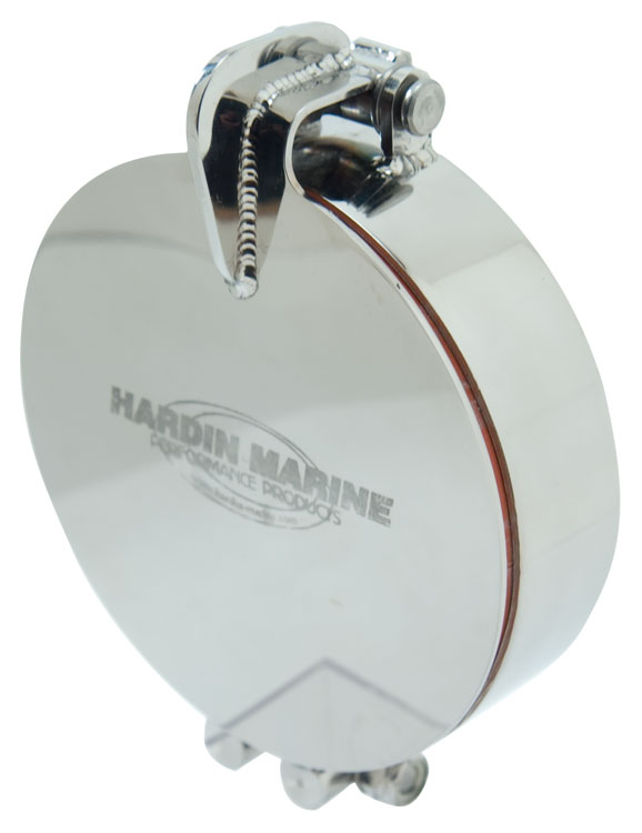

All tightened down, sealed up and ready to test fire, just waiting for a warmer day....................
I hate these toilet seat flappers with a passion, "BUT" my options are slim right now so they go back on for the time being:
90profx is offline

Cpperformance has some nice looking stainless flappers...
