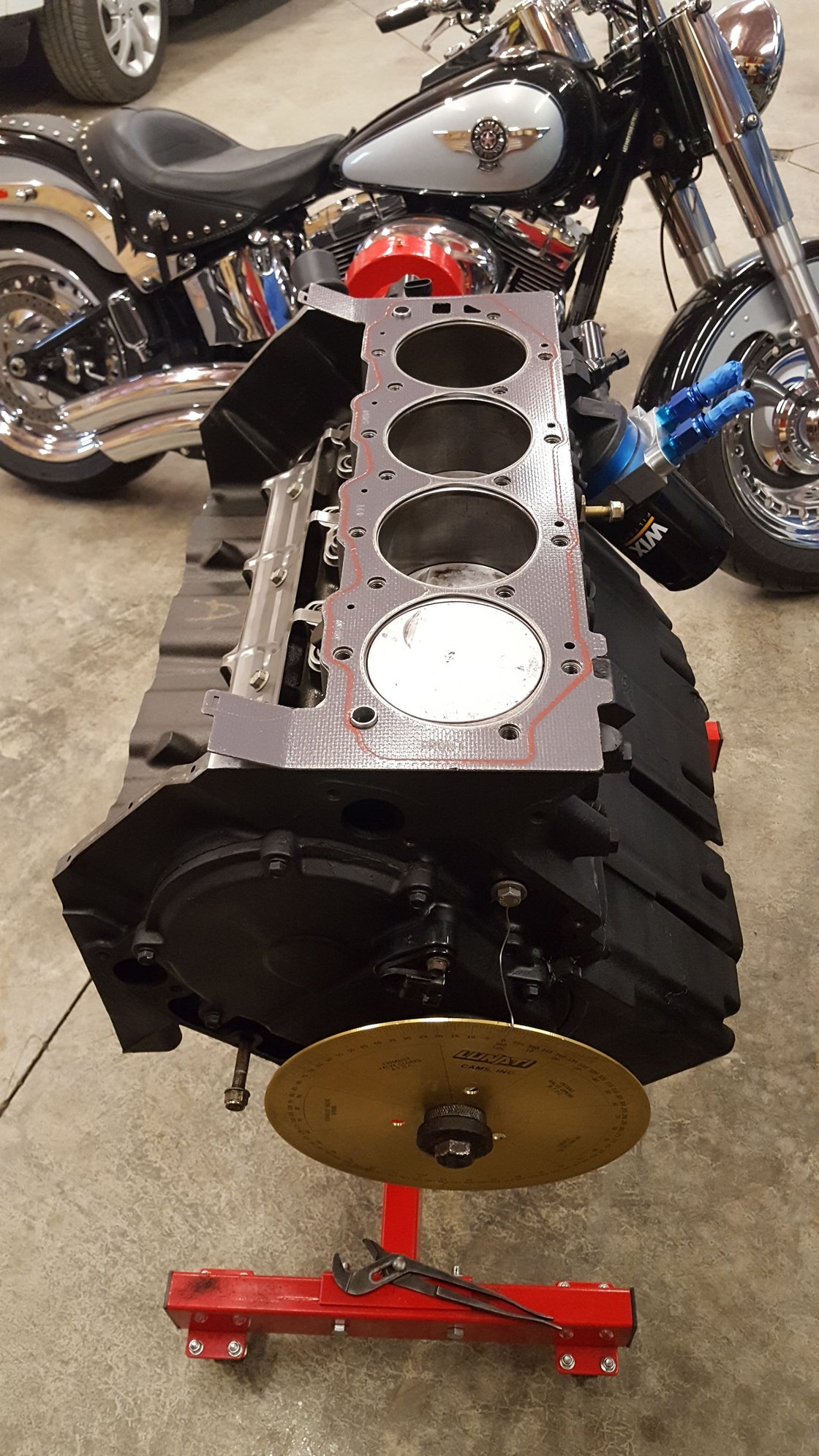

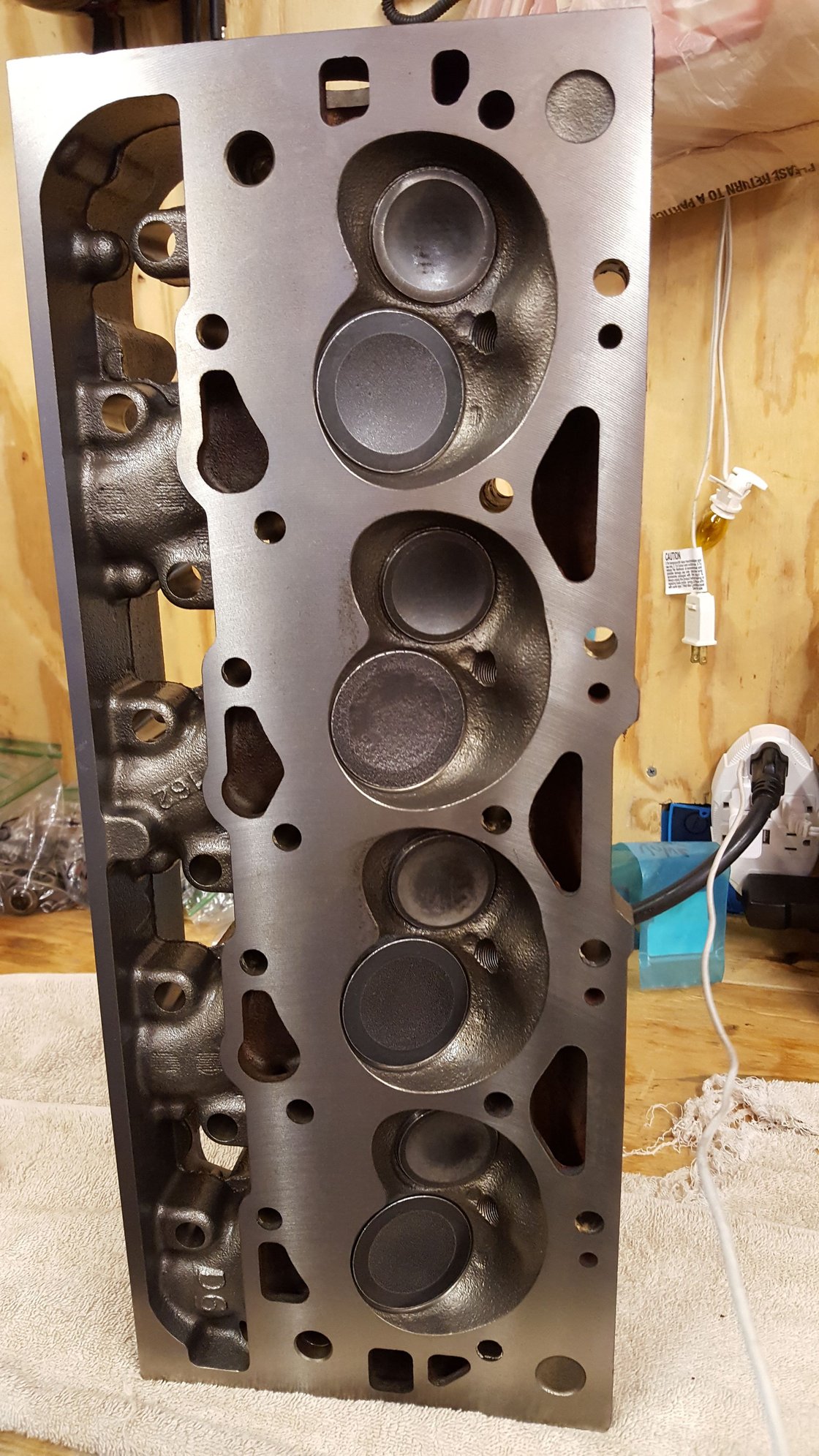

Update. Heads are back and installed. New GM Stellite exh valves. Comp 911 spring kit. Heads milled .006". 1.865" IH 140lbs seat psi. Checked PTV clearance. .180" intake w/203 cam. Exhaust is way over .400". Installed with Felpro marine permatorque gaskets. 4.330, .060" compressed.

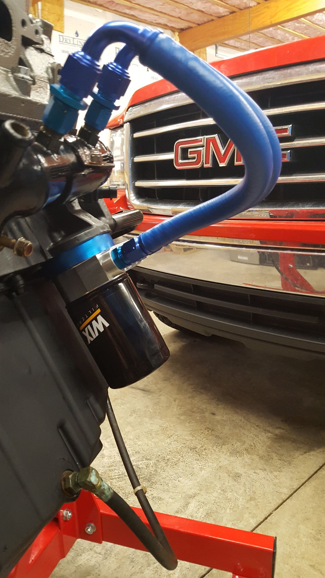

Installed Earls 504 oil sandwhich thermostat adapter. Tstat behind to open at 160* and is fully open at 180*. -10 lines. Installed GM 30lb bypass valve. Really cleans up.the oil system.
