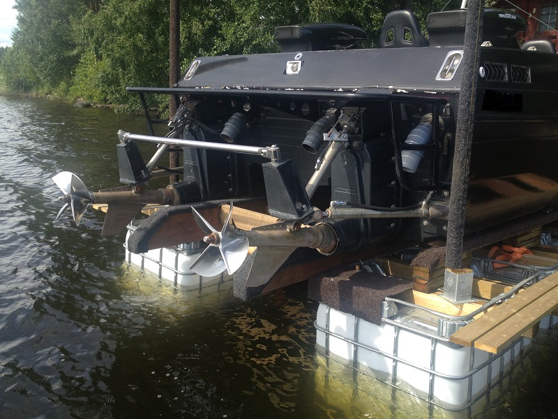

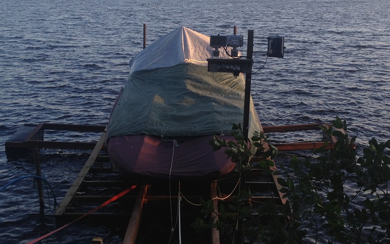

Default DIY Boat maintenance lift
Now its easy to make checks and clean up without taking boat out of water

Old 07-16-2013 | 06:21 AM
Joined: Aug 2005
Posts: 178
Now thats one cool dock
Man, wish i had one of those,,
Details and more pics on the dock would be nice to see.
How does it go in/out ??
STV92 is offline
Old 07-16-2013 | 08:45 AM
Joined: Aug 2010
Posts: 197
Its working,
Standing rods are the gate, direct driving on it.
Quite simple sturcture. It based two laminated structural timber 40ft long.
It works with air, air out its go down and can drive on it.
Air in to those IBC containers and it goes up.
Attached Thumbnails Chris Cat Projects-kn1.jpg   Chris Cat Projects-kn2.jpg   Chris Cat Projects-kn3.jpg

Old 07-16-2013 | 06:11 PM
Joined: Aug 2005
Posts: 178
When you take the air out, they fill with water
Take the water out, she comes back up? )
How does it work if big wave go bye??
Thats a cool idea, even like the spot lights
