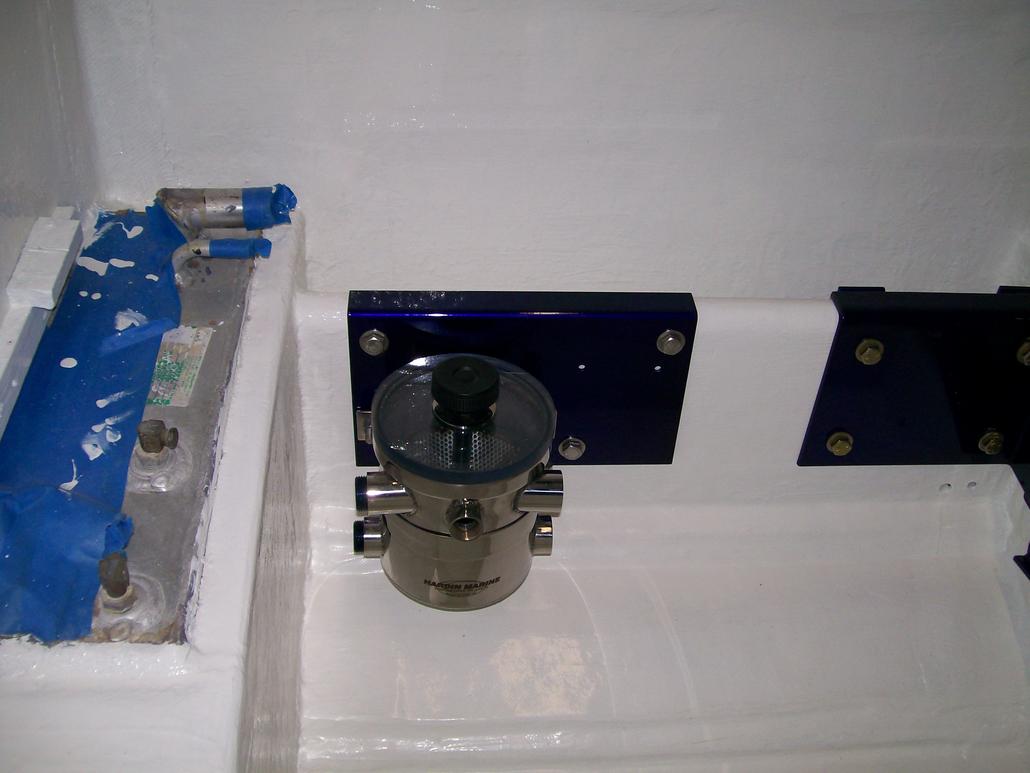

WOW 205 gallon tanks!!! Betcha with full tanks that added some weight. 66 gallon tank will put you right in the ballpark with the AO and Awesome's. Here is the rear location of my tank. Rear portion of the tank is about 8-10 inches within the engine compartment beyond the rear bulkhead.
