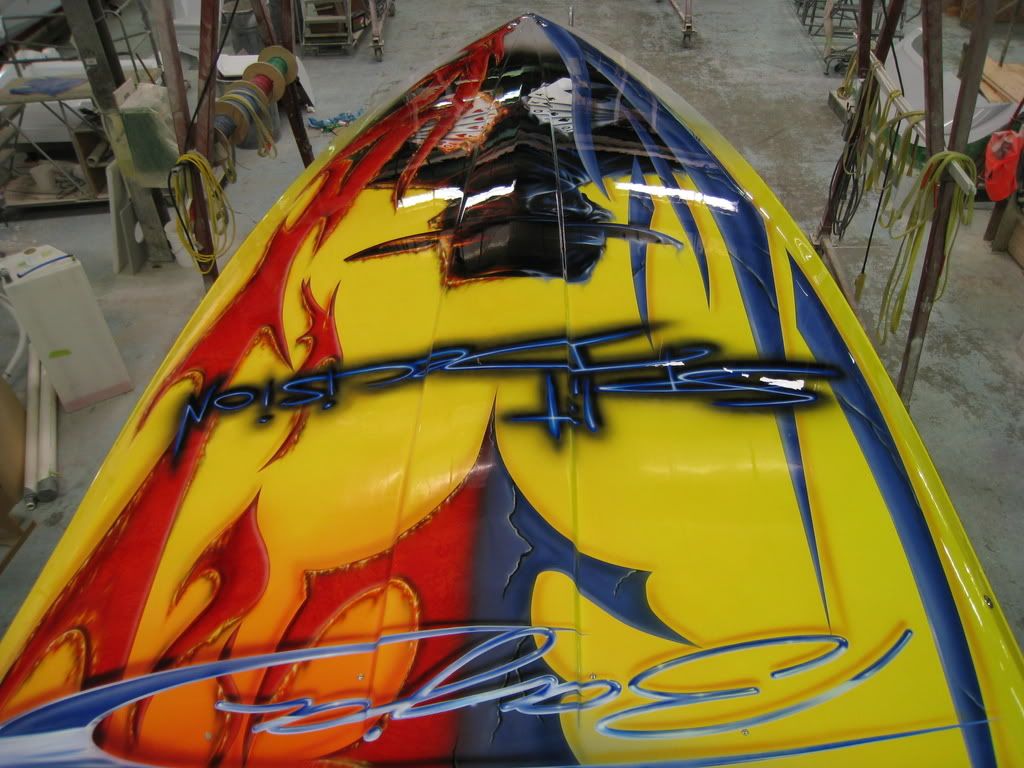

Ok so i got the new LED pop up light and it looks like a nice, but I do not think it will fit just right in the bow light area, and may over hand a little onto the treaded area on the bow...
the people who have put these in, what you think?

We put a pop up LED nav light on Split Decision last year. Your right, they do not fit in the existing tooling relief. We had our glass guy grind out and reinforce the area to fit the larger foot print. I do not think there is any way around doing this. Good luck.
Once they are installed, they do look very nice. They make for a very clean looking deck. Unfortunately, I do not have a close up.
