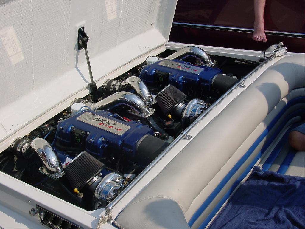

I see alot of 28 Cigs with twin 350's is that because the bilge is so small its hard to get big blocks in there.
They made them both ways.....but the ones with BBC have about a 6" lip infront of the hatch cover from where they moved the firewall/backseat forward to fit the BBC engines....
The pic below shows a 28ss with BBC's in it....but the reason you dont see the lip is that the owner has standoff box's on it and the trannies are inside of it. The boat would have originally come with SBC's from the factory

Man, those babies are humping each other!! Sweet boat!! Whats the top speed?

That boat i was told by the former owner (RonS here on the board) was in the low 90's!!!

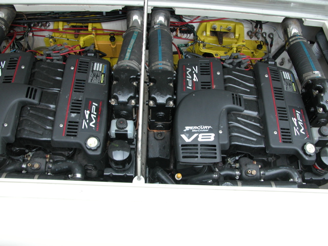

I think the reason the made the lip was to accommodate the Borg warner transmission when the merctrans was discontinued. heres mine 454mpi's with merctrans. no lip behind seat. I have to assemble all of the pulleys and and heat exchangers after engines are in the boat.

Was your 28 a factory big block boat or were they installed afterword? My 86 has the 6" lip on it and it was a factory big block boat. I think it is a poor design. It makes it very tough to get to the front of the engines, the belts, and water pumps. They could have put it at the back of the hatch and it would have been a whole lot easier to work on.
